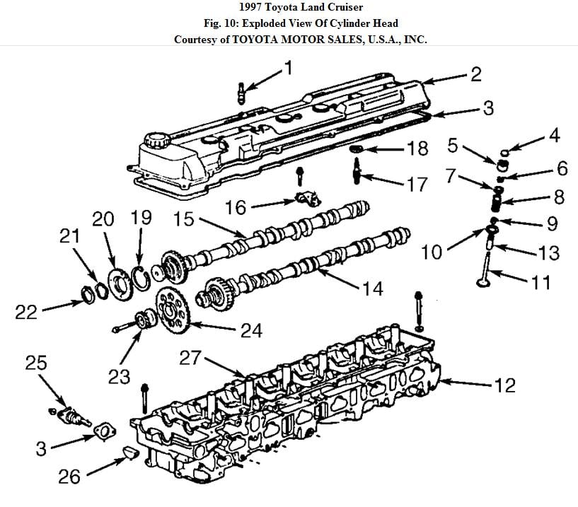

Update on mine:
I had my mechanic pull the valve cover and pull the cam with the spring loaded cam gears and re-tension the cam gear spring (on the exhaust side). He said it was properly tensioned before but did it again and it hasn't been an issue. Granted it hasn't been as hot and it still feels like my engine is down on power...but its better. According to him, they had trouble with timing on another 1fzfe where they couldn't get the timing right and they went in there and discovered that whoever was in there before hadn't torqued things down right and the exhaust cam kept going out of time. They kept playing with the dizzy to get the timing right and it would keep going out. Something to consider. Has the head been off your rig yet?

Not sure it would be off as much as you think. One tooth could probably be 10-17 degrees off either before or after depending which way it is turned. I would for sure check it. Also did you reset the ecu? Since the o2 gives info for the mixture get rid of the old info.
