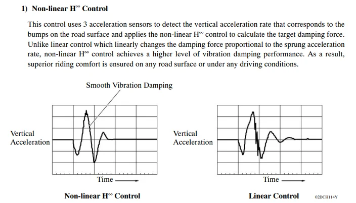

This discussion would be remiss to not mention valving progression. My guess would be that the AHC is linear while the Kings on the Raptor are probably on the progressive scale allowing those big flows over moderate hits. That seems to correspond with the description above of poor behavior in-town or when towing.
I could probably search for it, but can anyone confirm the shape of the AHC damping curve? And I'm probably in error on this, but does the AHC setting just offset the curve up and down the scale or does it change the shape of the damping curve as it moves from soft to firm? We Land Cruiser pilots are luddites with things AHC.

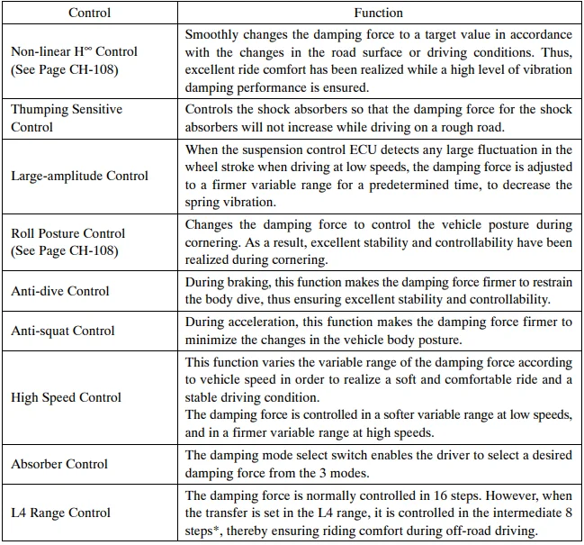

AHC damping curve is algorithm based. That is to say it's neither progressive nor linear, as it has many software maps (for control of the various functions in the table above) for strategies to best control suspension and body motions for use at hand.

The system definitely isn’t a sliding scale. In fact.. driving in a strait line the damping is almost the same between Comfort and Normal, and a little “stiffer” in sport, but during dynamic maneuvers the damping varies more greatly depending on mode.

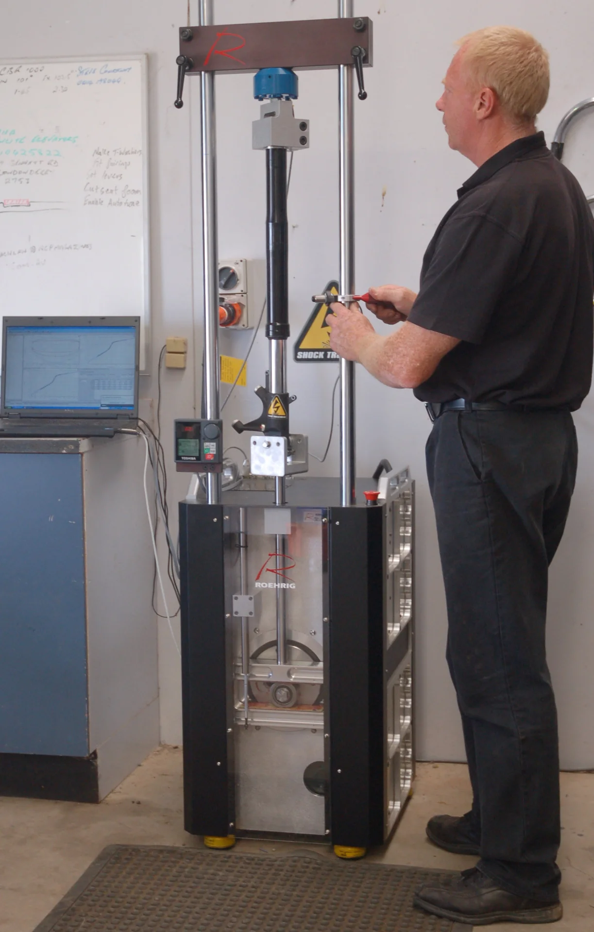

3) If you take the dampers/shock off your vehicle you can have them "dyno" tested. Basically they run through a bunch of cycles of varying speed, frequency and power to produce a plot of your dampers performance ...this is probably only useful if you have a large database of similar vehicles operating on similar terrain to which you can compare your settings.
