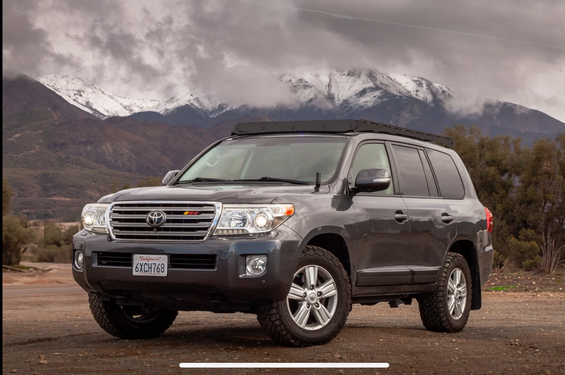

It's time to take some small steps with my LC 200. The goal is to make it a bit more capable off-road by adding some clearance, without sacrificing much when it comes to driving comfort and handling. How does this plan look to you?
Is the Wescott kit necessary to get the clearance I need for that tire size? I'm okay with some mild trimming and pull of the fender liner, but I don't want to do a CMC and dont want to replace the UCAs at this time. I've only built out a Tacoma and Tundra, so this is a whole new world to me. haha

Btw what's the deal with the color accent behind your grille? I need one of those.
It's a grille badge from Runnin4Tacos. I've had it on all my builds over the years. It follows me. Haha
