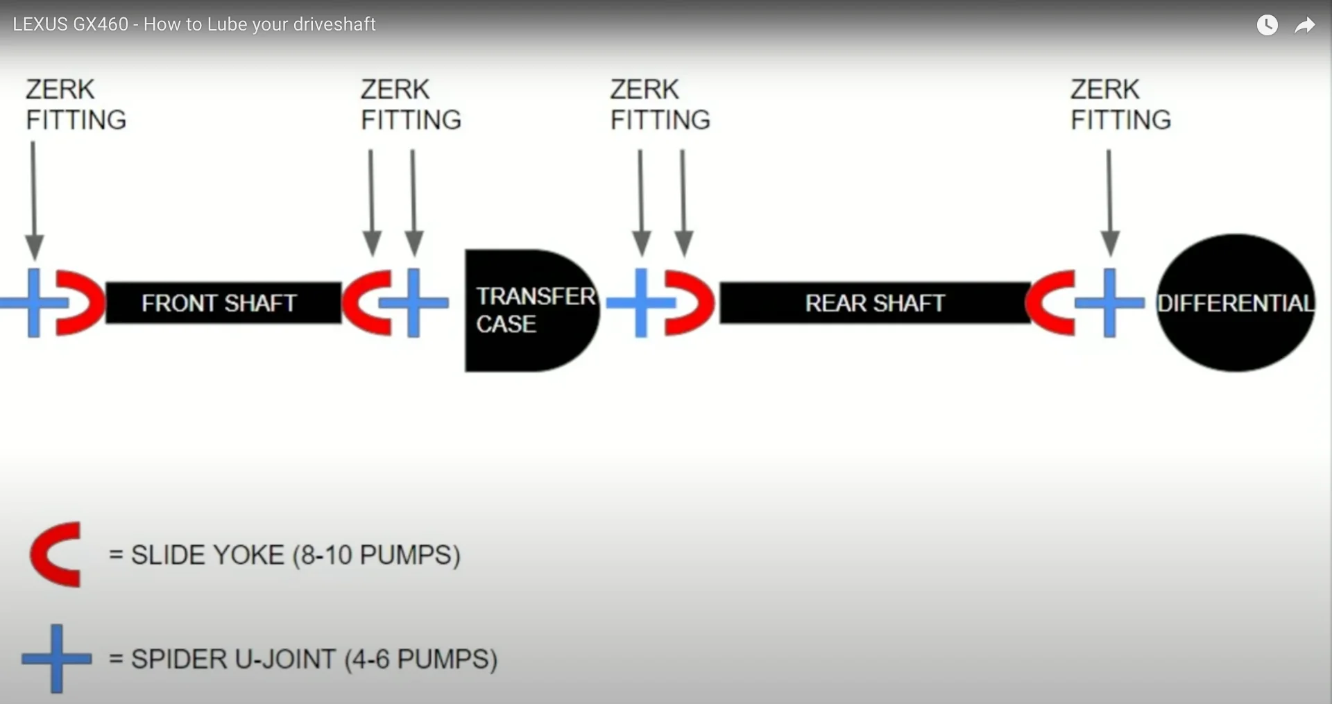

As for the other zerk, I found this Youtube and he showed this diagram. So, I think I only did the rear drive shaft and still need to do the front shaft. What I may have to do is removed all the covering to see it.
the photo shows 4 u joints which is correct for what we have on our cars but there are only 2 slide yokes. one on each driveshaft.
You will probably not see any grease come out of the slide yokes but as you pump more and more grease into the slide yoke it will try and push the slide yoke joint apart. When you drive the slide yoke needs to be able to compress and pull apart slightly with the movement between the axle and transfer case. When you pump too much grease into the slide yoke it prevents it from compressing. If you pumped the slide yoke with so much grease that its started to force the joint apart them you also run the risk of messing up bearings in the transfer case and diff because now they are being loaded differently since the driveshaft is now pressing into the transfer case.
