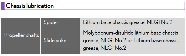

Do not use moly grease in the u-joints, it is bad for the needle bearings in them. Regular NLGI#2 lithium based grease will work great as long as it’s used often enough.

Factory manual specifies that you can use the regular lithium grease on both spider and yoke. So I, and many others here from which I learned, keep it simple and do that using Lucas X-Tra heavy duty grease.

NLGI #2 is a very wide spec. Moly, lithium, and flavors in between are all very similar. Wheel bearings are separate as they see some real heat - and there's a high temp grease for them. Green (marine rated) lubricates very similarly but doesn't have some chemicals that powers-that-be want to keep out of water.
Moly grease will not damage a joint...
Moly content can vary a lot depending on the product. Since a high moly grease can pose problems, and regular lithium definitely won’t, it’s easier to just stick to what Toyota recommends in the manual.
It’s unlikely that type of moly is what would be used by someone that doesn’t know what they are doing.. but possible.

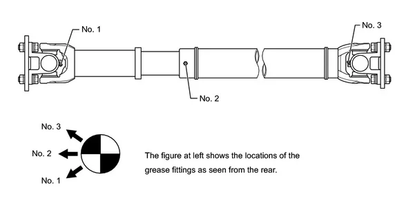

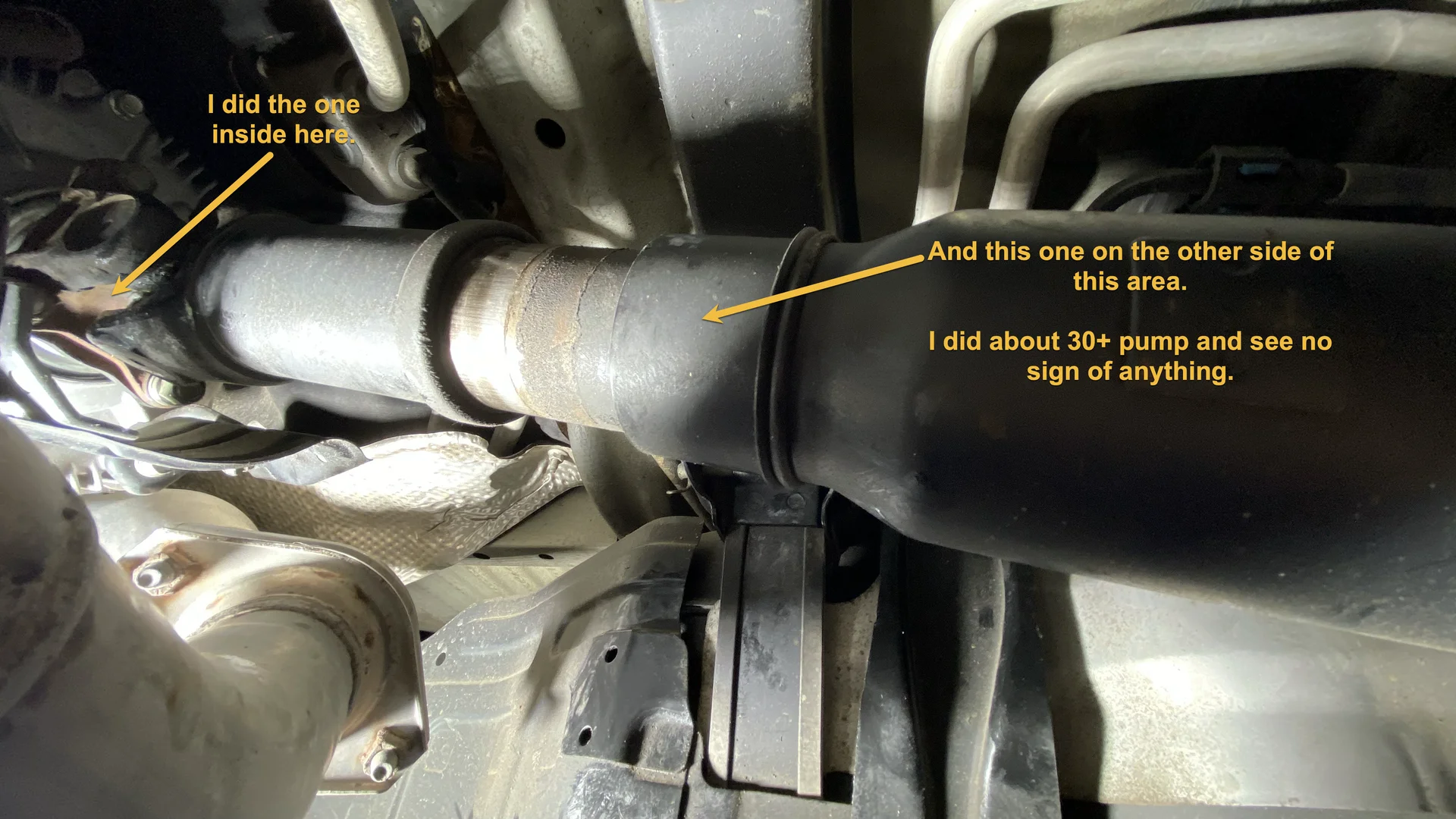

Okay, I finally had the time to grease the shaft. For some reason I only found three instead of four. At the rear, I only found one.
This is what mine looks like...not sure if it's correct. The zerk No. 2 is the one that I pumped like 30 plus but see nothing moved or no grease anywhere.
No more grease in no. 2.
And I’d advise getting help with the rest.
if you did 30+ pumps of grease into the No.2 zerk then thats probably not good... as in you overfilled it.
Agreed. I'd unscrew that zerk and put the suspension in low/kneel mode to push out the excess, then reinstall zerk, but be sure not to over tighten it.
My advice to get help is based on not being able to find the other zerks which are definitely there. Even reinstalling that no. 2 zerk is risky for someone with very little mechanical experience.
