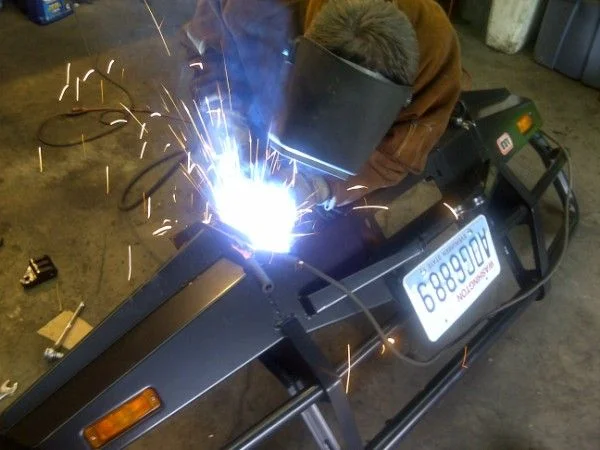

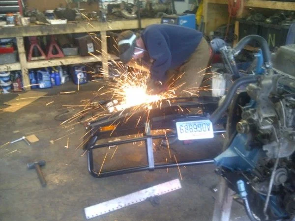

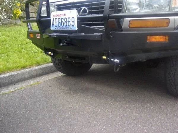

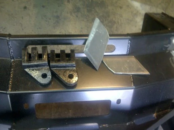

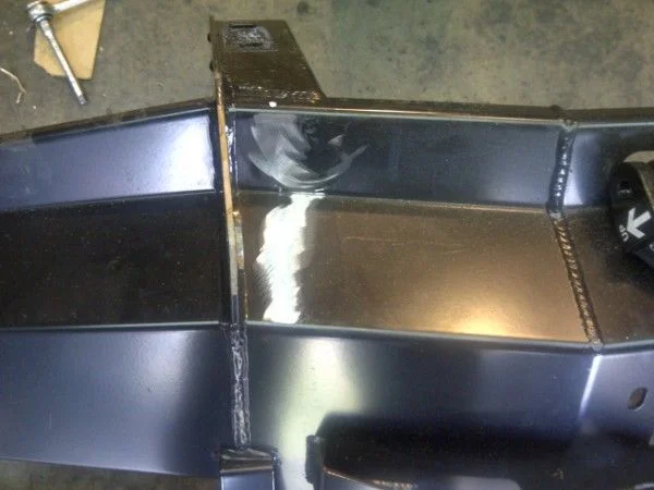

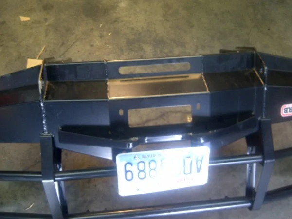

Posting a little update. Patriot arrived so breaks are a go for the toad. One of the last steps was to figure out a mounting bracket. I cut some angle iron and some tabs, and my friend Tor of Toyota Off-Road Fabrication | Home said he would weld it up for me. I drove over there and he looked at it and determined that the ARB tab was an ideal location. I scrapped my idea as wheeling (which I plan on doing with the fam) would break or wreck the fabbed mounting plate.

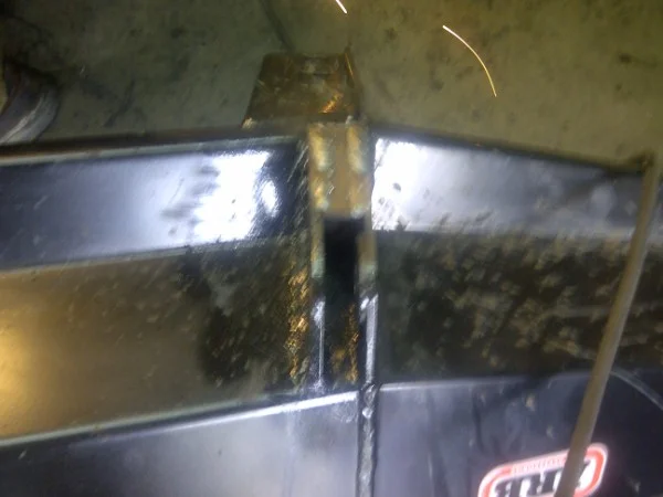

Tor found an old piece of 1/4" square tube and using his grider cut two plates to go along side the recovery points already integrated into the fram through the ARB.

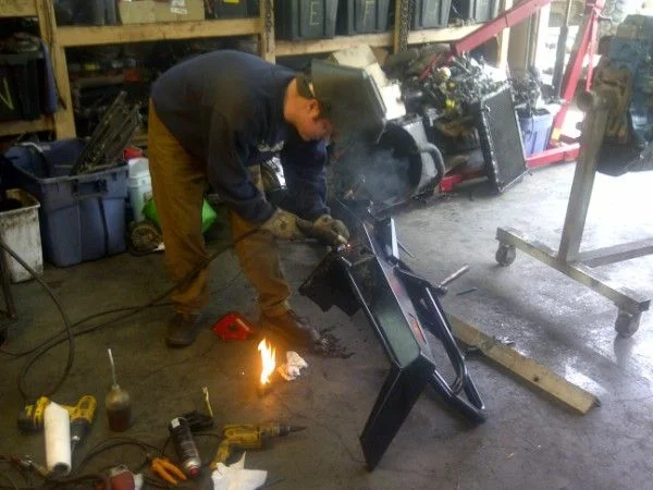

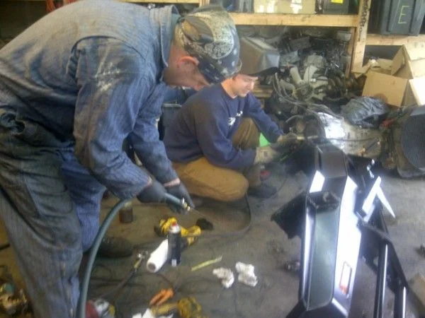

He welded them on and drilled a few holes and done.
Rochford was there to put out any fires. Safety first right?
Rochford to the rescue. The TORnado has no time to stop to put out minor fires.

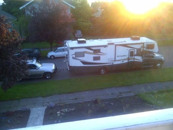

my wife took a video of us pulling out of the driveway after hooking it up for the first time.....
