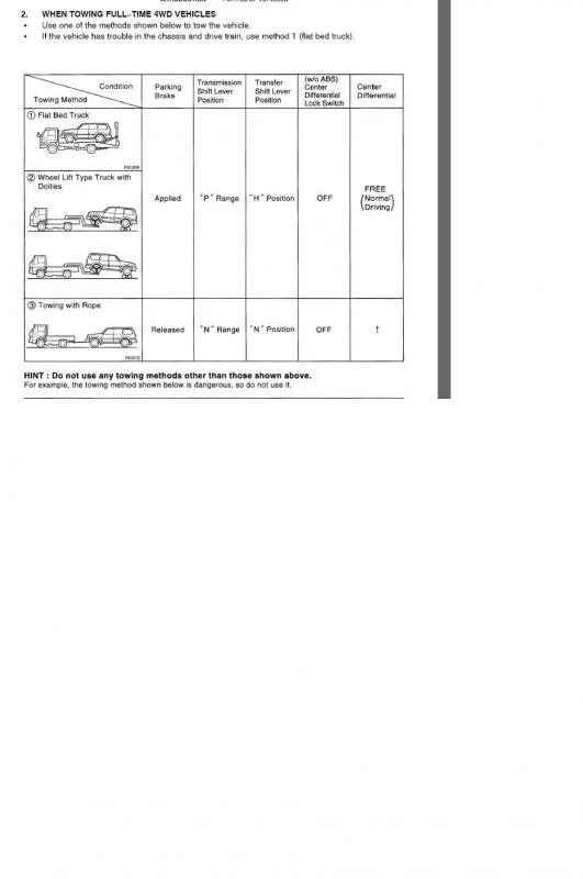

Starting off, I am writing this to possibly help others who decide that they want to flat tow their 80 series. I want to be upfront and say I have not flat towed the 80 yet (except for around the block) and I don't know if flat towing is gonna wreck the tranny, transfer or anything else on the rig. However I have spoken to a few people on here via pm and tele about their setups and how they do it. Everything says you should NOT flat tow (4wheels down) an 80. The owners manual says it, toyota service people say it, many on this forum say it. So.... this is only written from a Guinea pig perspective.

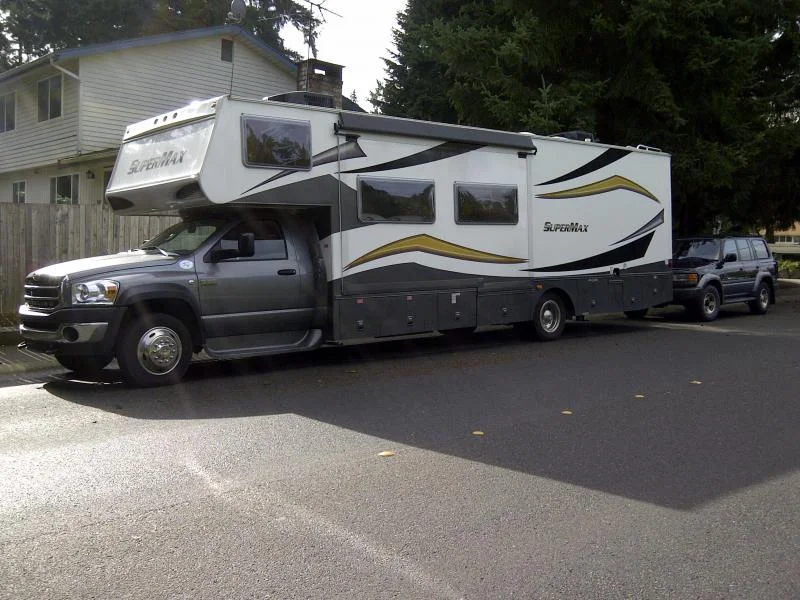

You will also need to research if this is the right thing for you. I chose flat towing because a 37' RV + a 20' Cruiser + about 4' of towbar put me at the 61' length. Call around to Koa's and rv parks... you won't be able to stay in many unless you disconnect the Cruiser. Now if you are Trailering your 80... then add another 8'+ and do you really want to disconnect the trailer/cruiser combo just to stay the night? Dolly... out of the question.

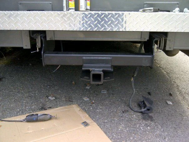

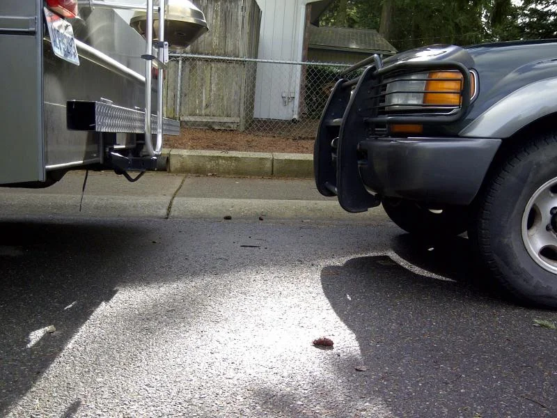

The 80 I have in the below pictures was one I was looking at buying. I wanted to make sure that it was going to mock up right. It was close, but not where I wanted it.
So why didn't I like the last picture... well because
1. I wanted the hitch to line up with the bottom of the ARB... where the recovery hooks are.
2. Because my pipe drags when I go over a bump and I wanted something more stout to save my pipe
3. Because the hitch was only 5k lbs.
I picked up a 15,000lb hitch and replaced it and now you can see why I like it so much more.

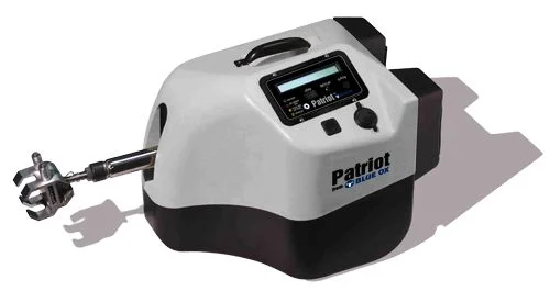

So I ordered up a Patriot Wireless Braking system for the cruiser.
More info here: Blue Ox Patriot Braking System
It comes with the safety release mechanism which applies the breaks if for some reason your towbar, safety straps and hitch (because thats what it would have to take for this scenereo to happen) all come off and your truck is driving on its own.
Its a good deal, takes about 1 hour to hook up and can be used in any vehicle. You will pay the same price for a brake system hard wired in your vehicle. Some people like hardwire because they don't like taking the box in and out every time they want to drive their car.... but 10 minutes isn't much time... I want to slow down a bit after all.
