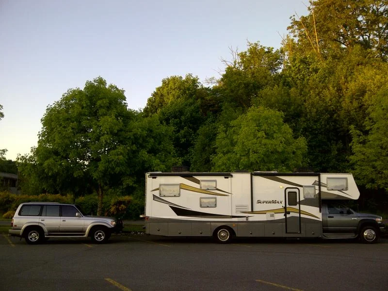

Towed the cruiser over some serious mountains. Seattle to Walla Walla washington where we are enjoying the company of some old friends. See picture.
It towed like a dream, but I don't have the lights hooked up yet... and we averaged about 65mph with this 3 ton brick in tow.... Cummins makes a bad ass engine.

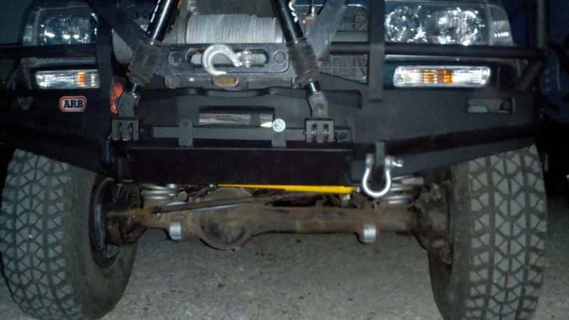

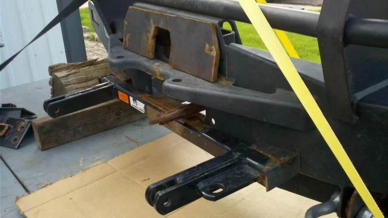

Can I see your blue ox tow point on the cruise?? Is it a bar or just the brackets welded to the bumper? I think I am over killing my set up.

Is it just the photo or are the pins in your bumper loos?
I'll take some more pictures for you when I mock up the wire loom. The post there is just the bumper. We added 1 plate to make 2 tabs at the bumper. The towbar has 3 tabs... it runs 3-2 with a pin between them. Give me a few days as I'm traveling tomorrow and will continue the build when I get to either Idaho or Nebraska. If you are on the way, I can stop and let you take a look.

Nice this is what is so cool about IH8MUD every one is willing to help each other.this is my blue ox set up.What do you think?And are you just putting you cruiser transfer case in -N- and leaving the trany in -P-?Or are you puling the drive shafts? sounds like you are doing the first option.

Your 2nd picture bottom right where the D-ring is. Looks like how I've done it. What you have will definitely work.
