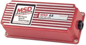

MSD huh? Manny what year are you running? On a 2F? any mods needed? I am always having to use my choke (even in warm weather). This unit keeps a constant charge to the plugs right?
you can run an MSD w/points, but I would recommend going Electronic Ign.
To be honest, I don't know what made the biggest difference HEI or the MSD box?
Anyone running HEI w/o MSD, and visa-versa?
I installed both onto my 1F at once and never looked back :D
checkout ebay, you can pickup a 6a for under $100.
