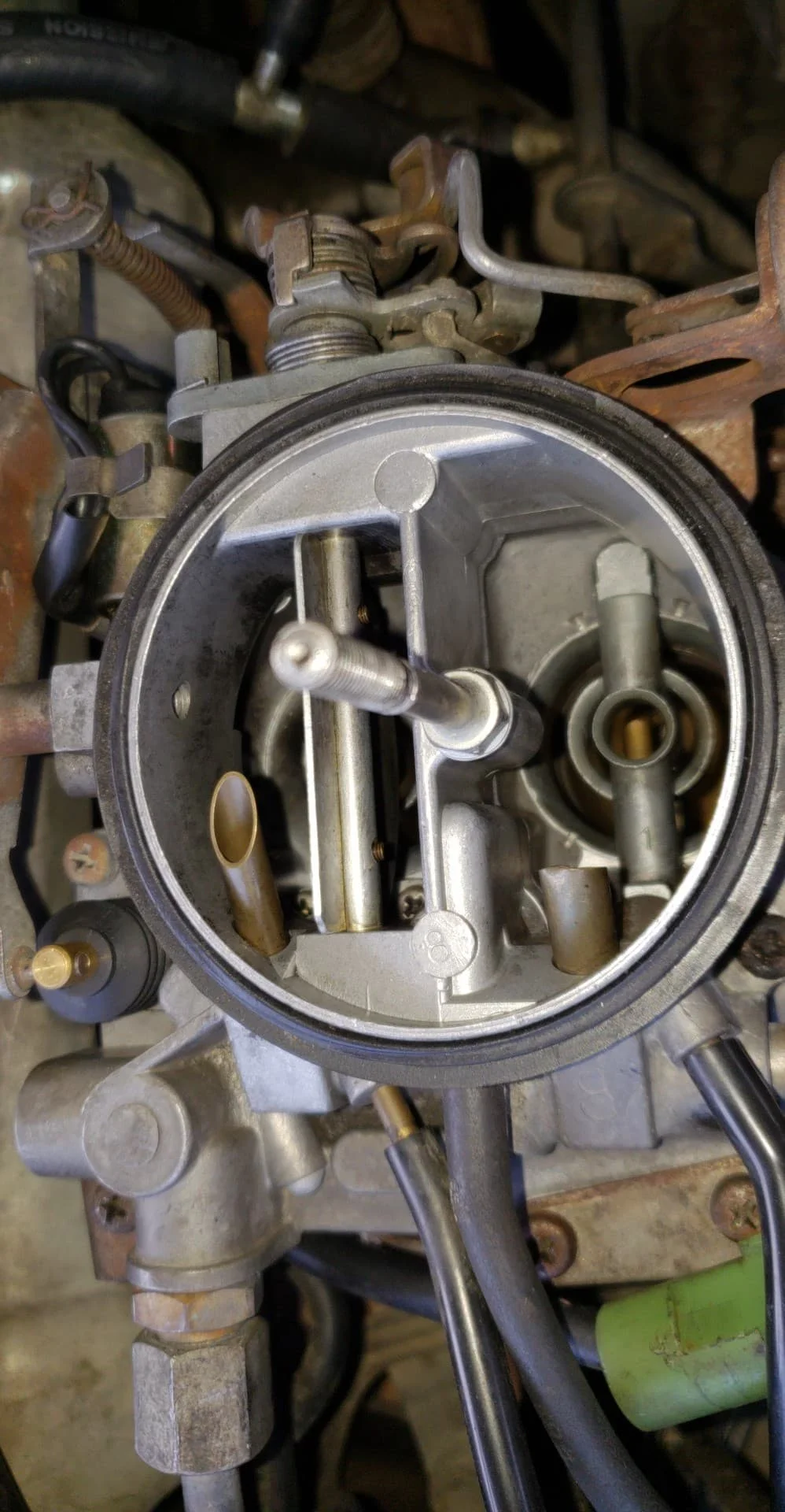

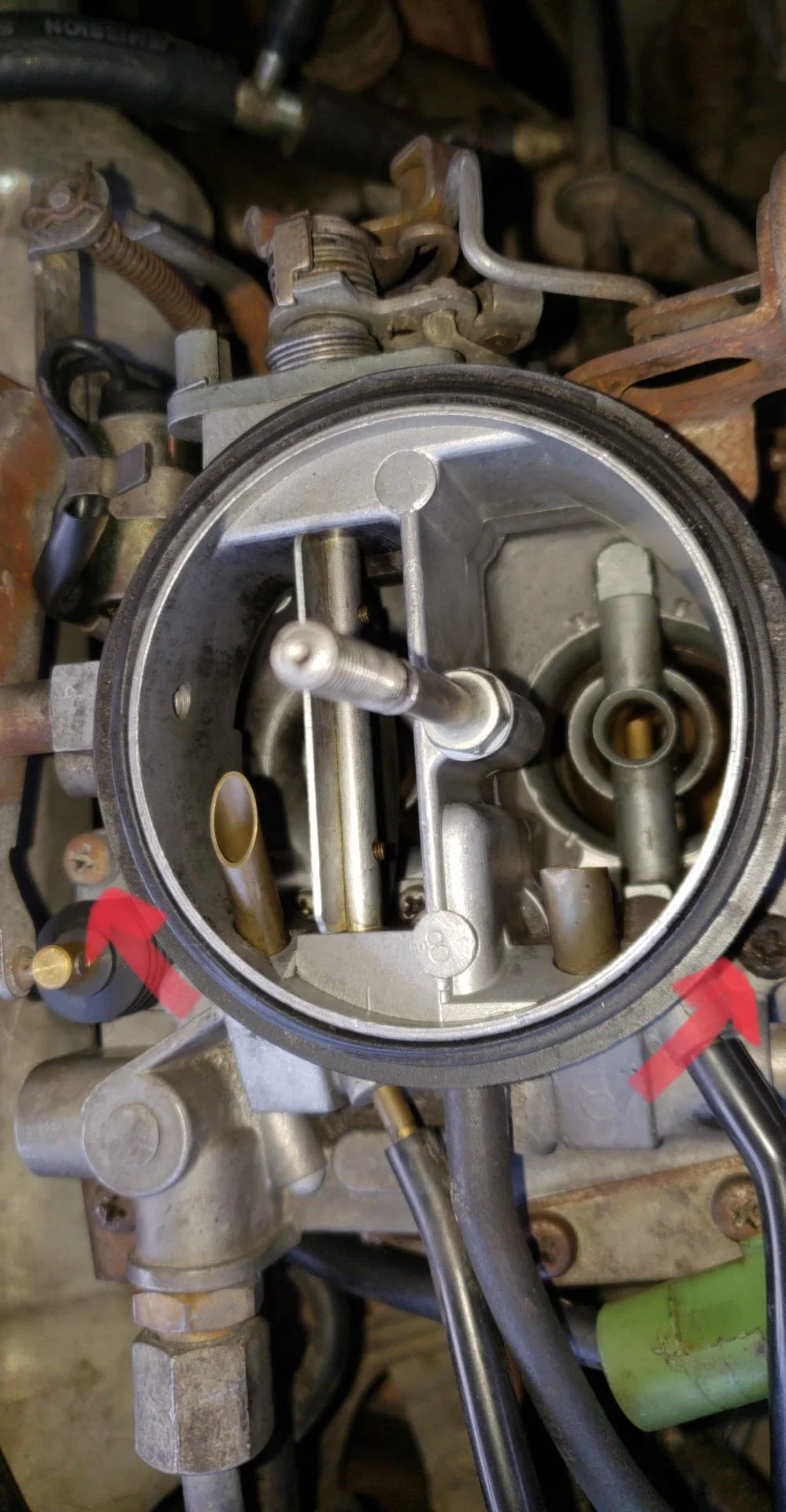

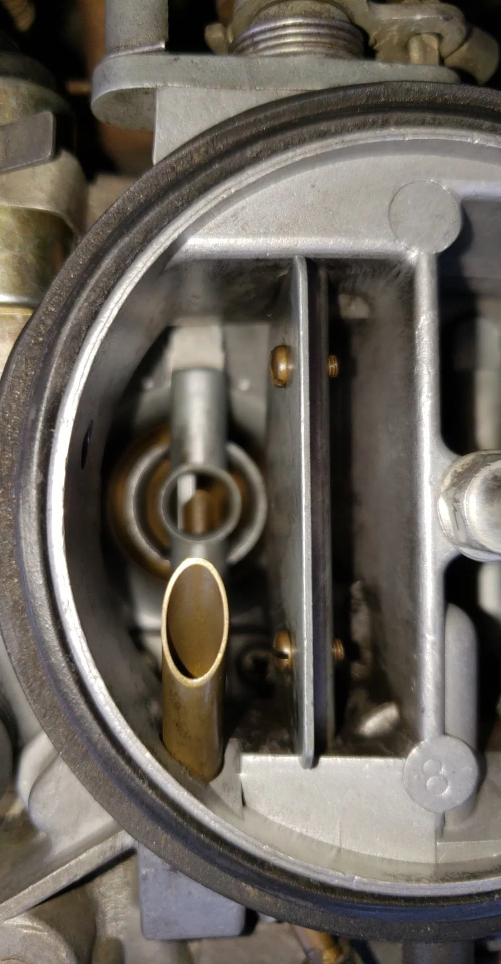

Paid $375 to have it rebuilt locally.
From what I can see, it looks like the window was removed(possibly to spray some carb cleaner inside?) The guy almost stripped the screw.
It doesn't look like the main bolts were even touched to remove it. (Still dirty)
I'm thinking the shop just retuned it, and sprayed some carb cleaner inside and replaced some vacuum lines.
Initial problems were that it wasnt idling, wouldn't start on it's own anymore. I had to start it with carb cleaner, and then it would fire up. But not hold idle and die when I let off.
The Carb. Shop told me i need a new brake booster to fix the idle Idling issue.
What else can I look for that would show me it was actually rebuilt?
I've spoken with Mark(s offroad) & City Racer LLC. They both said it probably wasnt rebuilt.
What can I do to confront the shop if its determined it wasnt actually rebuilt?
Here are a couple of photos.
Please let me know if you need any other specific photos.

If the plunger is new, the top plate of the carb has to come off. You can replace the boot without disassembly but not the plunger. All the screws that look like that one (7 total) have to come out to pull the top.
Learn exactly what is in the rebuild kit like the small check balls (each is diff sized and needs to go in the correct hole)and power valve etc and ask them if they replaced them or what exactly was done. Ask what rebuild kit did they use. They should have many left over parts in the kit as they are made for diff applications. Ask if you can have the left over kit since you paid for it. Ask if they replaced the bottom gasket, then pull the carb off the base and check. You'll need to remove the throttle cable and unpin some linkage from the firewall side of the carb.
I think before we all start pointing fingers for a shoddy job more photos would help.
I would expect the entire carb should have been dipped prior to rebuild which would be evident by eye. A carb looks like new metal after a dip. OP ‘should’ be able to see that unless s/he removed and packaged the carb to be sent w/ eyes closed...
Well I think that clarification from the shop as to what "Rebuild" means from their standpoint is a major thing. Shops "rebuild" could mean pulling the air horn (top) off and replacing the AC plunger and power valve and leave it at that, while everything is still on the truck.
