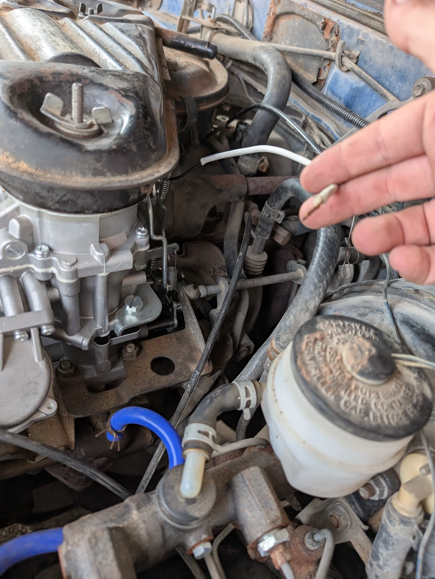

Brother installed new Chinese repro carb.
I fixed fuel u
Pump.
Runs on starter fluid, but bowl sill looks dry, even with electric fuel pump on(we use to prime carb)
Black wire with fuel cutoff solinoid, wrapped in white heat shield?
male spade comes out of back of carb, what is it?
Whats the wire going to on the carb?
My guess is the cut off.
Did you knock the float free first?....needle valve is probably stuck shut.
Yup ran ign hot to that wire a heard the shut off solinoid click, gonna, have to pull the top and unstick the needle valve, no gas in the sight glass
Whats the best way for cars only driven occasionally to keep the needles from sticking?
Better carb
Didn't buy carb, brother 3 bought it for dad's ranch truck.
Brother 1 installed it, but stopped because the electric pump we use to prime is bad.
I replaced pump, added ign switched power to fuel cut off solinoid(that the bastard used black wire for)
Soaked float in carb cleaner overnight to unstick needle...
Runs for about 60 seconds and then dies.
That's when I got exhausted and stopped.... Any ideas?

Do you have fuel in the sight glass now? How high is it? Have you set idle and timing? Using choke?
Aside from that, need a lot more info. Was it running before? Why’d it need a carb? How old is the gas in the tank? How much gas? Condition of spark plugs, wires, cap, rotor, points (year?), timing, compression, valve adjustments, vacuum leaks, etc.
More pics of general engine bay area would help identify any other obvious issues.
On another note, from that narrow pic, it looks like smog stuff is (mostly) intact? I’m not sure that carb has the provisions to run all the smog stuff and if it’s desmogged; there’s too much stuff left for it to be done properly.
Run wire in your hand (fuel cut solenoid) to switched 12v source (off keyed power). From factory there will be a single wire out of the firewall that would run alongside the coolant temp sensor wire. For temporary testing, connect direct to battery and reattempt starting. Make sure bowl fills and the sight glass is half full once running. If no visible liquid line, its over or underfilling.

I never saw fuel in the glass, but didnt' check after it ran dry
We do have the OEM carb, but the float valve needle stuck in the open position and gas poured out of the charcoal cannister.
Dads 89, and he doesn't trust that carb anymore, and had us(Bro #1) put a spare carb my brother(#3) had in back stock
(We have 6 60 (3 of which are running, 5 of which ar complete) s, 2 40s, one of each is diesel, plus at least a half dozen non running toyota pickups and 3 or 4 running ones dependingon how recently we've tinkerd with it, or gotten a bad batch of gas.), so we have spares parts lying about when we see them on a good special.
New carb is not smogged old carb was the original, to the best of our knowledge. Brother #1 swapped the carb out but did nothing about desmogging.
When I got there I was told the carb was swapped, but the electric fuel pump was bad.
That's where the thread starts...
Spent the whole weekend working on this 60 and one of the pickups,(unsuccessfully) instead of my 40 that I was there planning to take for a drive (was able to diagnose starter brushes are worn past the point the hammer trick works, I have a spare on the shelf to go in, but no time, trying to get dads ranch vehicles working again.)
Do I need to desmog this truck's engine before she'll run right again? Maybe I should mail the carb off for a rebuild?, Just trying to get it running for dad, in case he needs to go somewhere the minivan can't.
Truck was a great runner before, after I worked a bit it idles -great- so I agree it's probably a fuel issue, this truck has either run like a top, or had carb\fuel issues pretty much the last 12 years.
