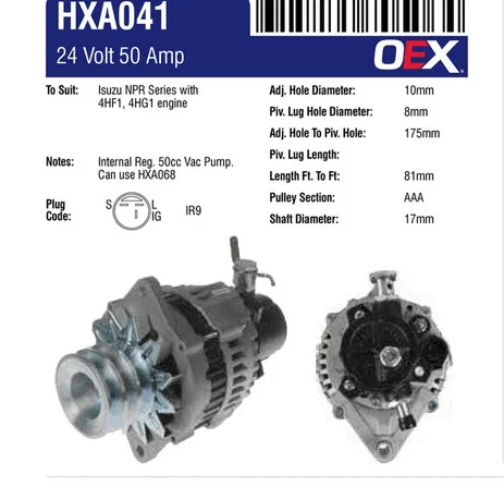

Thought about trying this and just returning it if it doesn't fit: NEW 24V ALTERNATOR FITS ISUZU NPR NKR ELF 4HF1 4HG1 ENGINE 8-97300-350-0 8-97300-350 I read somewhere that Toyota makes Isuzu's alternators and they look pretty darn similar, so maybe it'll work?
Sort of. Denso make the electrical parts for Toyota and Toyota own Denso ( I have a Denso system on my Triumph bike). No doubt that Isuzu alt could be made to work.
After looking through some Australian catalogs, I think the Isuzu alternators are branded as Hitachi, although they look the same as Denso
On pg 167 at the top is an Isuzu 24v 50 amp alternator for the same engine as in your Amazon link with vacuum pump. It also has the important dimensions and plug type. You can flick through the pages quick by clicking on "page over view"
