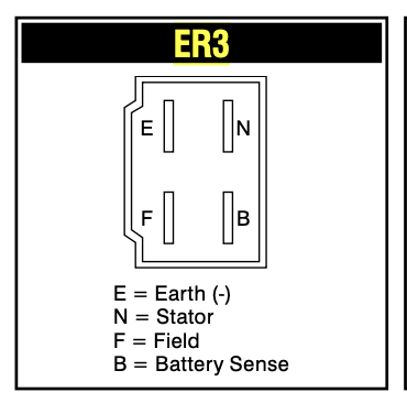

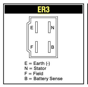

I have a new 24v alternator requiring an external regulator and my local Auto electrician is having trouble wiring it up.
It could be the new Reg is actually faulty so am buying another.
Alternator is charging at full rate, not being regulated .
any help appreciated..

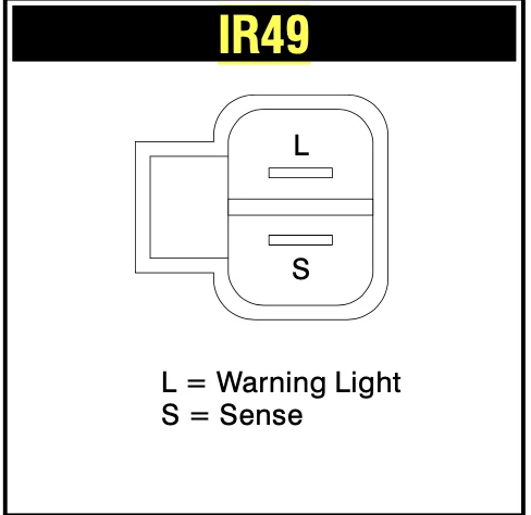

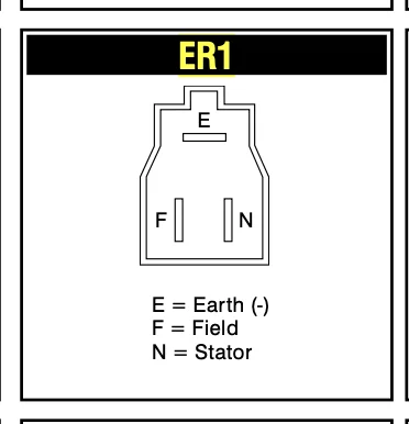

Resurrecting this discussion to keep it all together. Assuming the 12HT runs the same alternator as a 2H, the OEX HXA027 contains the physical specs we need to match. This is the 12v version, but it gives us the specs we can match 24v units
Foot to foot 105mm
Adj hole to pivot hole 175mm
Shaft diameter 17mm
The NAPA catalogue contains one 24V alternator that matches the specs and comes with a 50cc vac pump and external regulation. Plug is different but should be easy to swap pins around.
Anyone tried one of these?

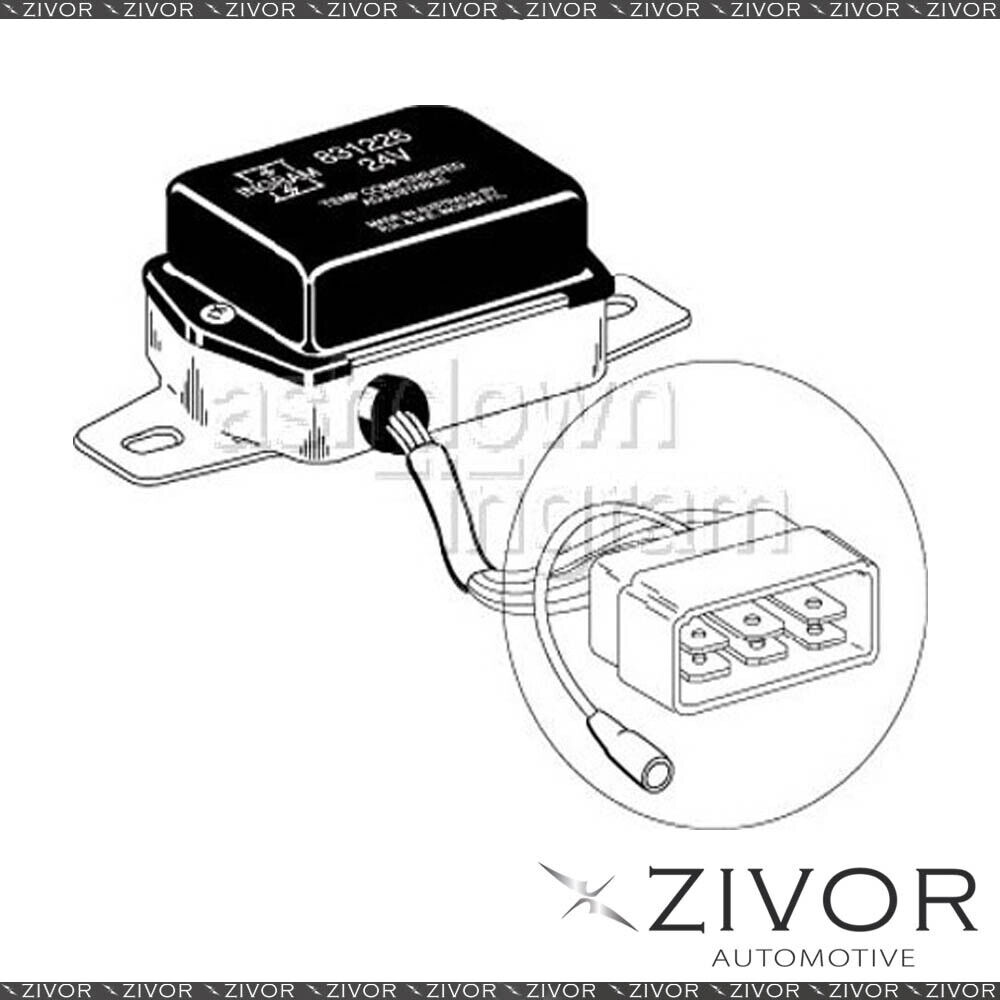

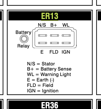

New OEX Alternator Regulator 24V - External To Suit Hitachi #RGX4026 | eBay - https://www.ebay.com.au/itm/334861894581? looks like it is a replacement regulator with pinouts.
The HXA004 is also from an old vehicle (Nissan SD22) and may be difficult to obtain. Be careful in choosing to make sure you get the 50cc vacuum pump, not the 30cc vacuum pump in other similar models.

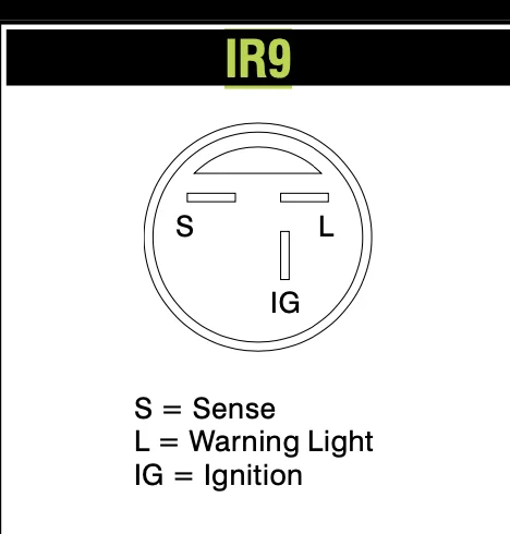

The HXA041 has a foot to foot length of 81mm compared to the 12HT 105mm. Other measurements such at the Adjustment hole to Pivot hole is correct at 175mm and a shaft diameter of 17mm meaning the 12HT pulley will swap over.
Internal regulator.
Internal regulator.
