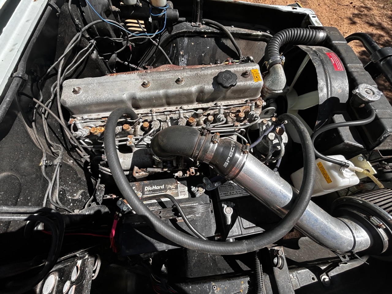

View attachment 3440128View attachment 3440129View attachment 3440131

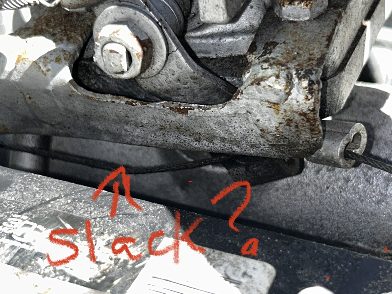

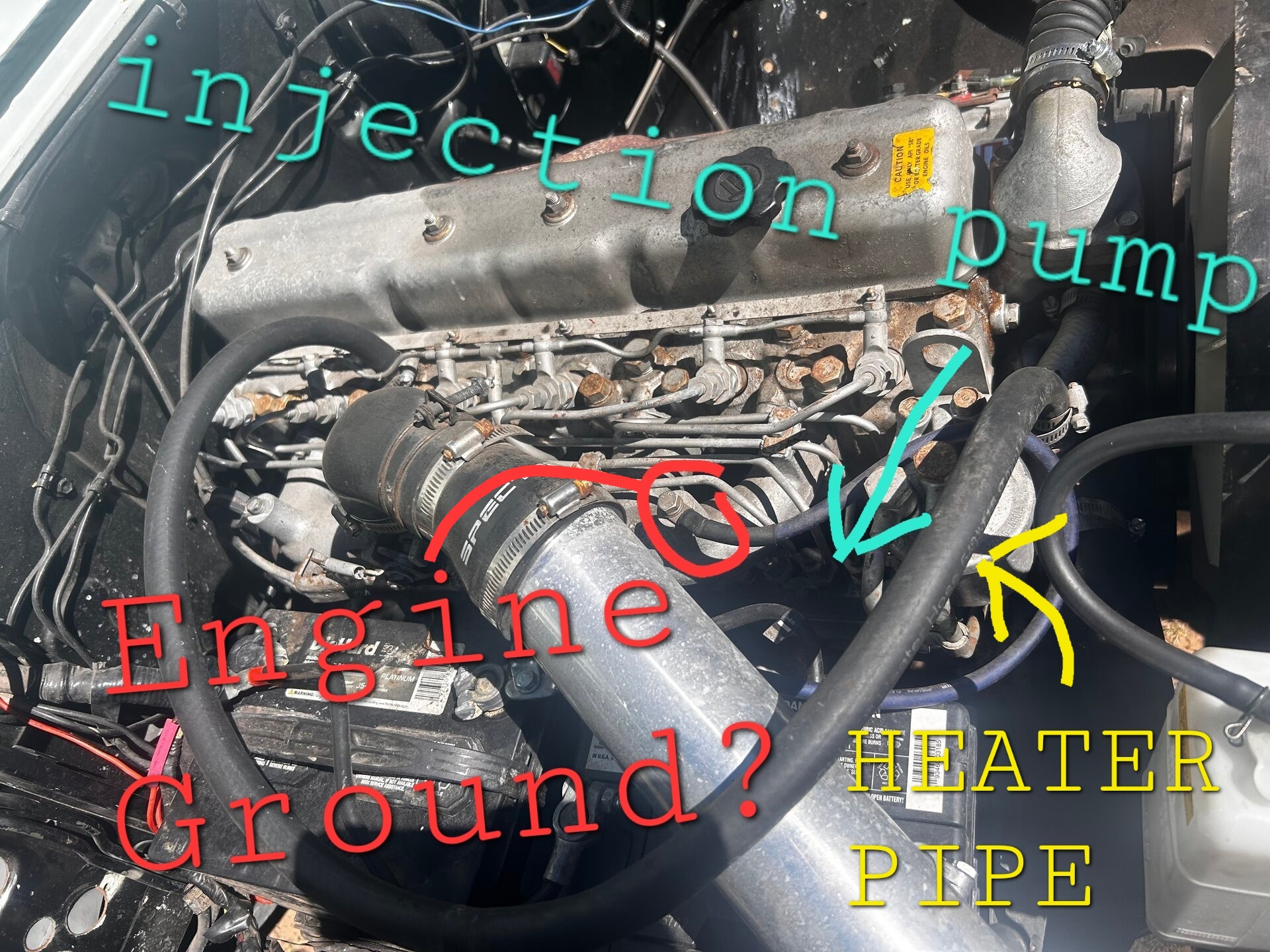

Its hidden down below all that stuff, but a few things in your photos draw my eye...
Your "slack" comment points to the accelerator cable?
It looks to me that the cable simply connects to the butterfly valve? Is there no linkage down to the injection pump? (Silvery shaft in my photo).
Its hard to get a photo down there with 2 batteries - maybe remove it and take a good look.
The big loop of pipe over the top of the engine should go to the heater matrix... thanks for the clear view as to where it connects! Where is yours though!? Removed? If they're not used then you should blank them off, otherwise you're bypassing the radiator and it might overheat on a hot day.
I'll try some more pics.
The HJ had a Vintage Air AC unit and the heater core was removed. I took out the AC unit because the pump was too rigged up, I couldn't move it enough for tension, and it was chewing up belts.
When I took off the hose there was gravel and hair (?) inside!
I may reinstall that unit later: either after the restomod if I swap in a 1HZ or something.
Since one end of the hose went from the front to the AC for the heat, and the other exited the AC and into that top part by the manifold, I thought I was completing the loop of water flow. Are you saying that tube is best removed and those ports plugged up? Wouldn't that stop the flow of water?
If I install a heater, I guess those hose would make that loop again-correct?
Correct. The water should circulate through the radiator, but also circulates through the heater core when it's switched on.
You've removed the heater matrix and the valve, so water can freely circulate through that pipe, and doesn't have any way to lose heat in the process.
Plug both holes, and all your water will then circulate through the radiator, which is basically the same as having the heater switched off.
You could just cut the pipe and insert the original valve in the closed position. Same same.

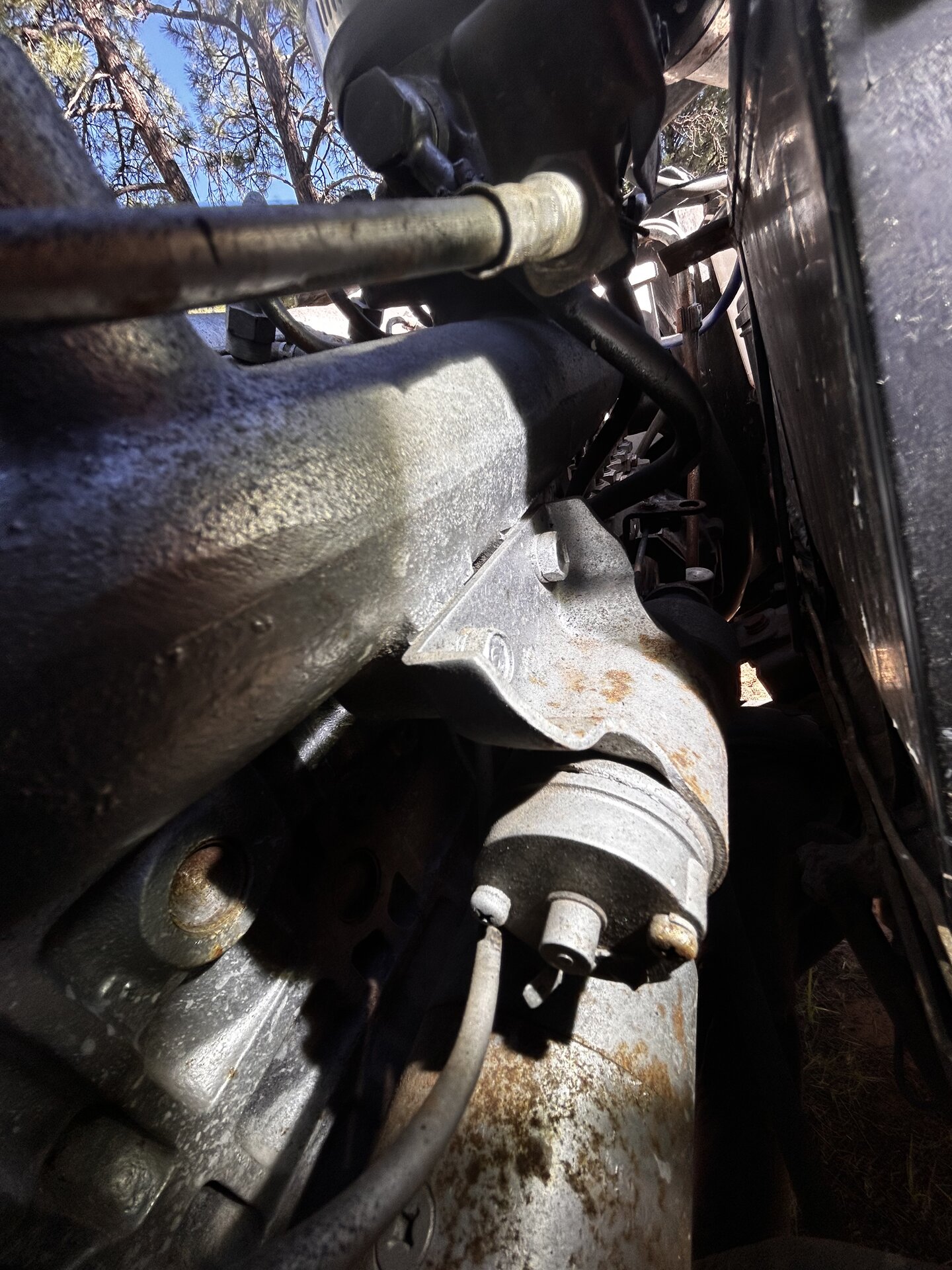

You have the over injection magnet - see pic - but it looks like the electrical contact is broken off?
I think this is only used to make starting easier though.
