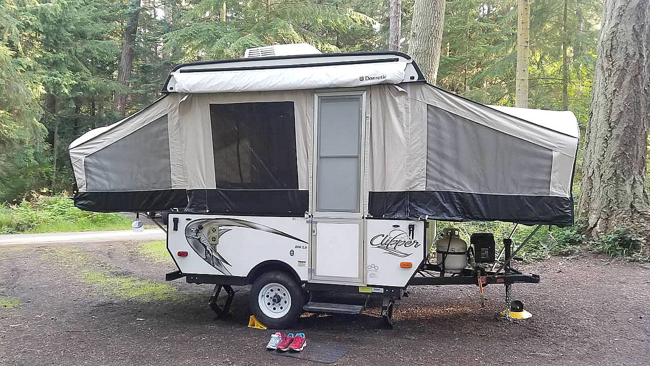

if by travel trailer you mean small pop-up tent camper, you should be golden.
