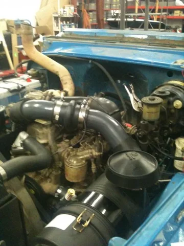

I did get some stuff done today. the intake runner got drilled and tapped to accept the boost pressure tube. I got the intake connection from turbo to aircleaner done, that took an act from God. The Donaldson air cleaner housing had to be repositioned 5 times. it now sits 1/4" from the A/C pulley. I got the gauge bracket mounted. That was a compromise and took the repositioning of the A/C controller box. By the way, anyone who has the Nipondenso A/C unit in their 40 series might like to know that if you take the control box (on-off/fan speed switch), There's a rubber plug on the left side. A note over the plug says "colder with a arrow to the right and warmer with the arrow to the left". Mine was set in the middle. I live in Florida,,,,,, no I don't want more cooling, I'd like my A/C to be as warm as possible.
Now, I've been looking for a switch that says turn clockwise for more horsepower, turn left for less horsepower. Ain't found it yet.
I showed the last picture to my girlfriend; the first thing she says is "Are you going to straighten that A/C controller box?"
.....yeah,,,
Looking at that fantastic air cleaner (the plastic Donaldson unit), I can say that it would not work with an A/C unit in a 40 series. My concern was I want a Safari Snorkle. TurboGlide has a picture of my truck with their turbo connected to the all metal Donaldson Filter assembly with the Safari snorkle. If they make a plastic Air cleaner that will fit a 40 series Right Hand Drive diesel, that would not interfere with A/C, I would probably have gone that way. Donaldson's Website ain't that easy to navigate. I tried to order a Donaldson system thinking if they"re here in the U.S. it has to be cheaper than getting it from Australia. Not so, I ended up telling Turboglide to include their Donaldson aircleaner. Sometimes you go with what you hope will work and then you kneel down and pray.
