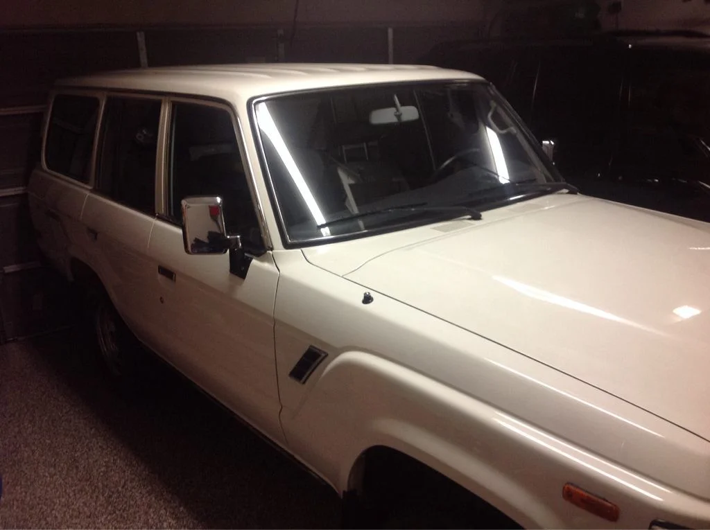

Either way I'm good. I either have the highest miled 89 or one of the lowest. :). Oops. Looks like a low one.

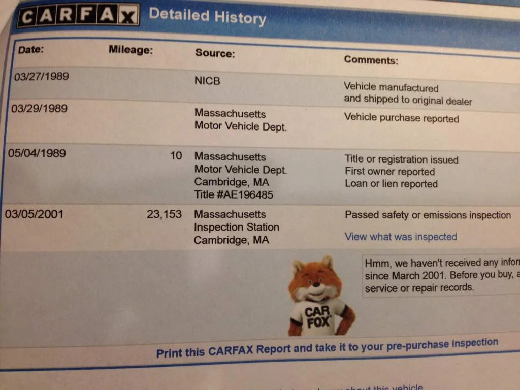

I love what the fox says.
If I did the math right that is 49 miles in the last 13.5 years. 3.63 miles per year.

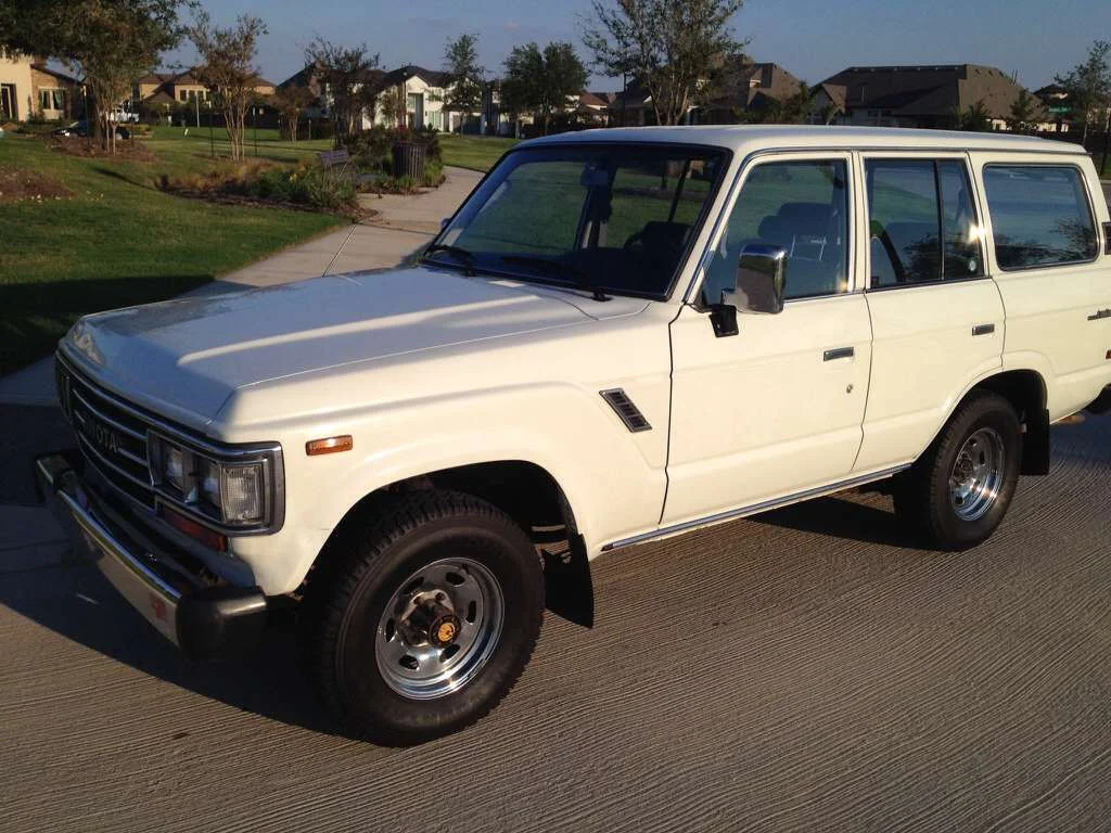

Sorry to be such a smarty-pants. Just having fun. I finally had time to wash her. I've got to get her to the next level- car show condition and hope to do so between now and Spring.

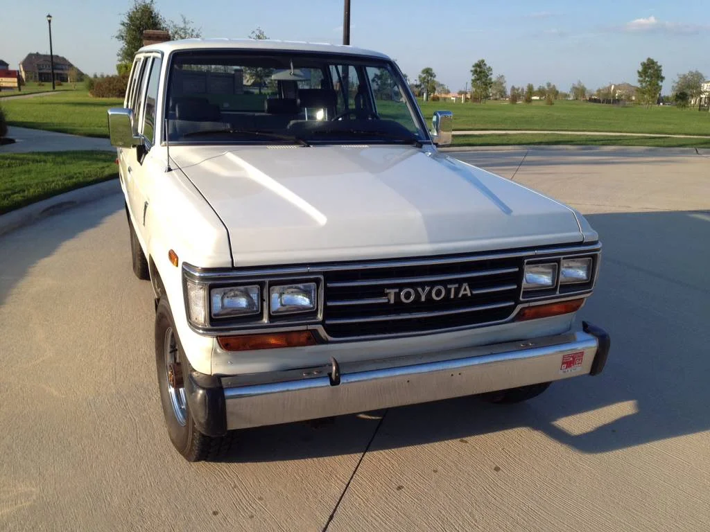

All in due time....I must say the ride is like a new car. Smooth and tight. Makes me giggle. The tires may be 17 years old but are like new...no rot since it was indoors 13 years. Not sure if I really need to change them (other than they are smaller than I like). Factory was 225 and these are 235s. Want to go 31 10.5 15. Which look nicer but still stock look.
That thing is clean. And it had to be white, makes it look even cleaner! I'd be curious if the 'new' car smell still smells like all of our old yotas do.
