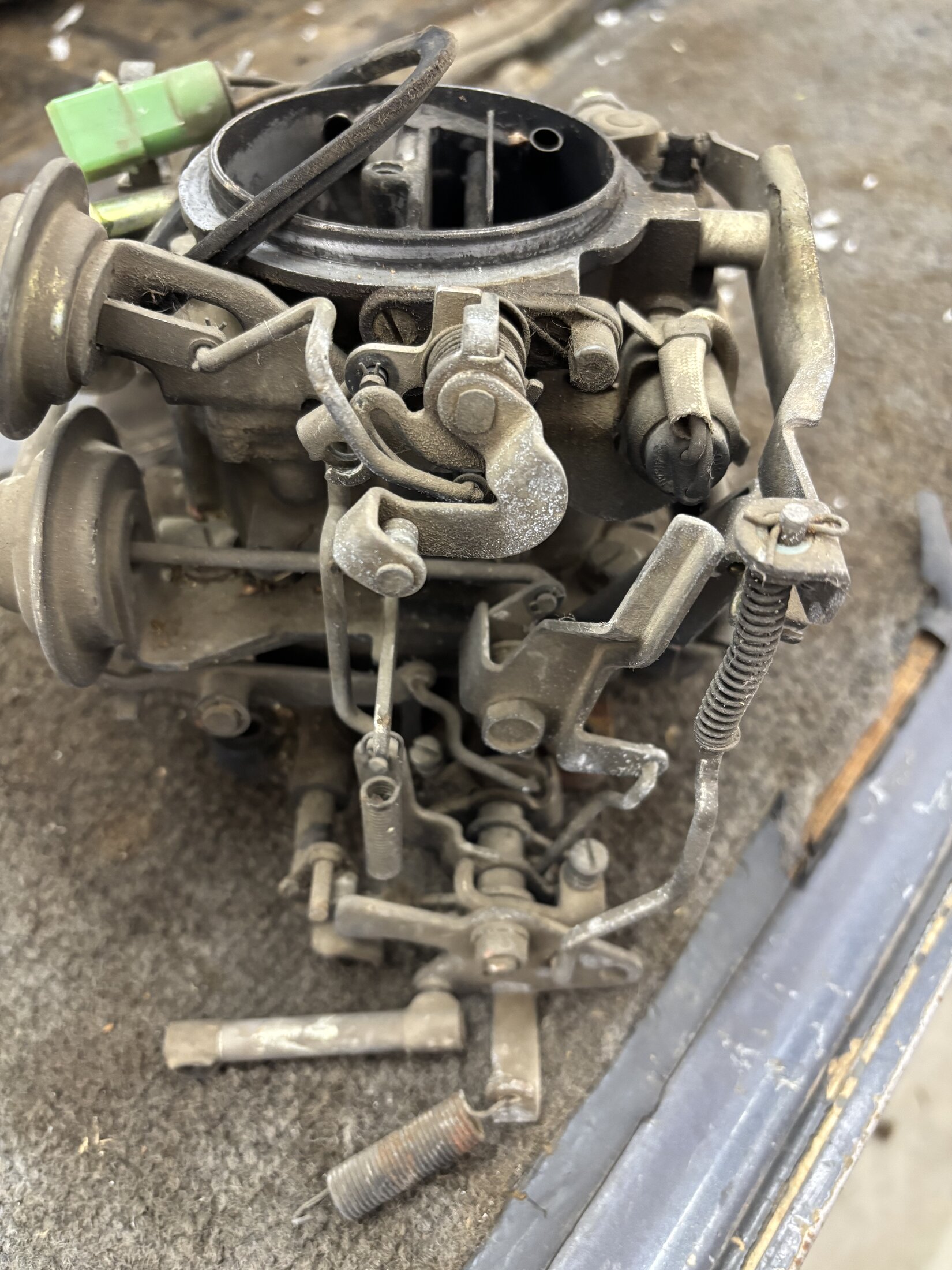

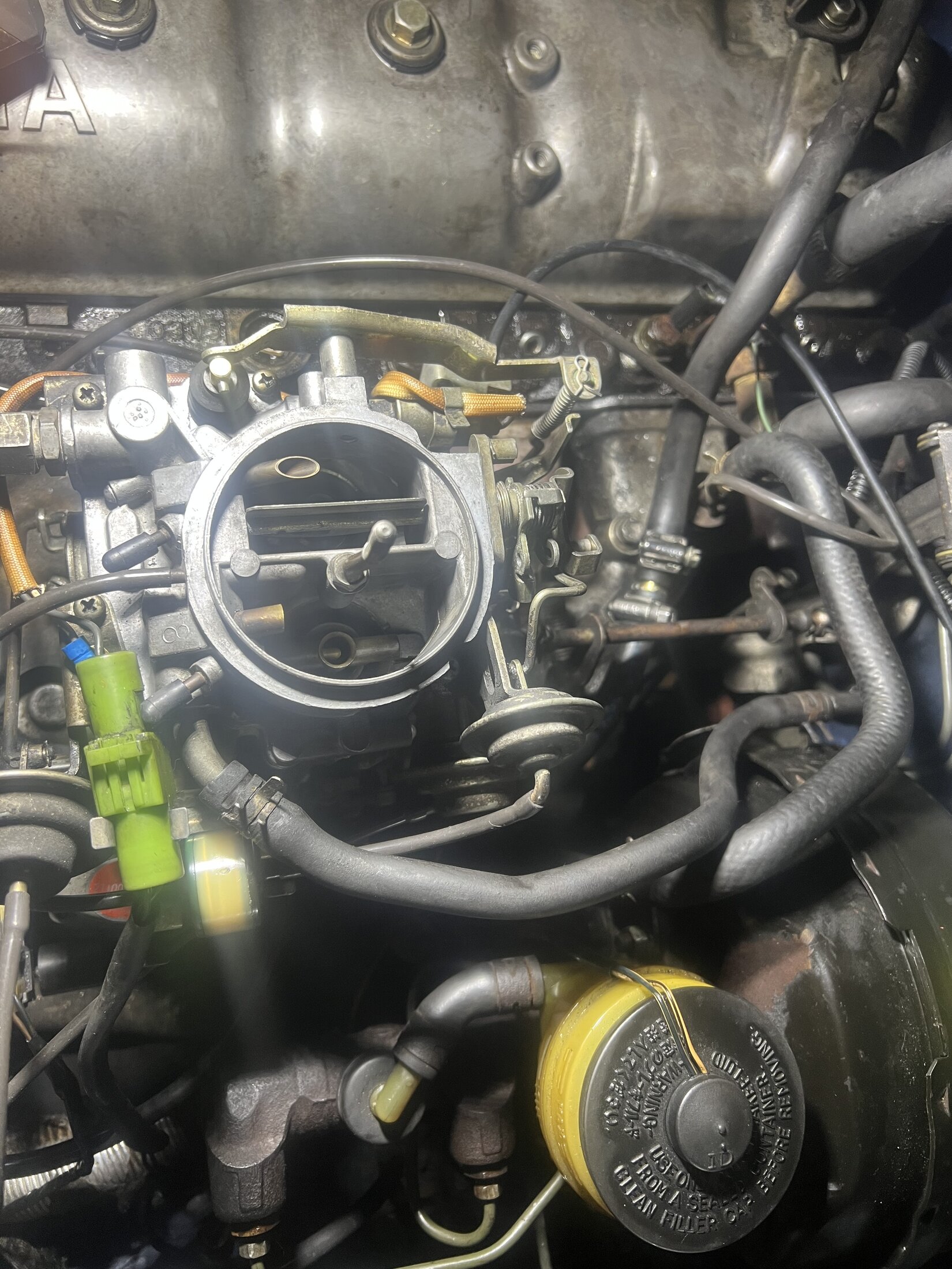

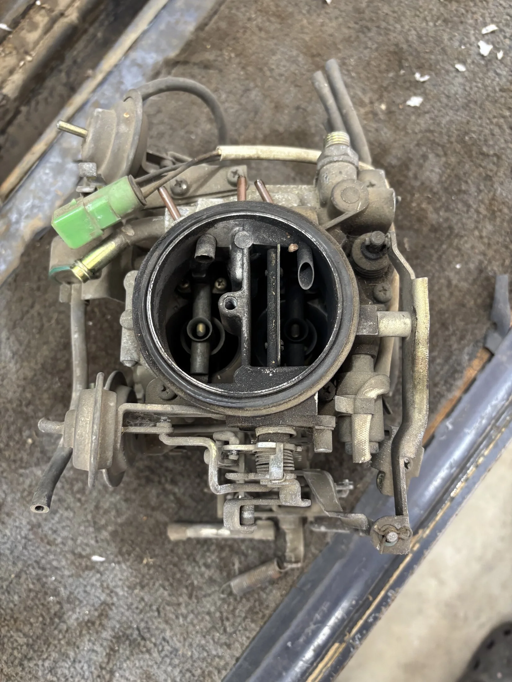

I have another question. Is this what my carb is supposed to look like at rest? I feel like the blade being altogether vertical is a problem? I can close it but I have to turn the choke mechanism counter clockwise 90 degrees. It’s spring loaded so it goes back to the picture.
The blade that’s vertical is the choke. If you pull your choke knob out, it should close that blade.

With the air cleaner off like it is, look down the throat of the carb. The primary is opening and closing properly … what about the secondary? You’ll need a flashlight.
What about the AC idle up screw? It’s on the side of the carb with the float bowl, facing the front of the truck. There are two vacuum pots on that side, each with a linkage rod that connects to the butterfly valve shafts. You’re looking for the shaft towards the valve cover - you’ll see a screw there. So: down low on the base of the carb, the side with the sight glass, towards the valve cover.

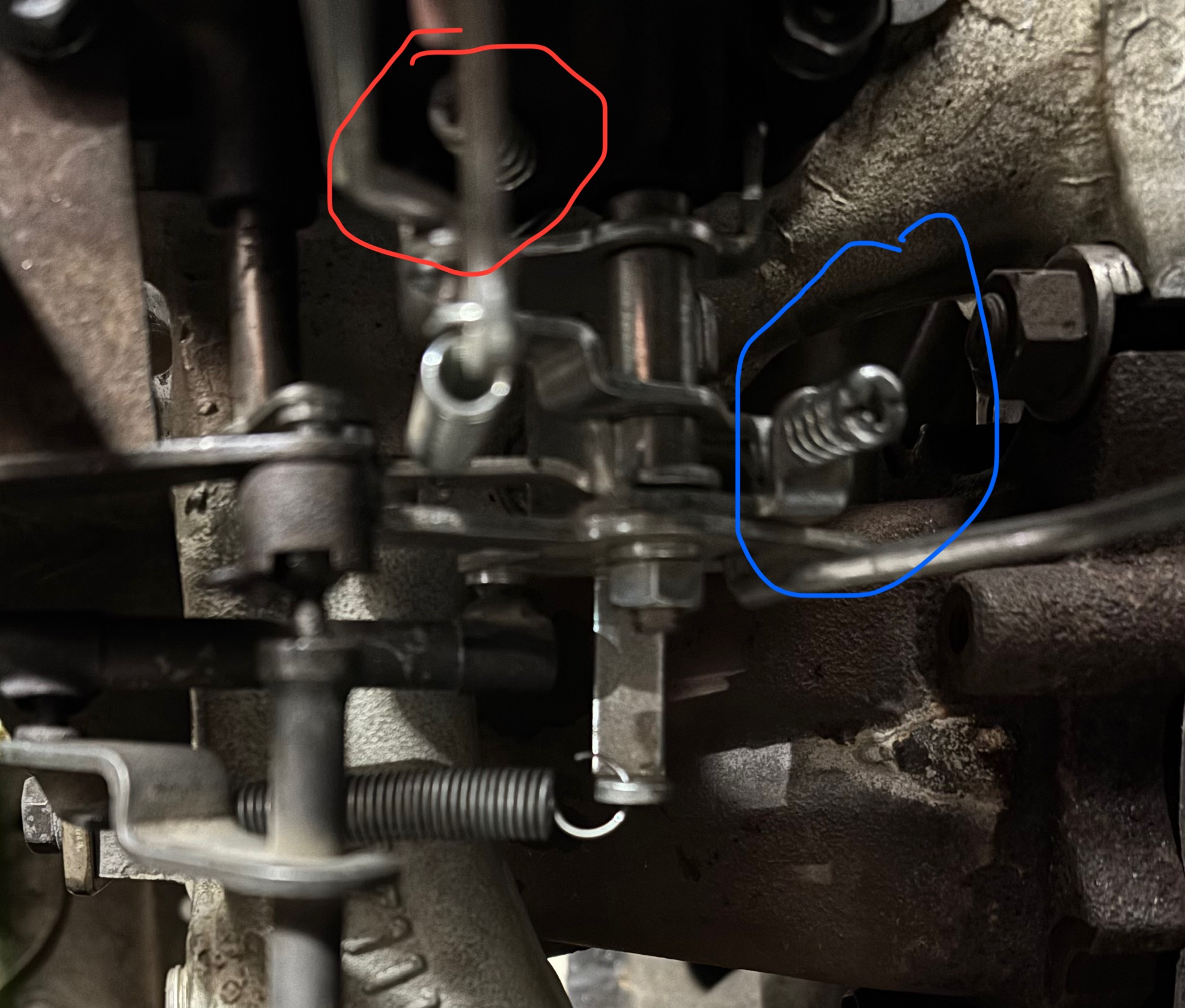

Here’s mine below, carb is slightly different variant so won’t look exactly the same but screws should be. Blue is high idle, red is curb idle or standard idle speed.
The screw on the firewall side of carb, closest to the valve cover, is the high idle screw.
Here’s mine below, carb is slightly different variant so won’t look exactly the same but screws should be. Blue is high idle, red is curb idle or standard idle speed. View attachment 3861353
Correct. So the blue is somehow adjusting my curb idle speed and the red for all I can tell is doing nothing. Maybe I have a linkage screwed up?

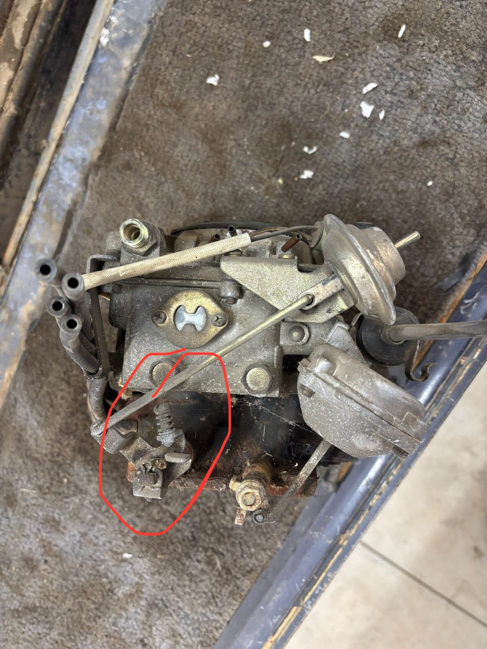

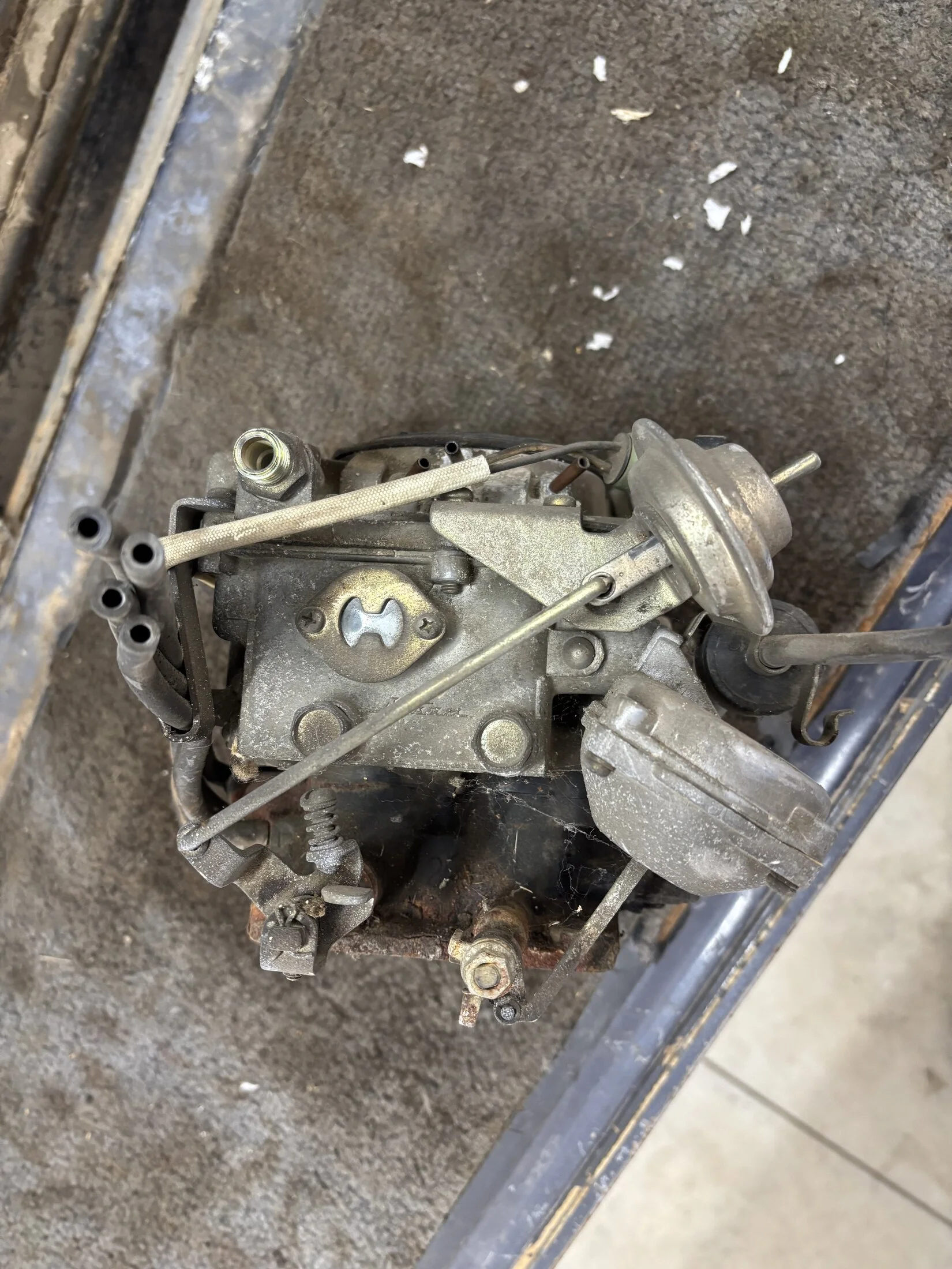

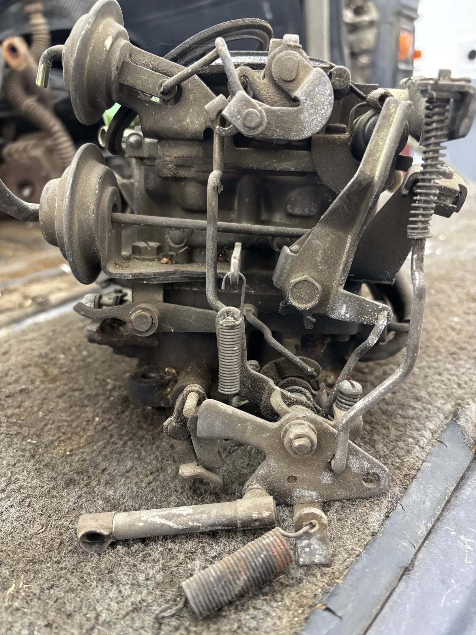

Here’s pics of the stock carb from an 87, still smogged.
Here’s the AC idle up screw @CruiserTrash referenced.
From what I can see between your pics and my carb, linkages look correct.

Red is the warm idle screw - the main idle screw you want to work with once everything else is good. Blue is the high idle limit screw (sets the rpm with choke engage essentially) - perhaps that’s doing something to elevate the idle when it shouldn’t be?
