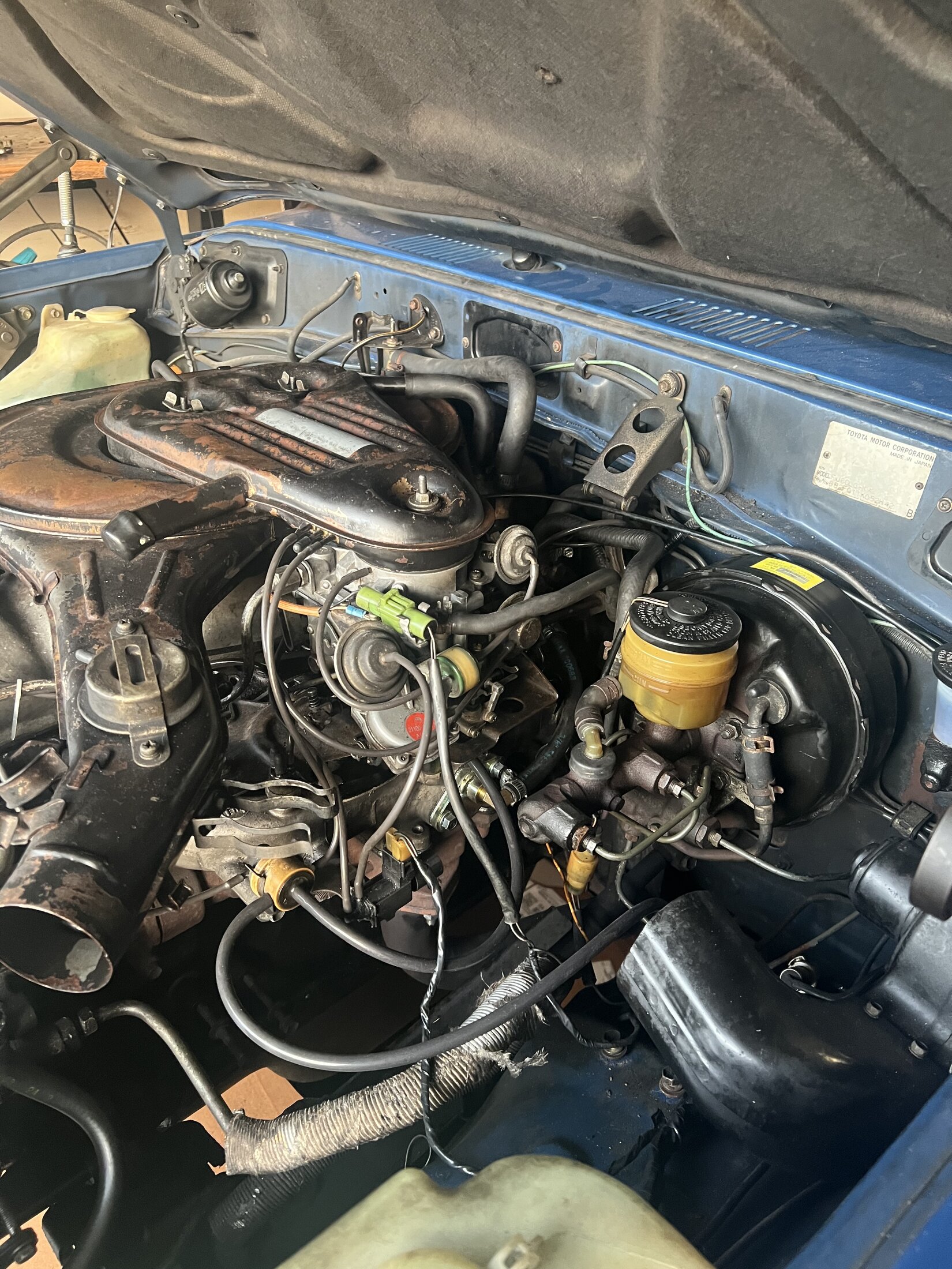

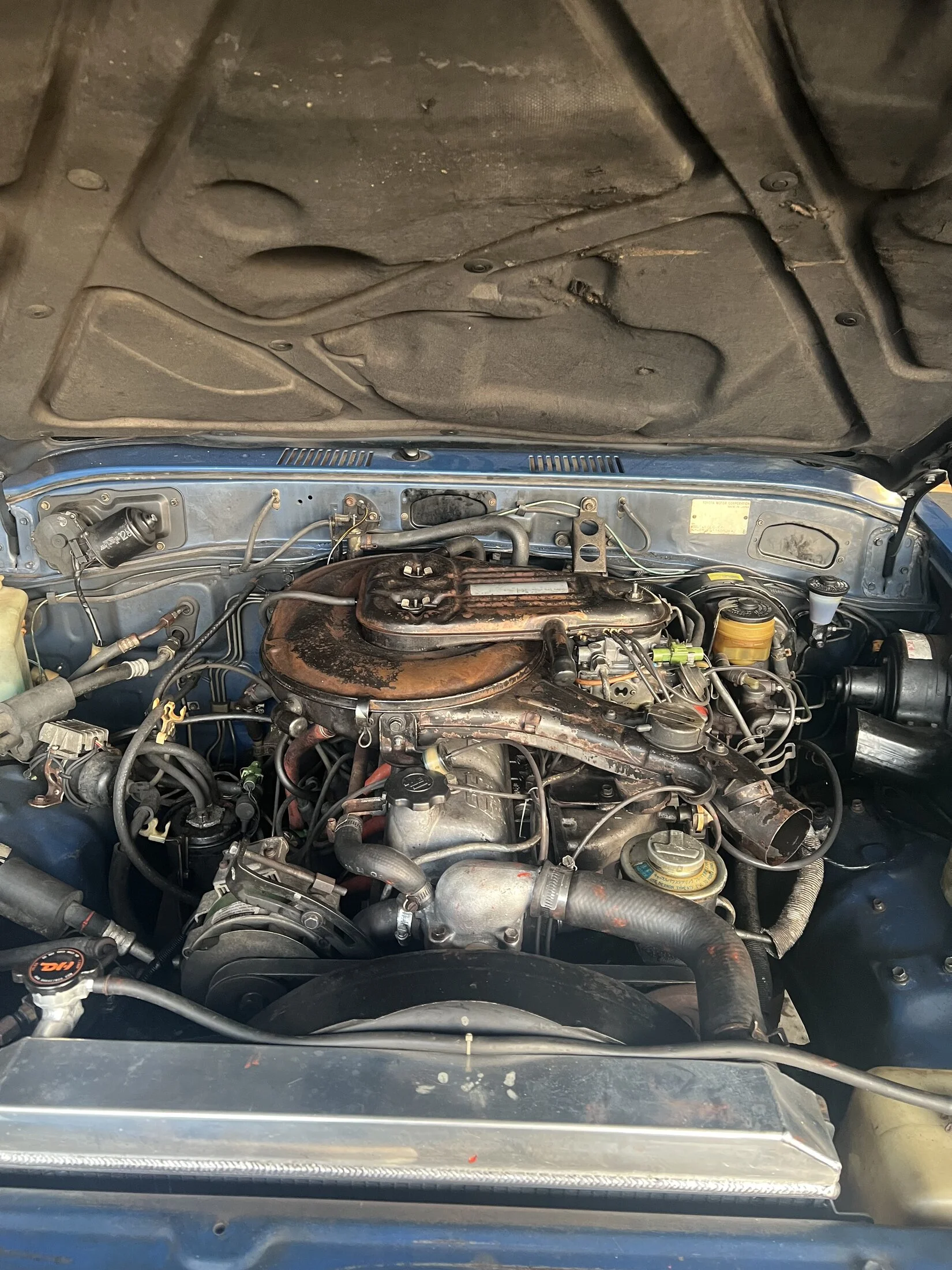

Post some pics of your carb, linkage and engine bay in general?

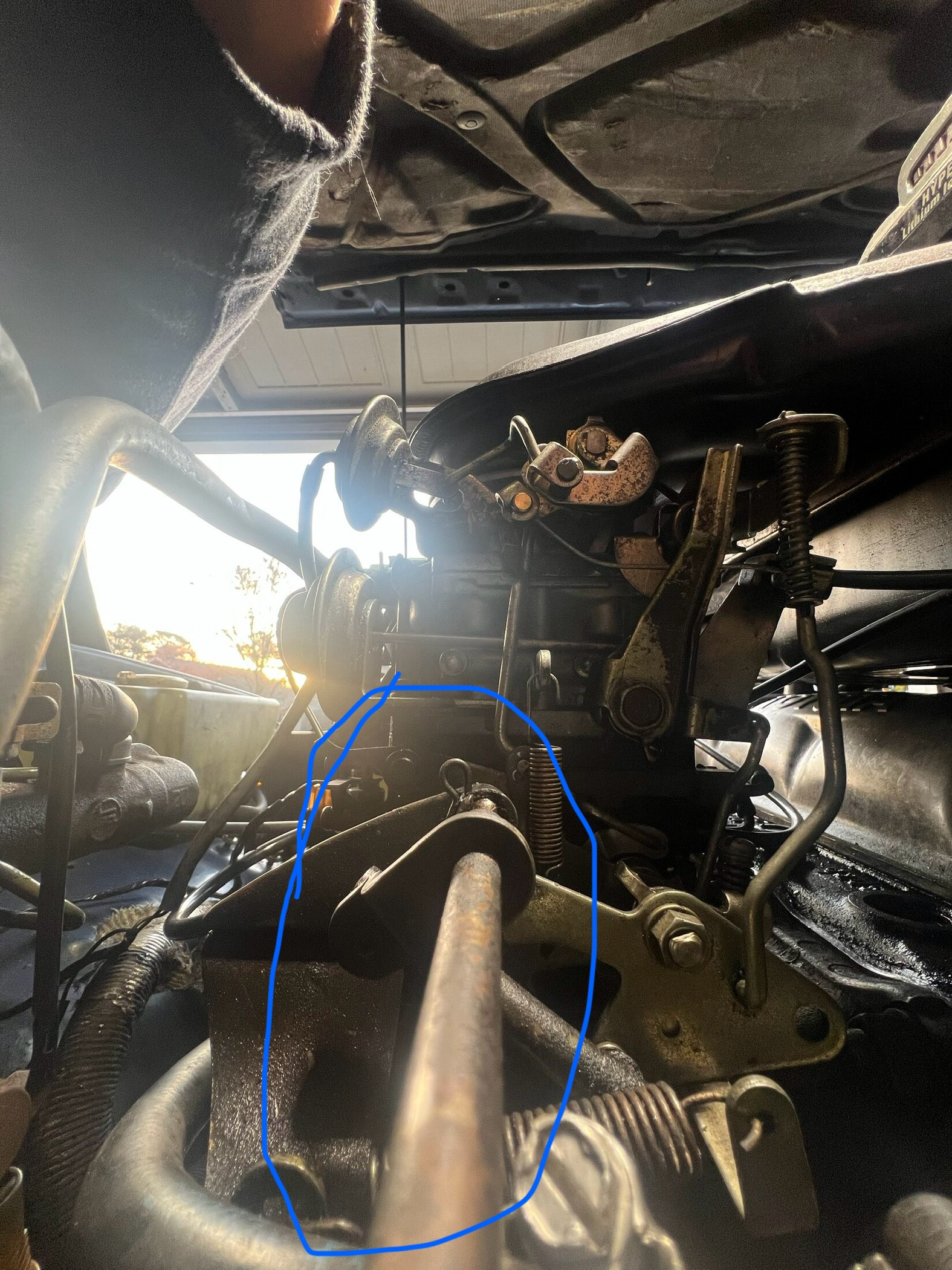

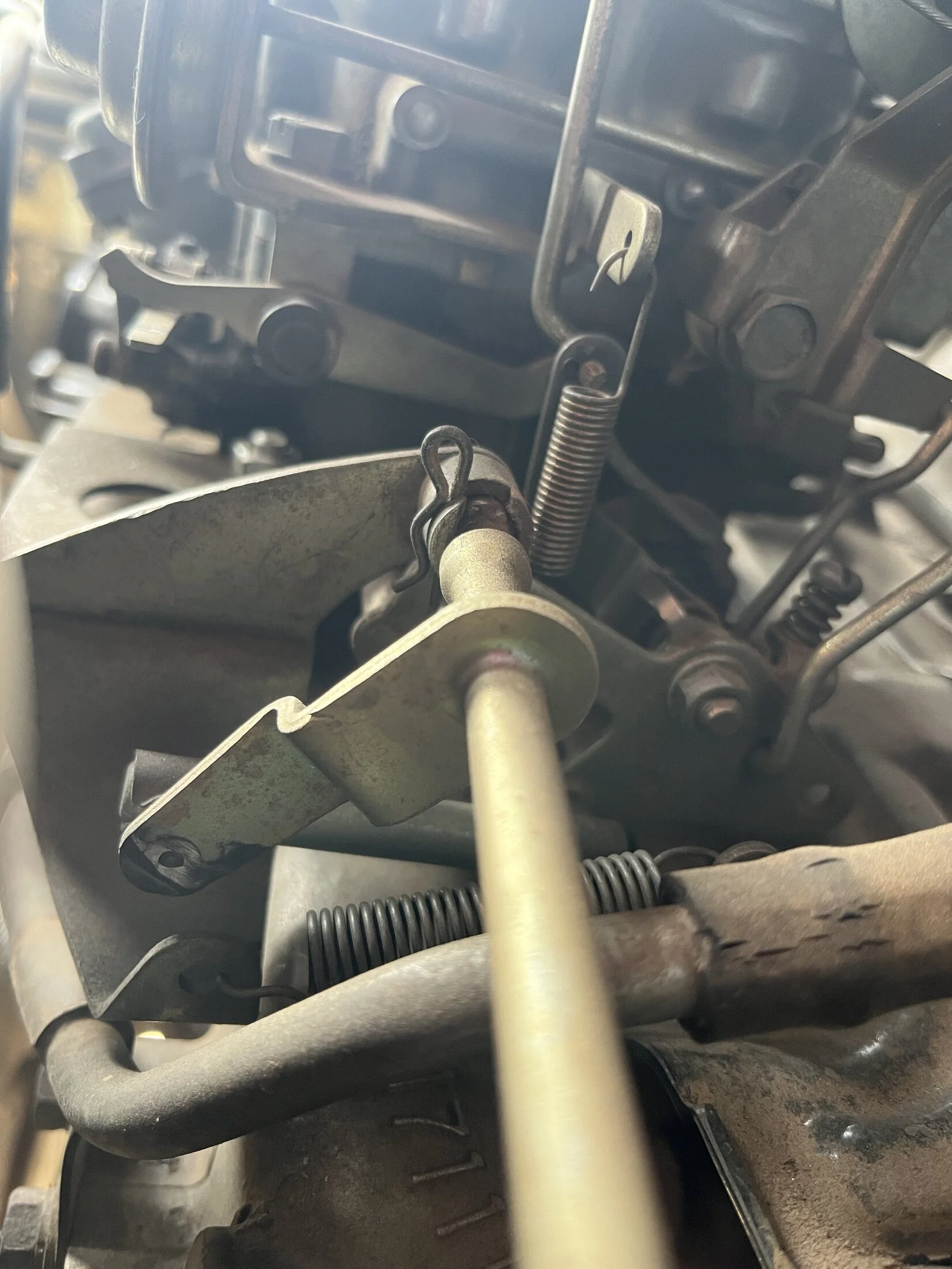

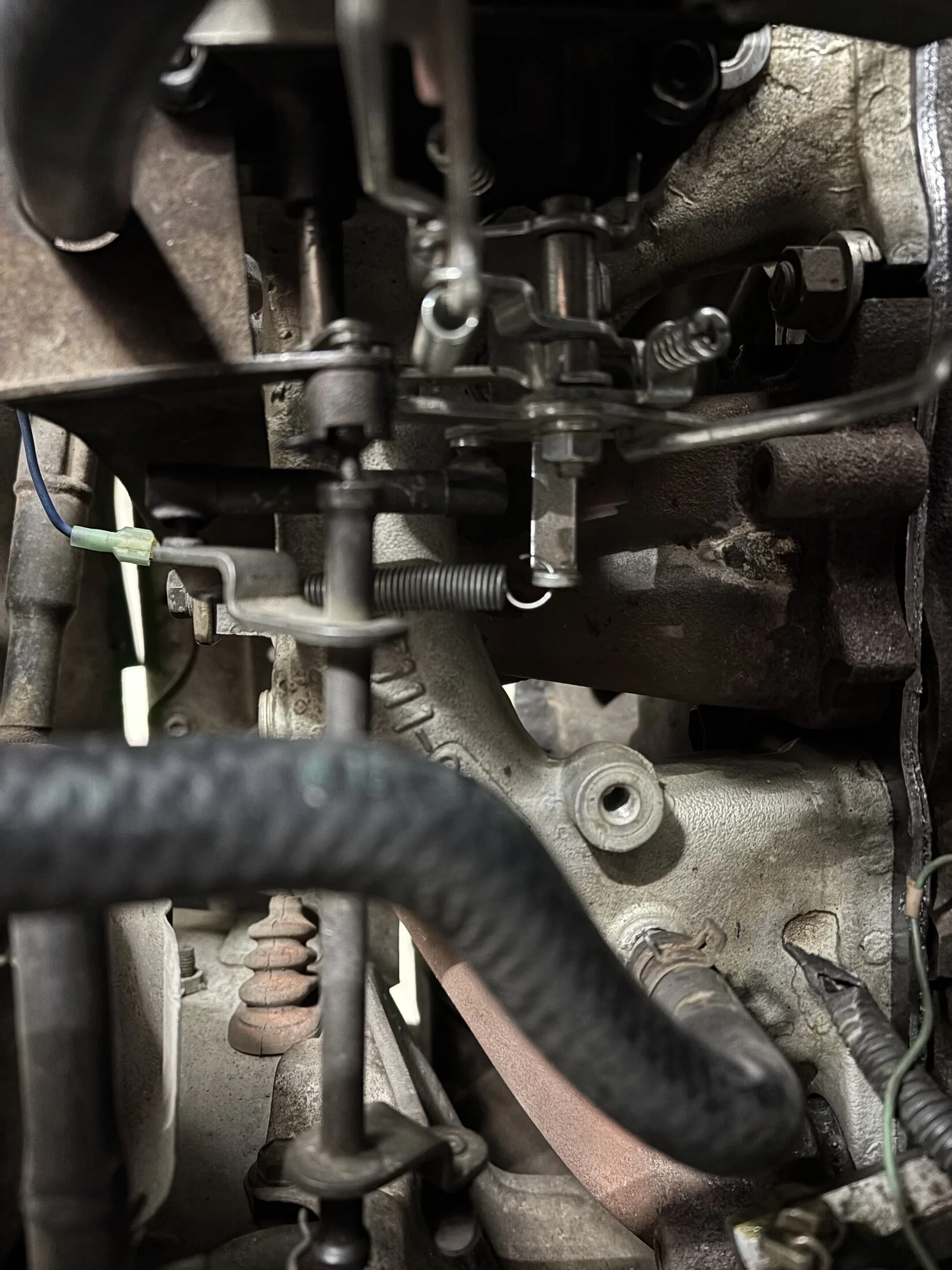

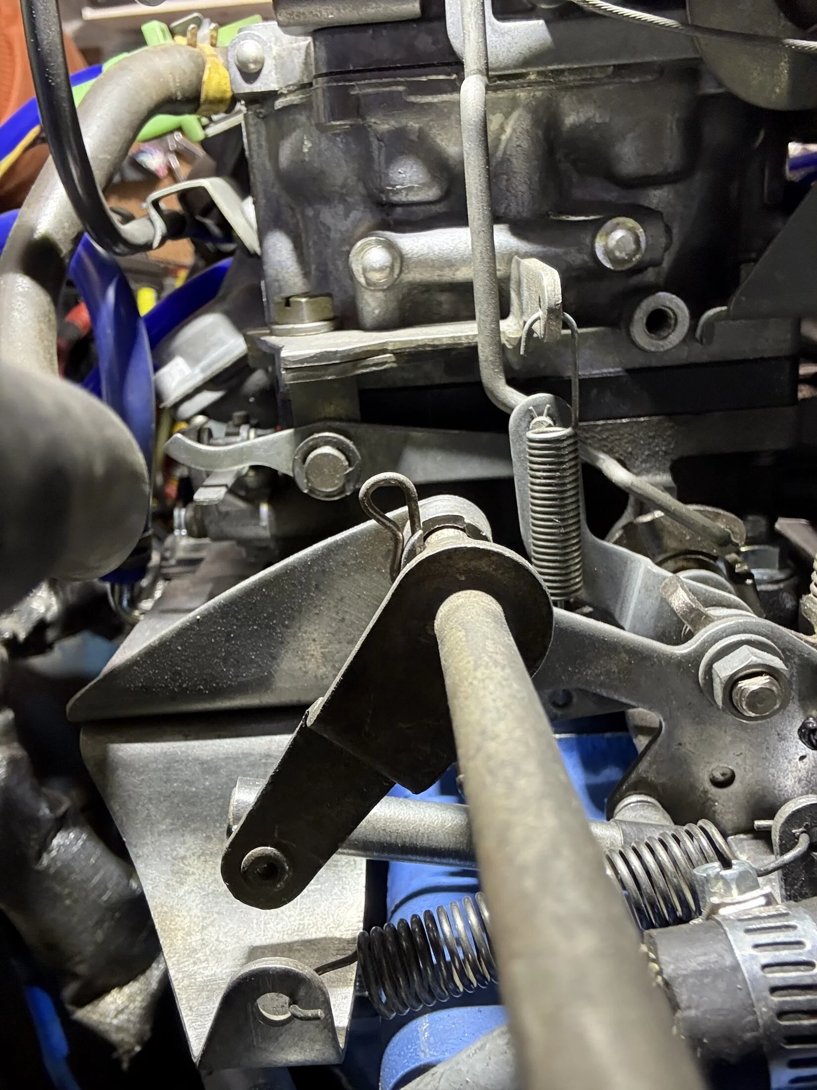

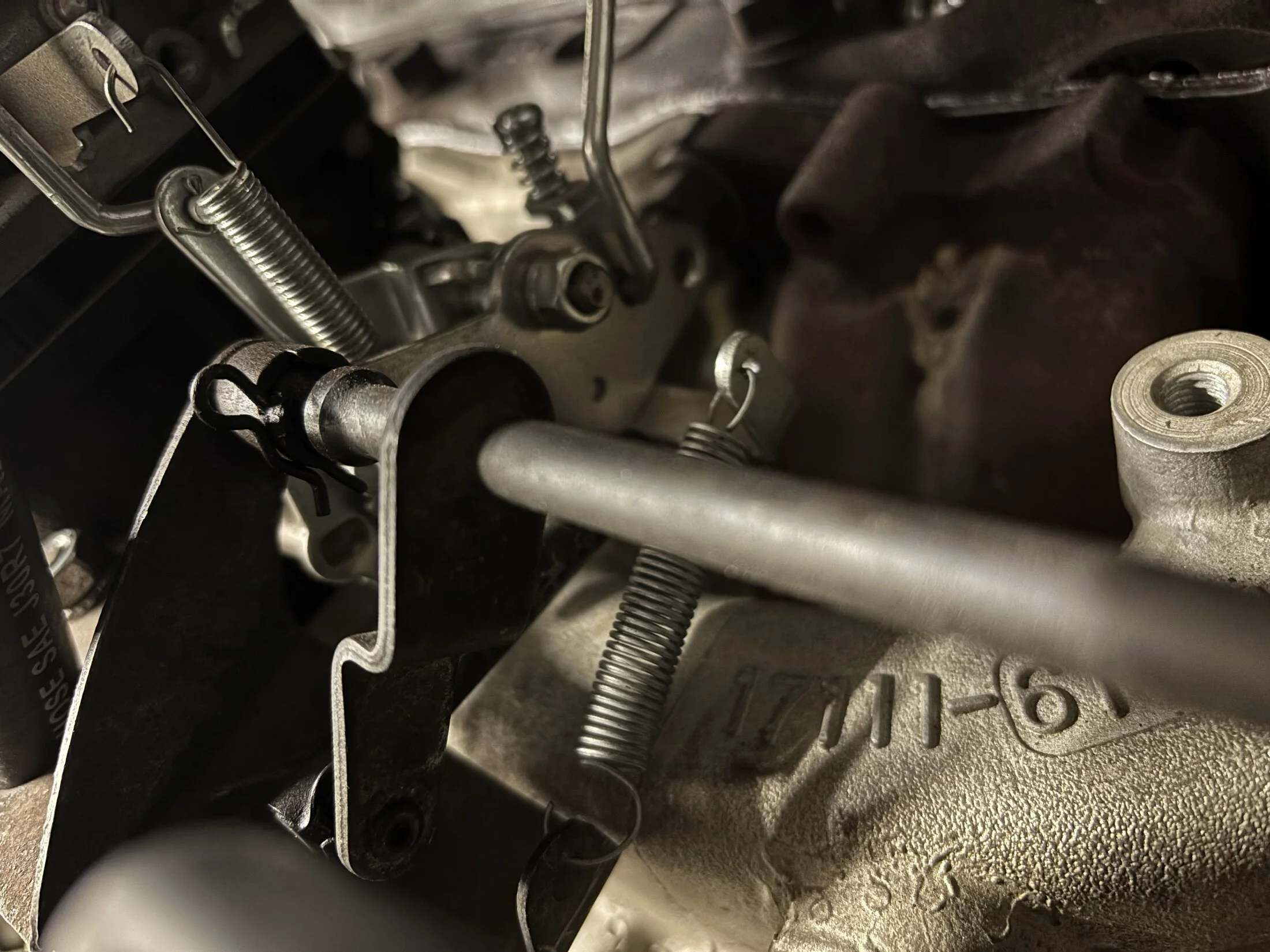

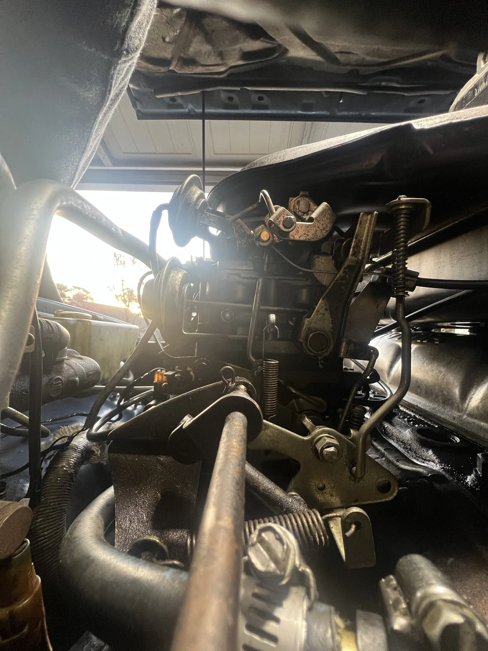

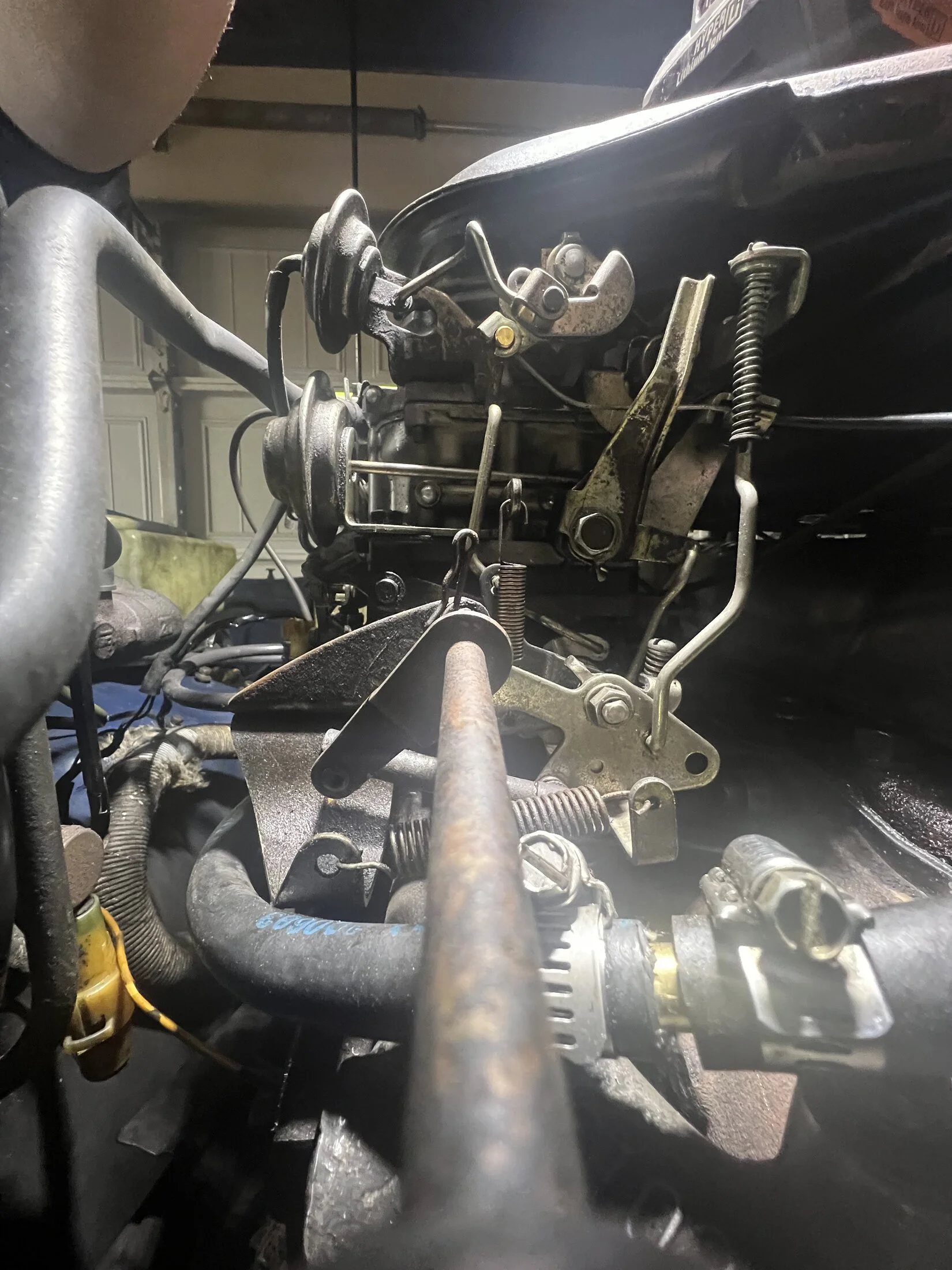

Alright. Started her up this morning with the ac idle up screw back out a little bit to where even if the ac was on it wouldn’t change the idle and it stayed at around 1400 with choke out and no choke. Here’s some pictures of my linkages.
First I’d check that the throttle blades are closing all the way. Look down inside, and/or you can unhook the linkage and make sure.

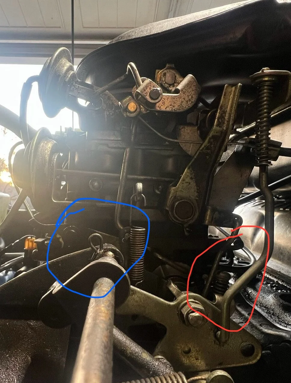

Are you adjusting the idle speed screw and not the fast idle screw? Blue would be area idle screw is and red is fast idle (when the choke is on).
Once you’ve verified that, then I’d look for vacuum leaks and check timing.
Your linkage also looks setup different than mine. But that could be a year difference?
Looking at your pics again, I think your linkage rod might be turned 180 degrees. There’s a long arm and a short arm, the long arm goes at the carb end (pointing down).
Looking at your pics again, I think your linkage rod might be turned 180 degrees. There’s a long arm and a short arm, the long arm goes at the carb end (pointing down). View attachment 3860742
I'm thinking this too. Something looks goofy here.
I also feel like the short rod that goes down and to the right from the blue circle ends up being horizontal. I'll have to check my carb later.

I think it’s as easy as flipping the rod around. Don’t lose the little clips for the ball & socket joints!
Linkage looks way more better.

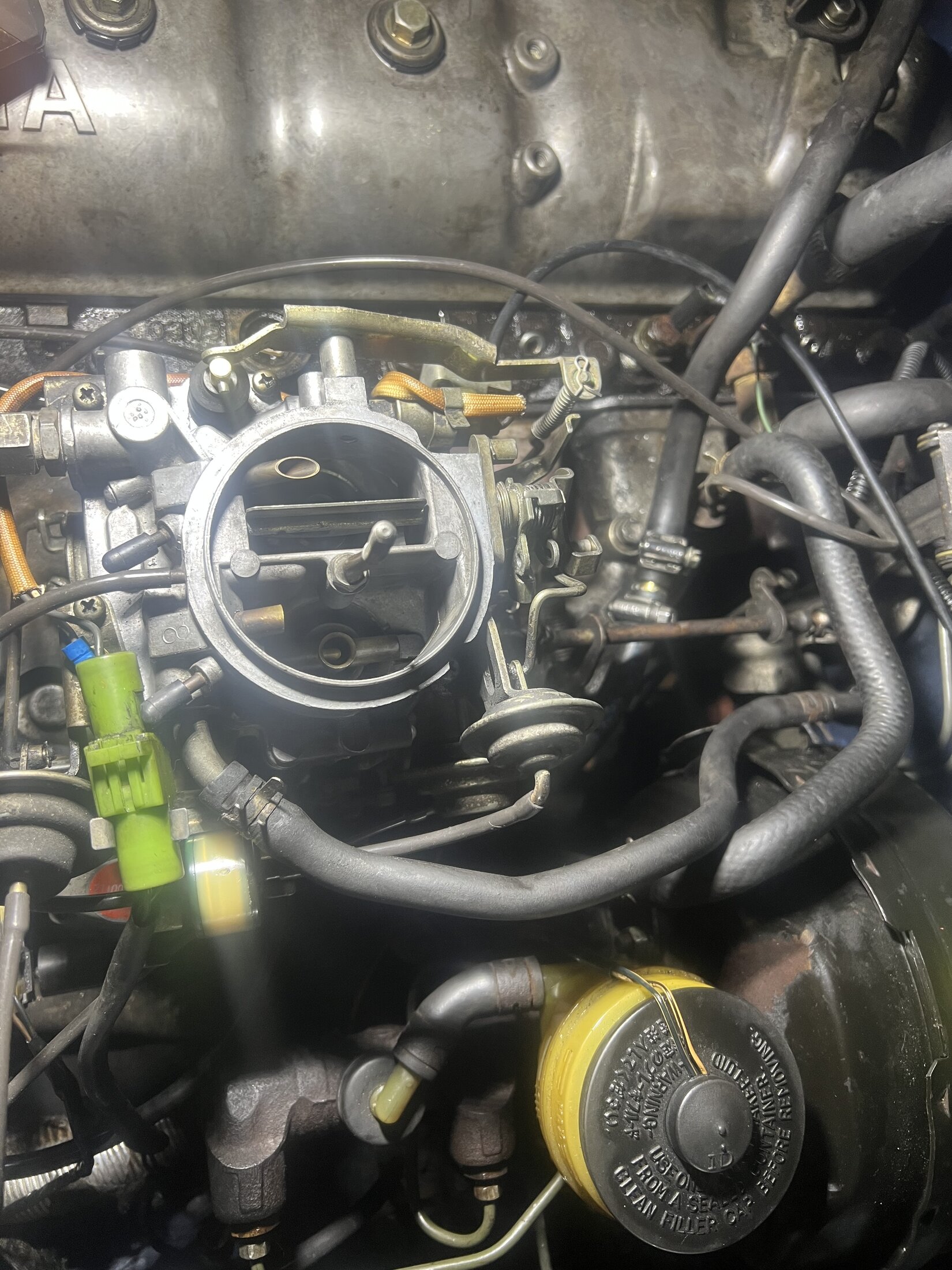

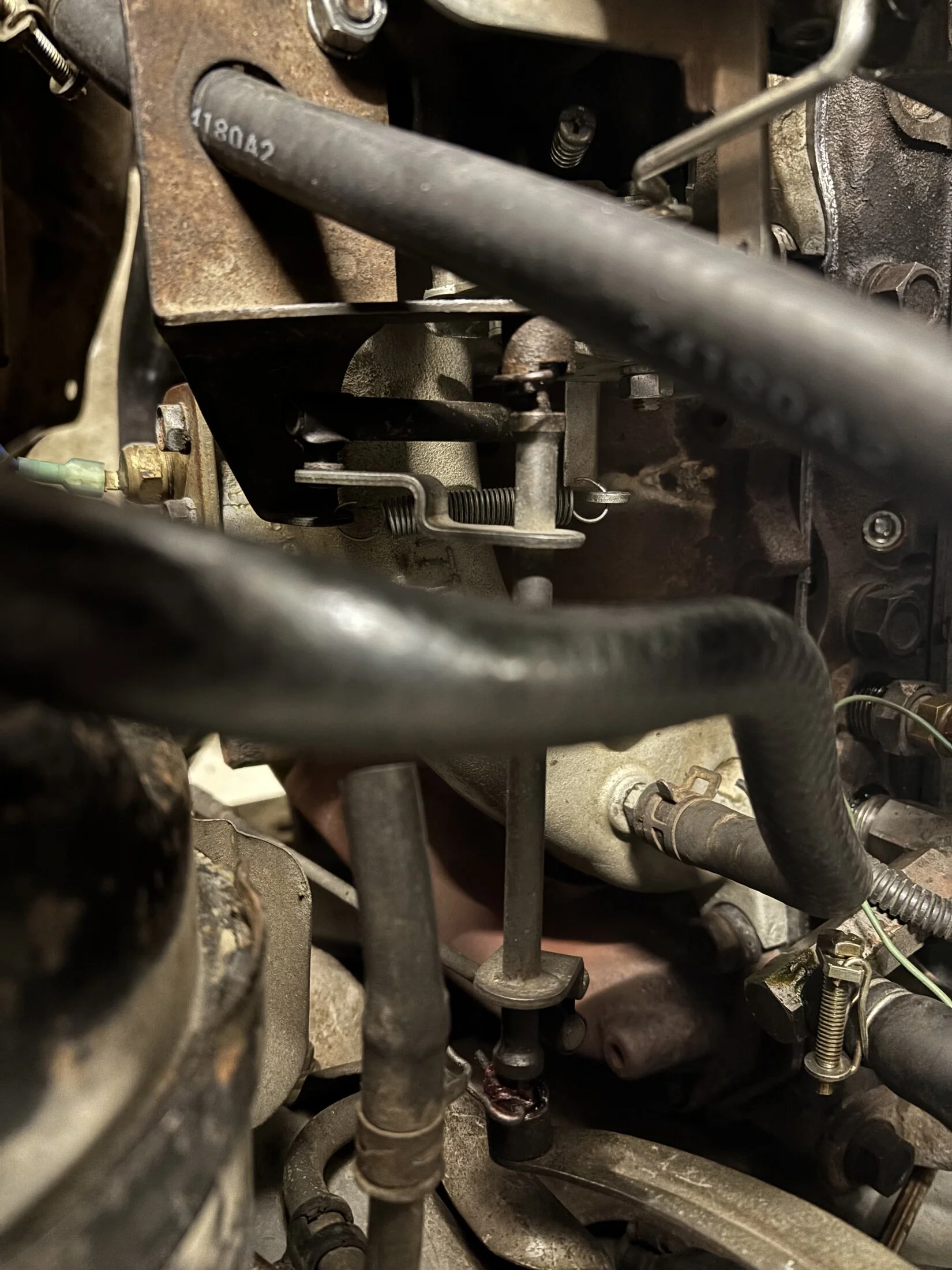

I have another question. Is this what my carb is supposed to look like at rest? I feel like the blade being altogether vertical is a problem? I can close it but I have to turn the choke mechanism counter clockwise 90 degrees. It’s spring loaded so it goes back to the picture.
