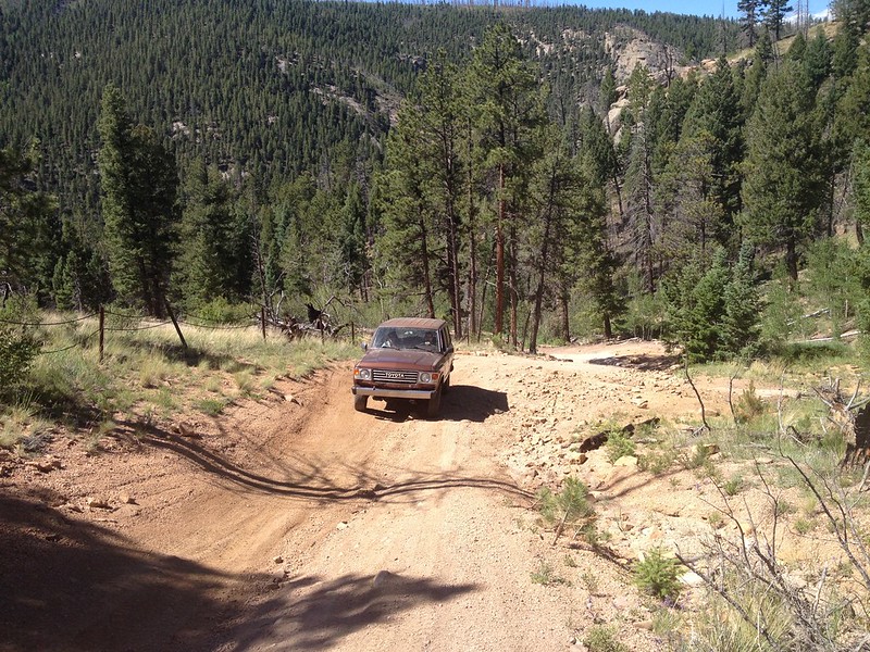

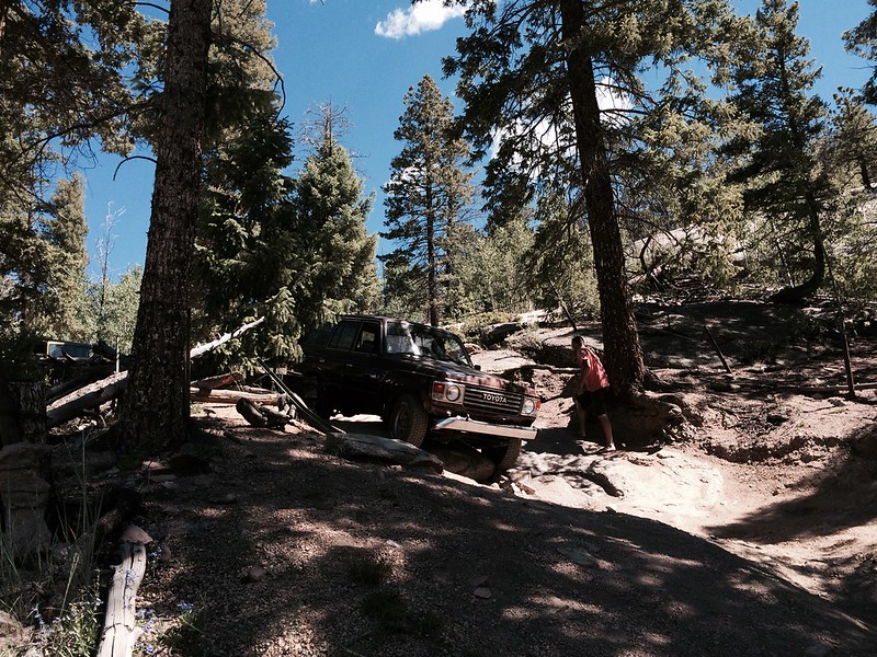

It didn't take long to start stretching her legs. Out we go- maiden voyage out to Hackett Gulch.

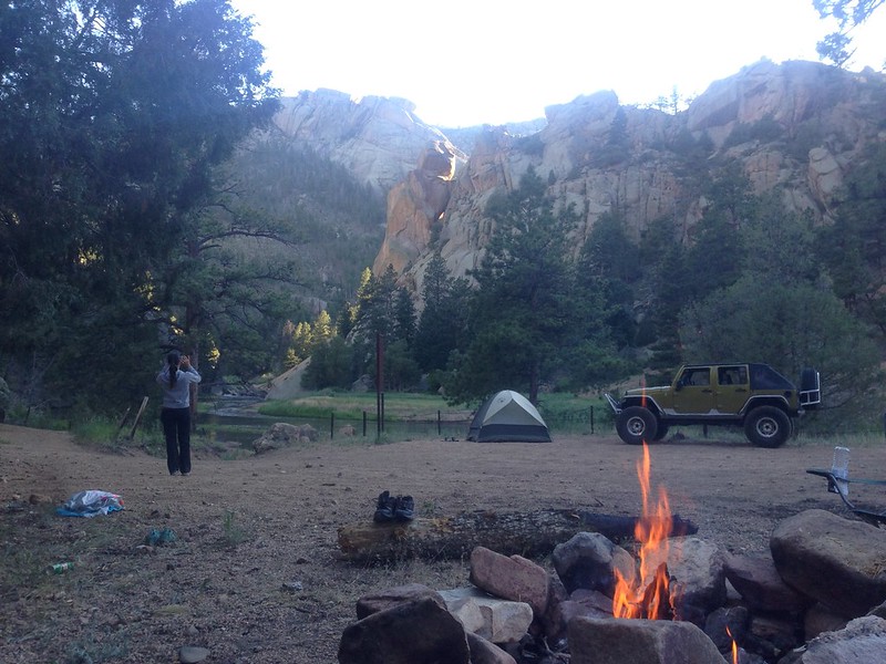

Here's the sweet camp spot right on the river... and boy was it cold!

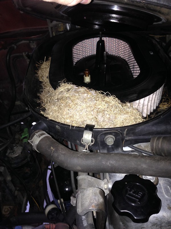

Anyway, after we got back from the gulch I finally turned a screw driver on her. I popped the Air cover off to see how much dirt I'd collected from the trip and I found this.
And so it begins.
011408c6677553247afcf7611ac8139bf2e3f9aeea by farz_fj60, on Flickr
love the nest, and the rig and the camping spot
dougbert
I've lived in my 60 for a while, looks like somebody lived in yours for a bit also.

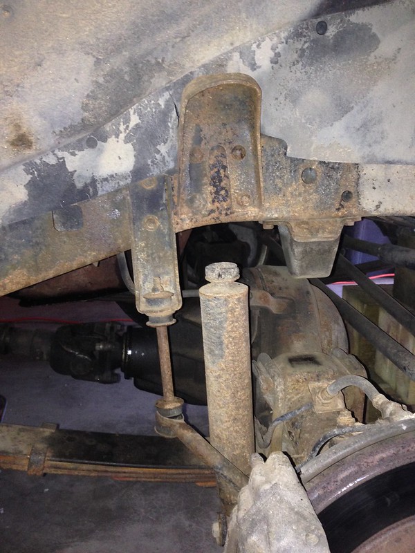

So I started pulling the bouncy bits and axle from the front. Thank god for the impact gun! It would have been murder without it.
Pulled the tires and I have to wonder how long the front shock has been in this condition. I think they are the Toyota originals.

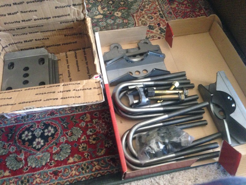

Got few parts in.

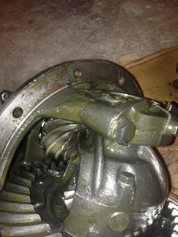

Pulled the 3rd and surprise number 3. Floaters!!!
01df89af2f6aed5c1514fccb49df76c1235bf02078 by farz_fj60, on Flickr
Right on, diving right into the deep water! Are you planning on re gearing for bigger tires?

I am actually that's why I hadn't really looked at the condition of the 3rd until this morning. :cool: My buddy has a couple 3rds laying around with 4.88's and budget lockers! :bounce: Bigger tires are coming as much as I will miss these 30x9.50's haha!
Generally it's the axles that are full floaters.....not the shocks.
