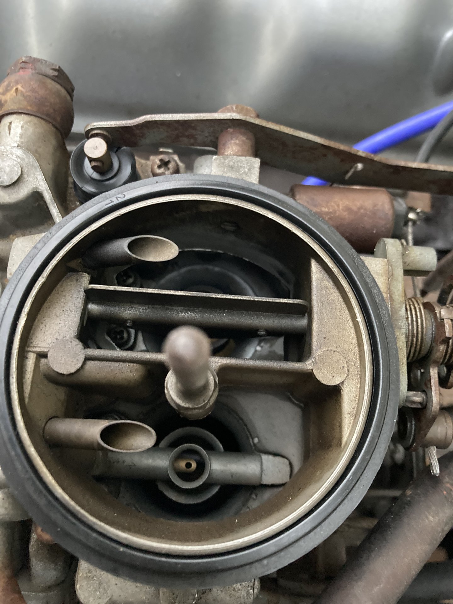

Air cleaner housing off. I have sprayed almost an entire can of carb cleaner around the entire intake manifold, base of carb and carb itself. I am getting nothing. No decrease in RPM anywhere. I have checked the choke linkage 4 times. Unless I am missing something ( which is entirely possible) linkage is ok
Can you peek down the carb barrels while the engine is running? Both butterfly valves closed?
Running..
@cbmontgo I started from scratch adjusting the carb….got summoned to the table for Thanksgiving dinner right in the middle. Now I have to watch the Egg Bowl. Good luck to your Rebels. Busy tomorrow so I hope to get back into it Saturday morning.
To me it looks like the primary butterfly is open at idle, which I do not think is correct. Hopefully someone more experienced can chime in.
At idle I believe the fuel is drawn through a passage below the primary butterfly, adjusted by the idle speed screw.
Does pulling up on the pedal decrease the idle? I know you checked the linkage.

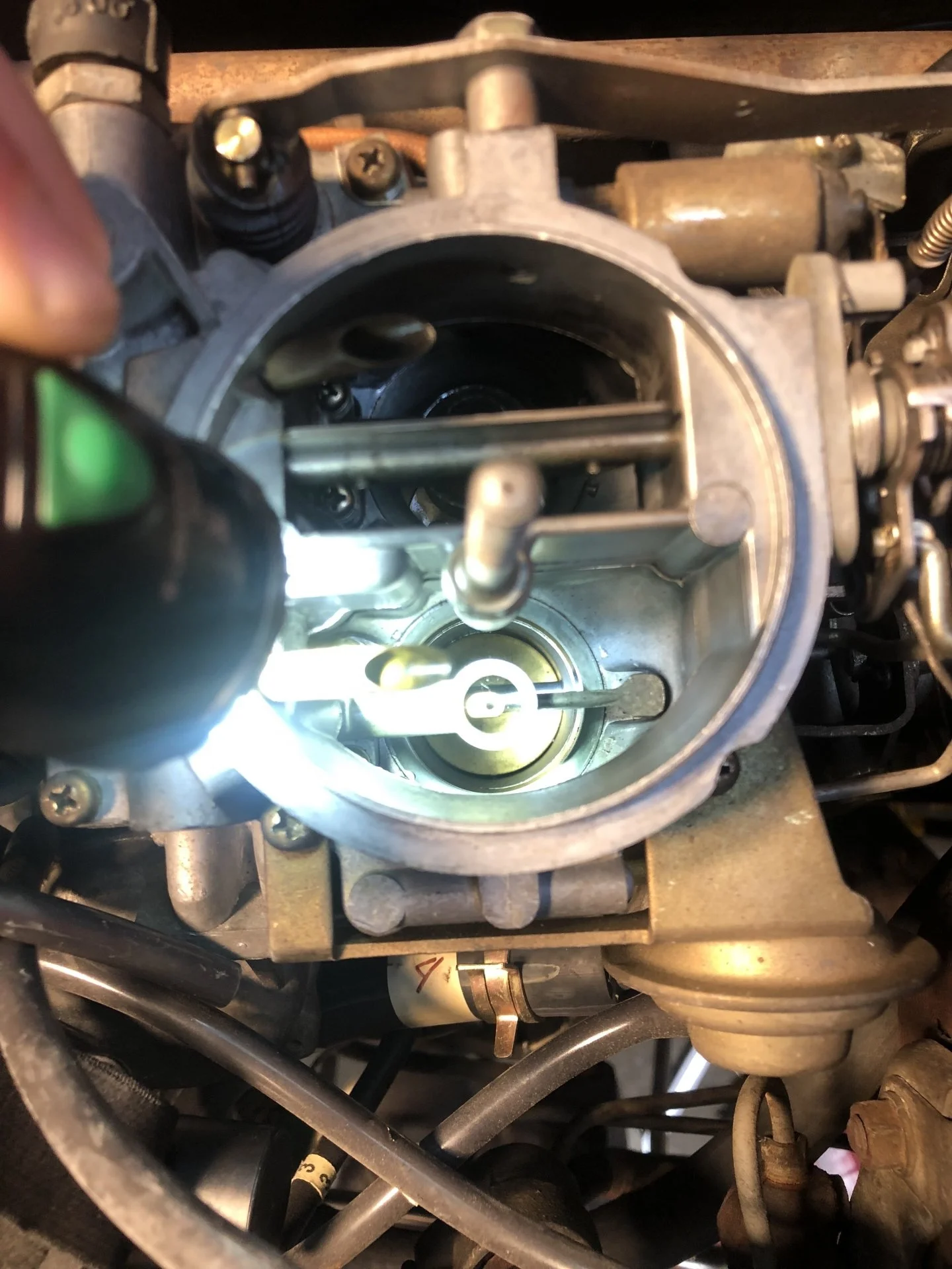

You know I think I’m actually seeing the Venturi.. not sure if my theory is correct as I can’t see the butterfly. Maybe get a headlight and look down there.
@OhioFJ …I’ll report back when I’m able to get back under the hood.
