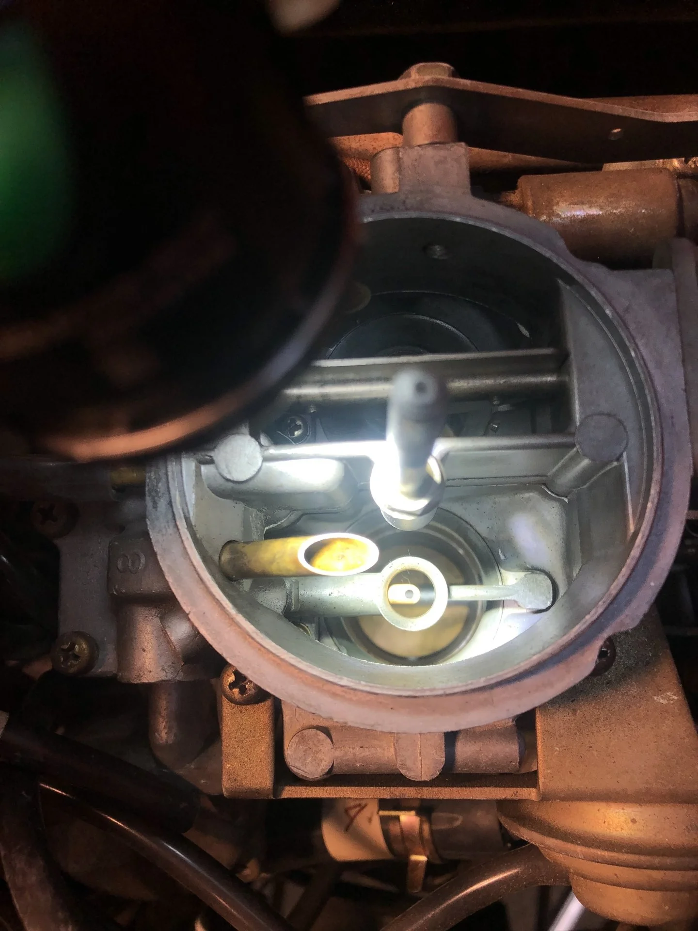

Looking into the carb with the engine off - I noted that the secondary butterfly is not completely closed. With the engine running I can see fuel being drawn in under the butterfly - is this normal? Should the secondary butterfly be completely closed at idle? I'm thinking this is my problem, but can't understand why it was running well and now the change.
I can move the secondary butterfly manually by directly manipulating it - it doesn't seem to be stuck.

First pic - engine off
Second pic - engine running - you can see fuel just under the butterfly (kind of cool)
