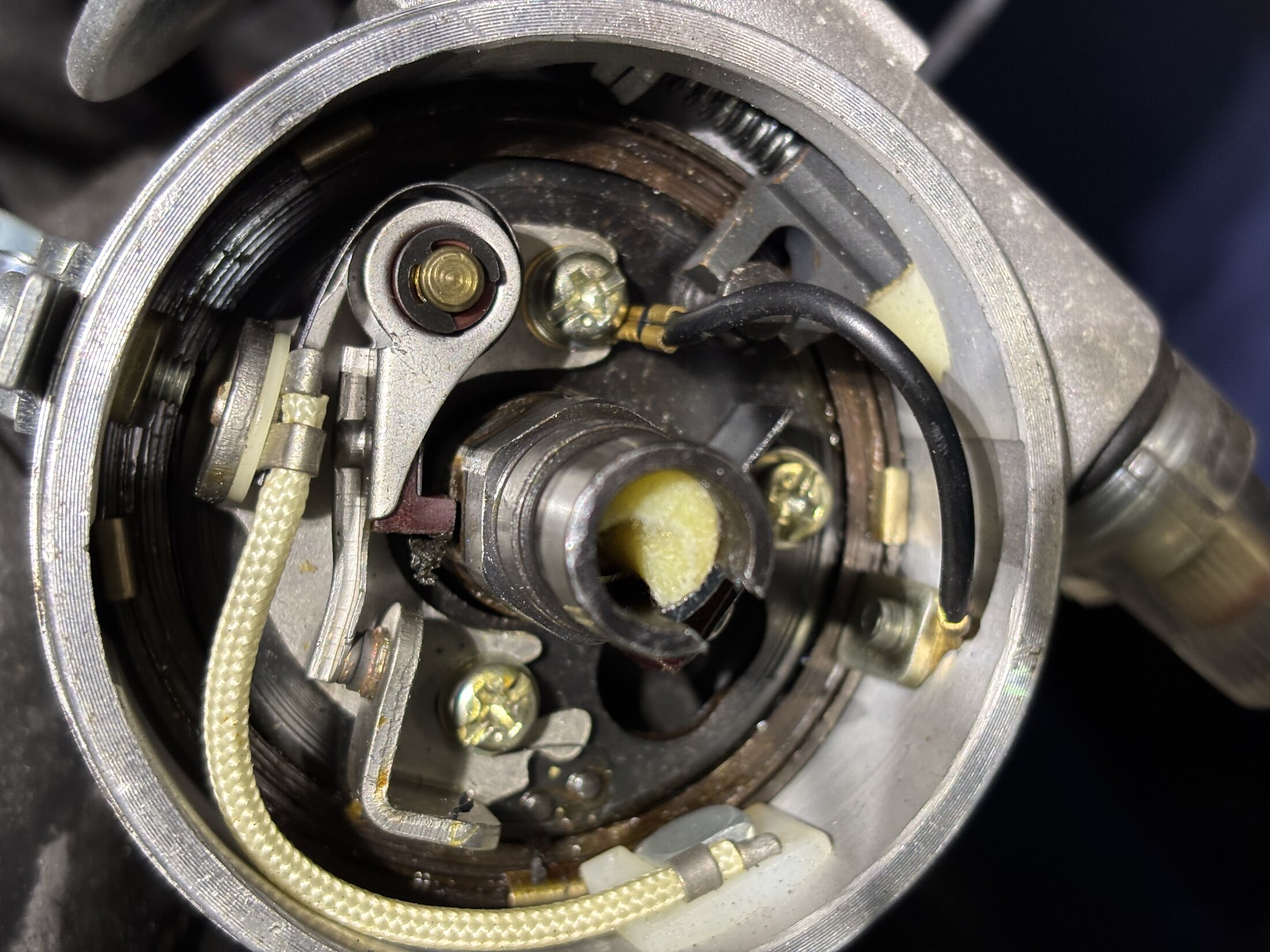

Second that. My new china Delco dizzy ran fine for a couple hundred miles. Then the rig started running a little rough. Adjusted the points and then it was back to running good. Another 100 or so miles, running rough again. Looked at the points - they are tweaked out of alignment. Put the old real Delco points and the bigger condenser from wore out Delco in - the rig hasn't run so good in decades.
