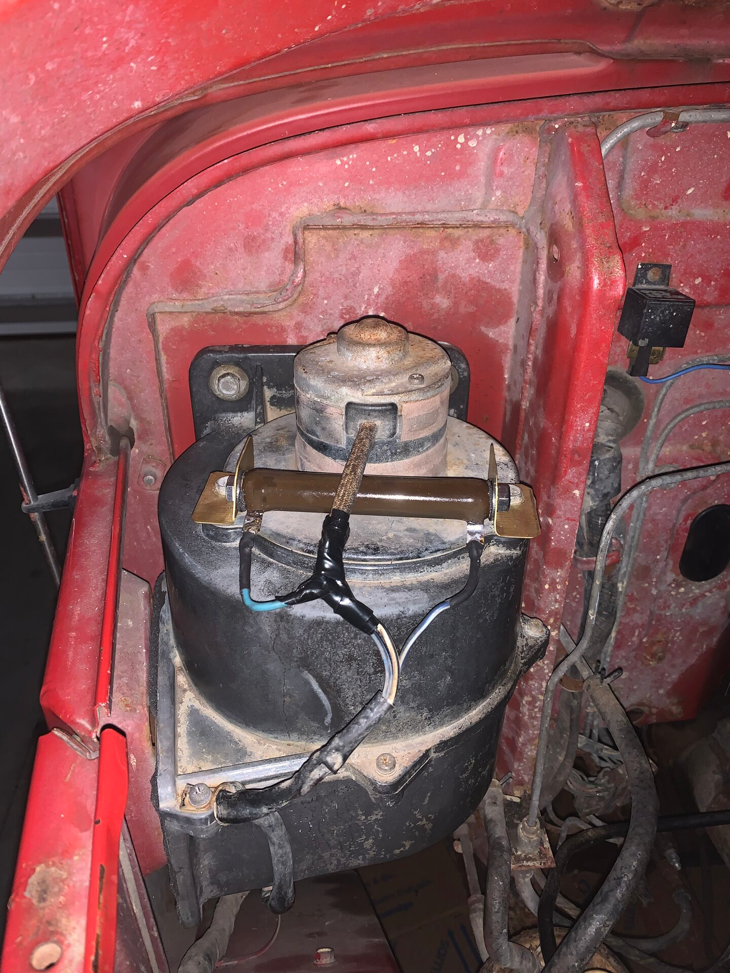

Before I start taking things apart...anyone have this issue before? Is it likely to be the switch OR the fan/motor/blower itself? TIA!
the resistor
Appreciate it...I'll fiddle with mine a bit but looks like CR sells a new resistor for about $100. Thanks!

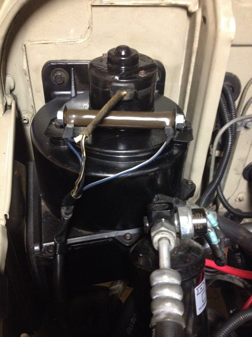

That seems like ridiculous money for a simple part. Anyone know the resistance measurement? That should be available as a wire wound ceramic resistor and a slight cost.
Added later:
I tested mine. In the truck I get around 100 ohms. It is called a tubular ceramic wire wound resistor. Like this Resistor Wire Wound Tubular Fixed 7.5 – 160 Watt – AS ENERGI - https://asenergi.com/en/products/wirewound-tubular-fixed-resistors.html I am not vouching for them. Any old time electronic store should have them for a couple of bucks. A place that caters to audio enthusiasts will understand. You can get them with an adjustable tap. That would allow you to fine tune the speed of the motor. If you get one that its the right physical size, the ability to dissipate heat should be OK.
Mine is 50mm or 2" long. This is my best guess: 100 Ohm 25 W (100R 25W) Power Resistor - Fixed Wirewound Resistors – AS ENERGI - https://asenergi.com/en/products/wirewound-tubular-fixed-resistors/25w/25w-100-ohm.html
I could not figure out the digi-key part #.
@charliemeyer007 found it. DigiKey p/n L50J1RO-ND

Sorry to be a kill joy. One Ohm is not enough, one ohm is about a foot of old wire in resistance. I am almost certain that you need a lot more resistance. The resistance is what determines the voltage drop and the fan speed. My meter was hunting around between about 80 and 150 ohms. I stuck pins in the wires and it was not super secure. Maybe someone know the actual specification.
But check the resistor and see what it is doing. Like others said it could be the switch or a broken wire.
The old resistor is almost certainly broken at one end. You can still probe the wire instead of the tab and determine the actual value of the original part.
What is the value in Ohms for that big old thing? How many watts?
Ohmite resistor - 1 ohm resistance - 50 watts power - cost 19.67
