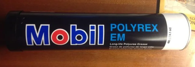

Also, it seems like some sort of grease should be applied to the new plunger? If so, what kind?
Mobil Polyrex EM is what commonly gets used on sliding parts and bearings of electric motors. Not typically found in auto parts stores, but if you have a Grainger or similar nearby you might have some luck. I'm looking around my area to find some so I can R&R the fan and wiper motors in my 62, and also to use in my starter rebuild now that the parts are here. Took 26 years and 300K miles, but the factory starter finally gave up, so I've gotta top off my solvent tank, clean the starter and dive into the rebuild probably tonight after school.

I ordered mine yesterday via Amazon(Grainger) and it arrived today. Don't really need all of this but whatever.
That would have been nice. Not sure what else to use this for
I'd keep it stored for the next electric motor you break open. Never hurts to put a little new lube on bearings (grease for ball bearings; but sleeve bearings may require something different). I'll eventually R&R my blower and wiper motors, depending on the condition the commutators are in when I get to them, so I'll have a little more use for this stuff. Certainly not enough to use up more than just a fraction of the tube, but I'm sure I'll find more uses in the future.

That Polyrex EM seems to be pretty good. I used it on the gear assemblies, bearings, and put a thin film around the body of the plunger in hopes of preventing just what you're dealing with. The tube was $5 after tax at the local Grainger. Out of 14oz, I probably used half an ounce, tops :hillbilly:
