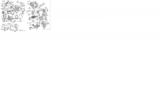

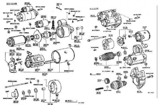

Here are the Toyota part #s for a starter rebuild.

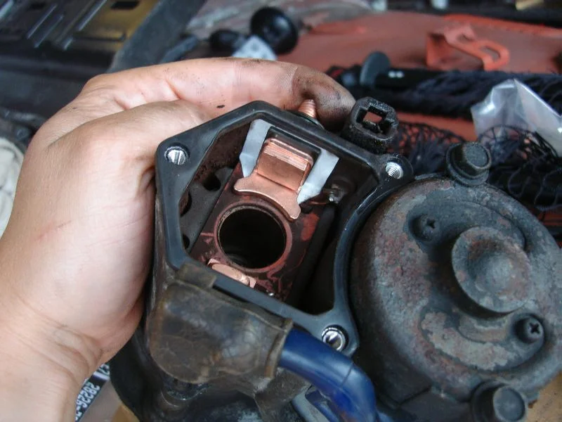

Went to local Toyota dealership to get contact parts.
Could order; get in a few days.
BUT on-hand they carry 4 slightly different contact sets.
28226-74070 looks like the above pics for the solenoid to starter motor side.
$ 12.89
Fits & works like a champ.

So I'm in the process of replacing the contacts in my 99 4Runner and everything has gone fine so far. However, I only purchased the contacts and not the entire kit...so I do not have that paper that goes on the right side contact. Not to mention when I took the starter apart, the paper that was there was on the outside of the starter housing and not on the inside like described in this write up. Should it actually be on the inside of the housing...oh yeah, and what is it for. I have a funny feeling that I wont be able to purchase just that paper piece.

The starter on my 62 had been clicking occasionally. Parts were $48. & change from American Toyota; took only a few minutes to pull the starter, and a few more to remove and install the new parts... piece of cake.
