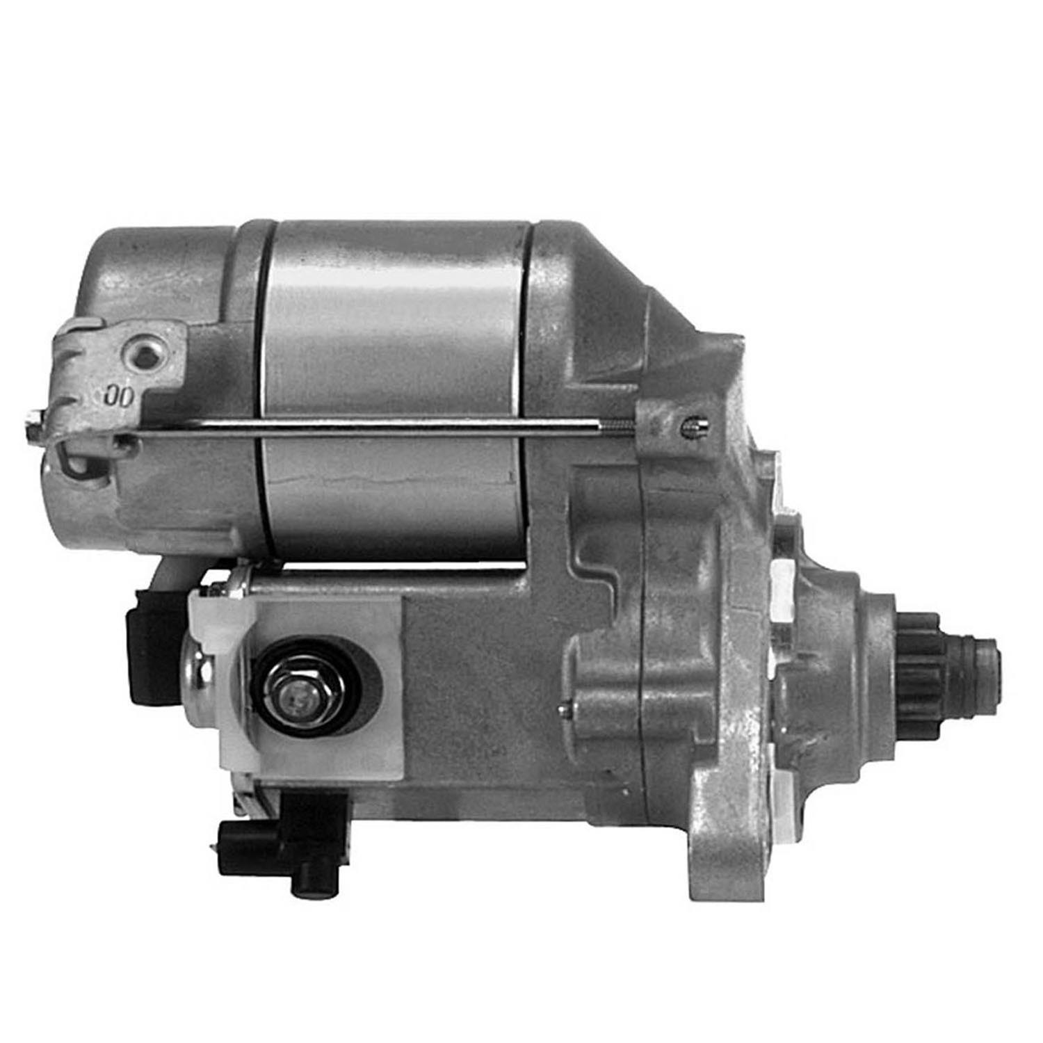

Hope I’m not highjacking a thread here, but I’m looking for help identifying a starter and maybe finding new contacts.
I have had this 1980 HJ45 for ~9 years now. The starter has always been weak, and drained batteries faster then I would expect. I’ve had the unit in a rebuild shop, and he told me nothing was wrong:(
I have suspected the wire from the motor to contacts was lose/poor connection. It smokes, gets hot, and has melted all the insulation/tape on that wire. i have tried tightening it wail on the truck, but it doesn’t help and it’s hard to reach. I removed the starter and found the terminal very corroded and it broke off when I tried to tighten it.
Does this look like an H starter or 3B? My bell housing has 3holes and starter only has 2
