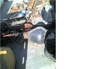

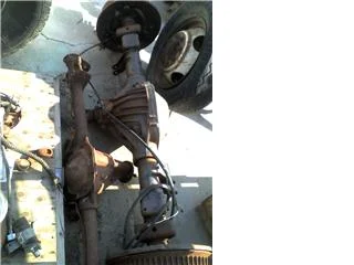

Ok Mace today at lunch I found this 14 behind a local parts store. The store owner told be I could have it for $200. It has very little rust-looks fairly new. He told me He will have it ready for pick up this saturday morning. I havn't seen a lot of 14bolts but this one is ribbed on the housing. Does that mean anything concerning? if not I have my rear axle

What is the WMS on that 14 bolt? (just make sure it matches)
14 bolts are typically dirt cheap..
The one in my rig I got for $50
I also gave one away not too long ago..
Those ribs are odd. But from what I understand they were just extra support
The ribs are the newwer 14bolts not sure when they started but my buddy has a 99 3/4 burb that has one. I could save ya some money on the retubbing, I have a doubler kit set up for a Ford 205.
i measurd 3 14bolts today. they were all 54" from the inside of one drum to the other.
How can you save me some money on the retubing with the doubler kit?
WMS is based on the wheel mounting surface. And, on a 14 bolt that is defined by the hubs. The axle shafts are all the same length..
