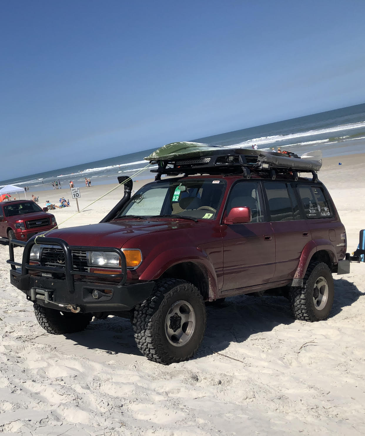

Looking for input. I have a 1996 80 Series with 412,000 miles (original engine and original transmission). I have a budget of $3K. I am looking for input on what I should do to keep my 80 going strong so I can have confidence in it to take long trips. I am not talking about Overlanding mods. I am talking about making sure the vehicle is mechanically strong and upgrades that will increase performance/efficiency.
Here's what I have done so far:
Fixed all leaks.
Valve Cover Gasket
Replaced all hoses and vacuum lines.
Replaced all belts 40K miles ago
New EGR
New Alternator
New power steering system
Fixed minor rust and repainted entire vehicle
Dual Battery Setup (2nd Starting battery)
Rear (House) Battery Setup with Redarc BC/DC Charger
Old Man Emu Lift and shocks
Mud Tires
Rear Axle Seals
Front Axle job
Heavy Duty Front Bumper w/ Winch
Heavy Duty Rear Bumper with Tire Carrier
Roof rack
Awning
LED Lights
Rebuilt Transfer Case
Fitted Seat Covers
Other cosmetic items.
What should I do to the vehicle or at least have inspected? I live in Florida and I want to feel good about jumping it and driving 10 hours to the mountains or cross-country out to the desert. View attachment 2435979

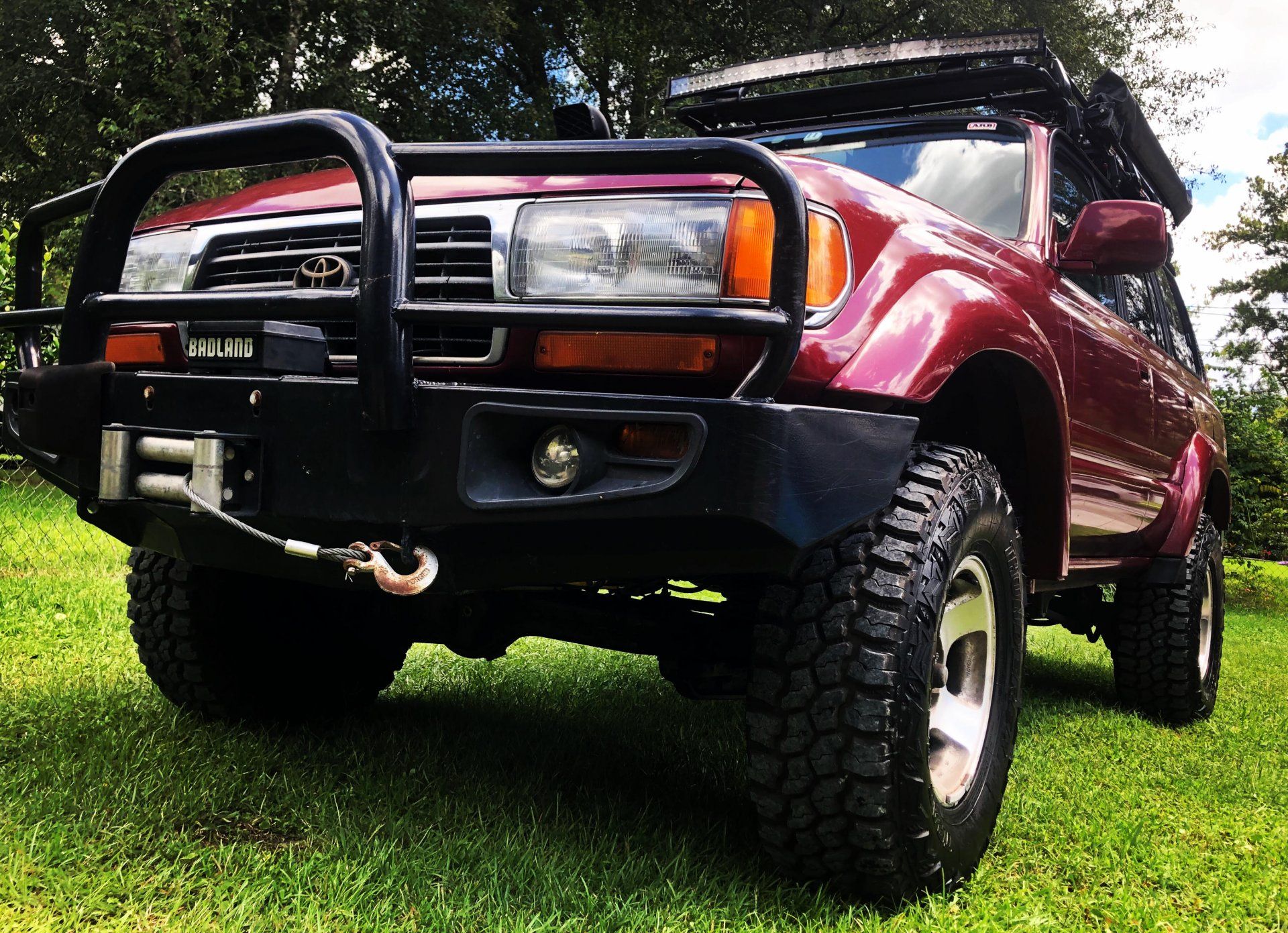

How do you like your 12K Pound Badland Winch? I have one and I think it is great for the money. I am going to swap the cable for the rope they now carry.
I like my Badlands Winch. I would not go smaller. The downside of this brand is the duty cycle is VERY low. It can pull for 45 seconds, then it has to cool for 2 minutes. I have pretty much only used mine for pulling down trees or similar because I don't push my wheeling to the point of needing it, as I am too old-school, and, it's my DD.
The rope will be lighter, but you have to make sure it stays dry. The manufacturer states you must dry it out within 2 hours or it may mold and rot.
I'm also supposed to clean and lube my steel cable every month and do a controlled pull to rewrap it. I have yet to do that on any of it and it has been on there for 5 years. I spray PB Blaster on it every so often when I think about it.
This winch will drag my truck across the lawn and across pavement (I pulled the local tandem axle dump-truck snow plow out because he's an idiot)
Yeah, I almost bought the 12,000 lb Badlands until I saw that the duty cycle is 45 seconds then almost 15 mins of cooling.
