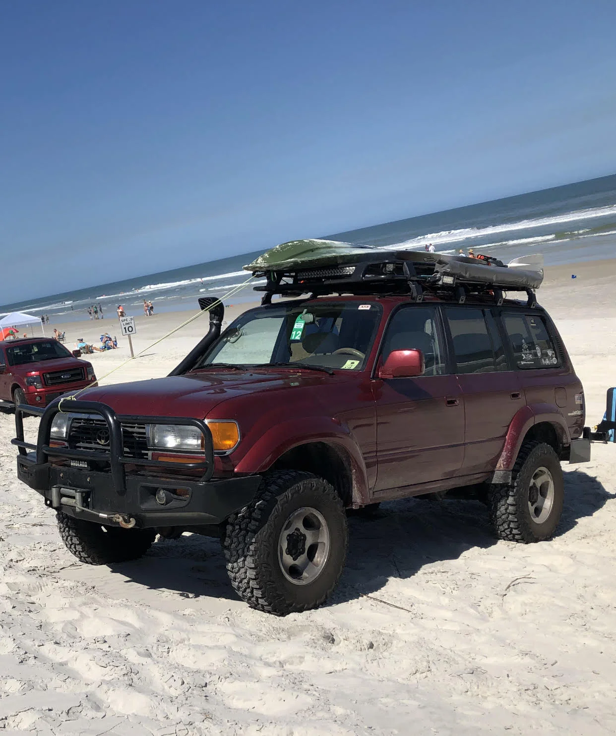

Looking for input. I have a 1996 80 Series with 412,000 miles (original engine and original transmission). I have a budget of $3K. I am looking for input on what I should do to keep my 80 going strong so I can have confidence in it to take long trips. I am not talking about Overlanding mods. I am talking about making sure the vehicle is mechanically strong and upgrades that will increase performance/efficiency.
Here's what I have done so far:
Fixed all leaks.
Valve Cover Gasket
Replaced all hoses and vacuum lines.
Replaced all belts 40K miles ago
New EGR
New Alternator
New power steering system
Fixed minor rust and repainted entire vehicle
Dual Battery Setup (2nd Starting battery)
Rear (House) Battery Setup with Redarc BC/DC Charger
Old Man Emu Lift and shocks
Mud Tires
Rear Axle Seals
Front Axle job
Heavy Duty Front Bumper w/ Winch
Heavy Duty Rear Bumper with Tire Carrier
Roof rack
Awning
LED Lights
Rebuilt Transfer Case
Fitted Seat Covers
Other cosmetic items.
What should I do to the vehicle or at least have inspected? I live in Florida and I want to feel good about jumping it and driving 10 hours to the mountains or cross-country out to the desert.
