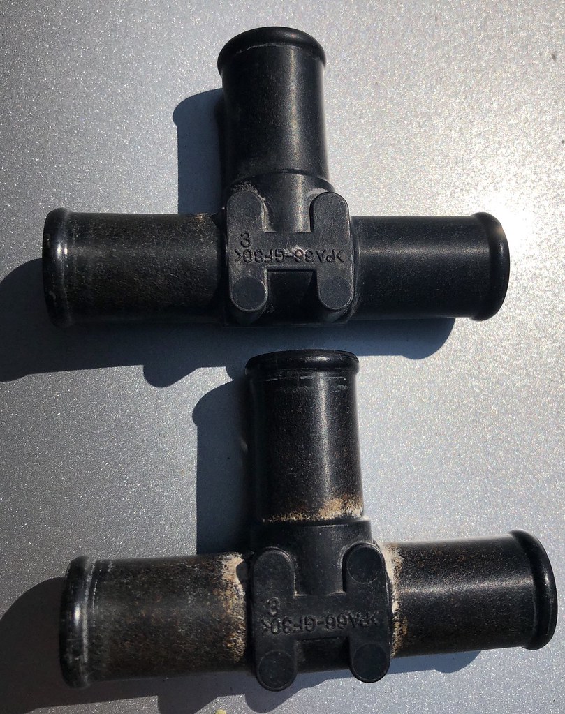

So this thread made me curious on mine as it just passed 200k and I had a set on hand so swapped them out. The originals looked aged but were still quite intact. I think with proper maintenance the T's on the 200s seem to do a bit better than the 100. I know mine looked a lot worse when I changed them on my 100s. Part of it may also bee how the vehicle is used and how hard and how often the cooling system is pushed.
Pull the T out of the old hose and compare the measurements to a 100 series T: are they the same specs? Same part?
Markings on the T - PA66-30GF= (Nylon 6-6 with 30% Glass Fill). You might see swelling over time but heat and cool cycles will affect plastics chemical properties over time.
Those T’s at 10 years look pretty damn good, some drying but not discolored badly. The T from a 100 series at 10 years would look washed out rusty red color; which my guess is due more to heat than anything, not the type of coolant. Still a prudent idea to replace at this interval IMO.

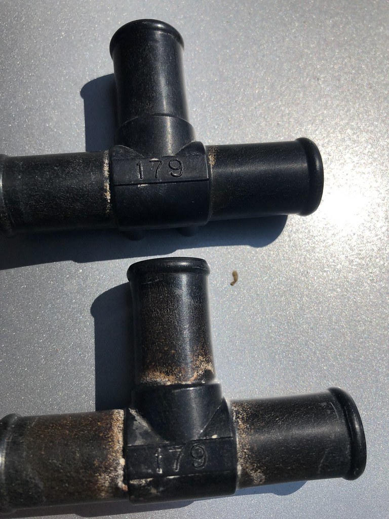

I agree they did look good. Ali's ~10yr old tees, look more like my 01LC at 165K miles and 16 years. Whereas all 06-07 tees I've done have not looked as good.
Interesting, the original 200s factory tees and the alternative (sub PN #) replacement tee had identical marks "179" just as @Ali FJ80 picture above shows. But the OEM Toyota supplied Tee assembly (with hoses) had a different number on tees.
