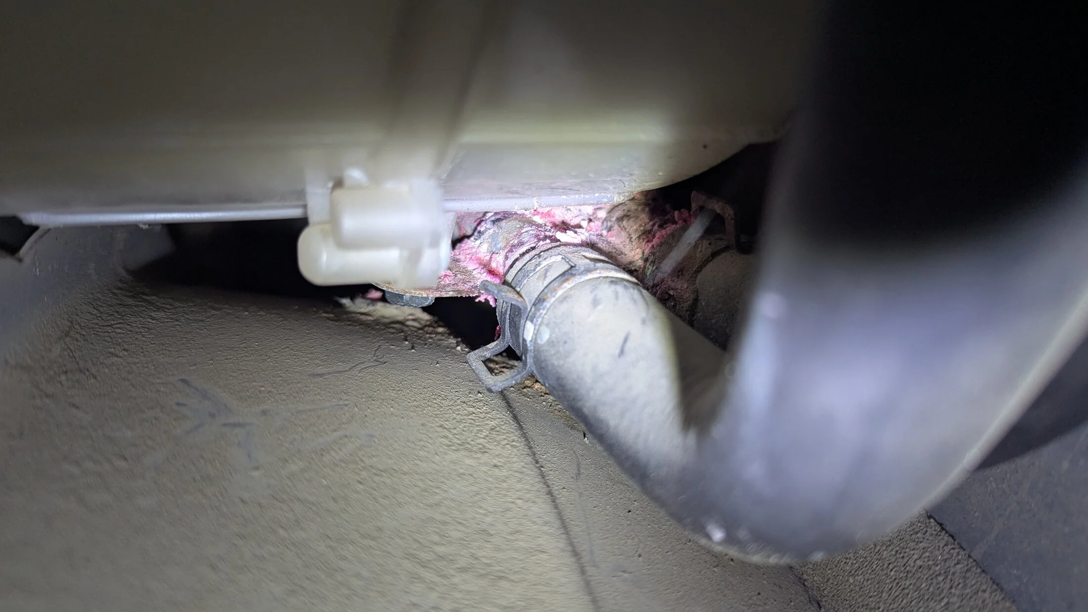

Hello all, I have a 2008 LX570, and I have what appears to be a small leak (probably for a while now) - I removed the rear seat and inspected in behind the panel (Driver's side rear)
There is dried coolant on both hoses at the point that they connect to the rear heater box.
I'm afraid to pull the rear heater box because it looks very complicated and I don't want to risk breaking anything, that being said, has anyone had this happen, and I'm wondering if anyone has had any cracks in the actual rear heater OR perhaps not? I don't use the 3rd row anymore so not sure I'd even need this, but regardless it would be nice to stop this leak
Should I start by just replacing the hoses and new clamps?

Use a toothbrush and clean up the clamp on the right. It looks oddly corroded, but it could just be dried coolant. If it’s bad, it would cause the leak.
So I ended up removing the old hoses and installed some new ones. I also used new clamps. These were a bit hard to remove given the location... Took a few hours to complete given I had to remove so much other stuff to simply get to them. It was a pain.
Anyway, hoping it holds better now. Will monitor and update if any further issues.
I take it you went looking as you were loosing coolant?
That sure looks like a very very small leak. Is it still leaking somewhere else?

No, mine is still losing coolant. I went to re-check the work I did on the rear heater, and I think it's still leaking. I think the rear metal inlet hoses are bent (were like that prior to me purchasing) so somebody monkeyed around with it previous to me getting it. Strange, as it was a one-owner, and always dealer serviced.
Anyway, I'm not 100% sure this is the only point of coolant loss. Perhaps it is... Might need to run a pressure check etc. I already changed the rad cap a few monthsa go (new). it's still going through a small amount of coolant, but not sure it's worth me fussing about at this time, given the fact that I just top it off once every week or two with a small amount (It's my wife's dd).

I was having a prior AHC issue, and the mechanic (at the time) removed the rear seat and pulled the panel off b/c there is an AHC computer back there (for diag purposes). That's where he noticed the leak. It looked like this
