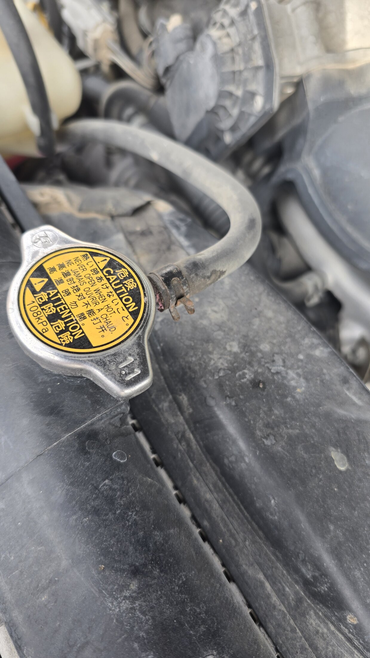

Noticed a little dry pink antifreeze at this location. I don’t remember if there was a hose clamp there or not.
No, from the factory there’s no clamp there. I run two zip ties in opposing directions there for extra nerd factor.
Exactly what I do.
I added a small hose clamp. Didn’t think about zip ties. Good idea.
I must have put a spring band clamp on mine.
Boy, that looks OEM to me. I believe the folks saying there is nothing from the factory but that perfectly sized little spring clamp looks like what it would be if Mr. T did it.

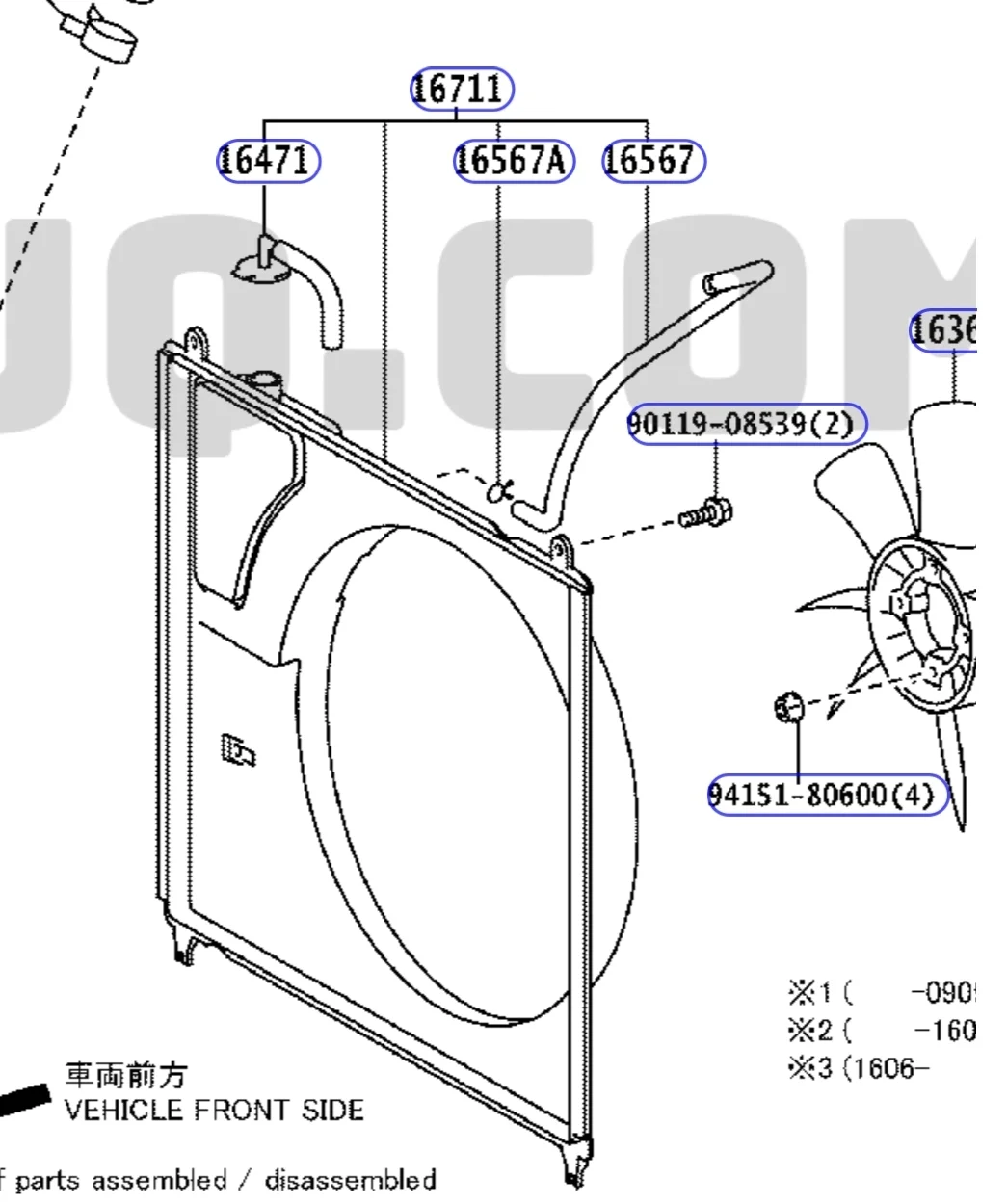

I don't see one on the parts diagram though. There is a clamp on the lower end of the hose though.

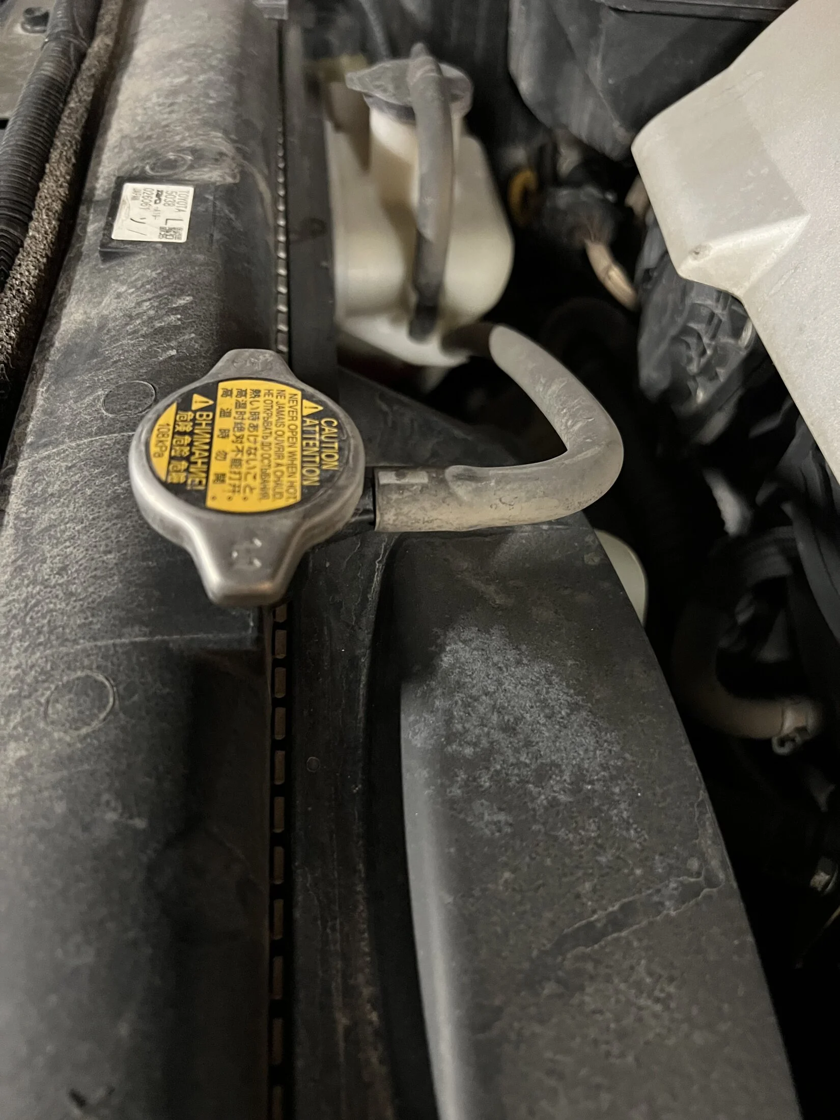

As long as we're doing radiator overflow hose porn...
No clamp on my 2013 LC200, either:

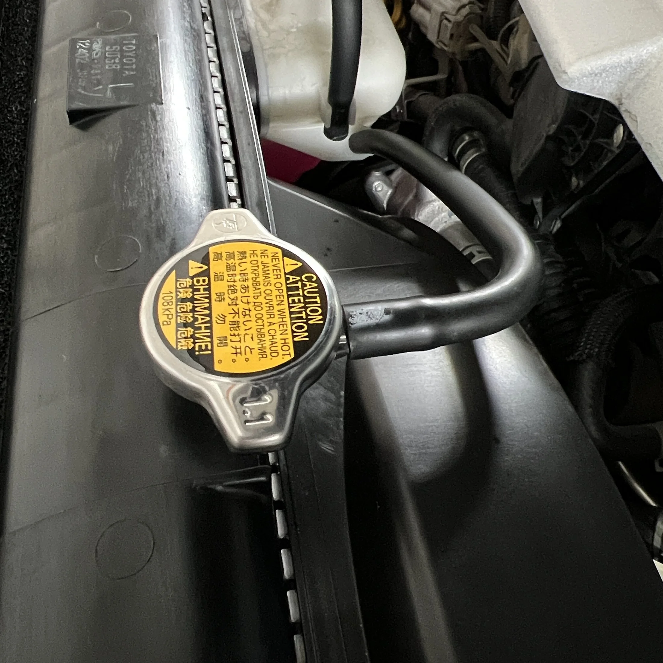

No hose clamp there on my ‘21
