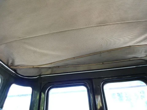

Hi to all,
My headliner is coming down as you can see in the pic.
My question is: how to fix this? Just fold it back, use spray glue and put it back? Or is there a better/easier way to do this.
I have 3M Super 77 Multipurpose adhesive spray. Is this glue good and/or strong enough to fix this? Or do you recommend another glue.
All advice is welcome.
Rudi
I re-did my 40 headliner a decade or more ago using CCOT headliner material. Took the top off the 40 & was able to apply it upside down, which is the only way I would attempt a full headliner install.
Yours on the otherhand...at least from that one pic does not appear to warrant a full headliner restore. I think I would do as you suggest & peel it back, apply some adhesive & press the material to the roof.
I've not used the adhesive product pictured & while there may be better stuff, I am a big believer in 3m products. However, when I did mine, I went to a local upholstery shop & bought adhesive from him. He convinced me the product he used was better. And he wasn't really trying to sell me his stuff. He didn't even have a way to sell it. He just poured some of his adhesive into a bucket & charged me a small amount. But I bet your 3m stuff would be fine too.
Is that the only area that is coming down ??
John

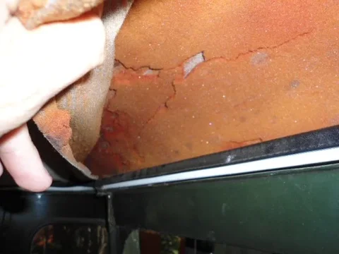

my stock original headliner was sagging b/c of moisture coming in through a corner.
I tried super 77 and super 90 and they didn't work so well. The foam backing on the headliner and bits stuck on the fiberglass prevented a good adhesion.
I just ended up ripping the headliner out, to be replaced another day.
77 is a good product.
You may be able to temporarily hold it up, however, it's falling down because the foam is degrading... As it deteriorates more, it'll fall down more/again.
I replaced mine with a stretchy fleece blanket... Cheap, easily replaced, looks decent. To do it over, I'd buy a nicer one (rather than a $7 one).

I peeled a piece back and found that the haedliner consists of 3 layers with foam in the center.
The foam is crumbling so the whole headliner is falling apart. Time for a roof resto, so next week is headliner shopping-week!

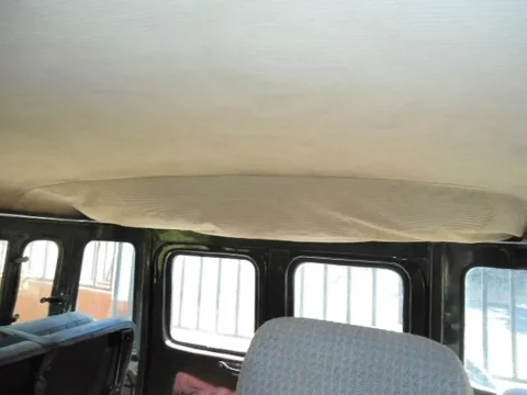

Bamboo to keep it up
The headliner is coming down every day a few inches more so I had to find a solution to keep it up for a few days.
I walked over to the empty lot next door and cut a few braches of bamboo and see...... This will keep it up till I'm ready for it.
Rudi
Simple... :D
