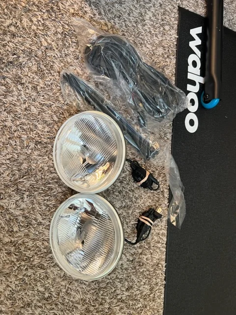

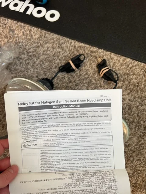

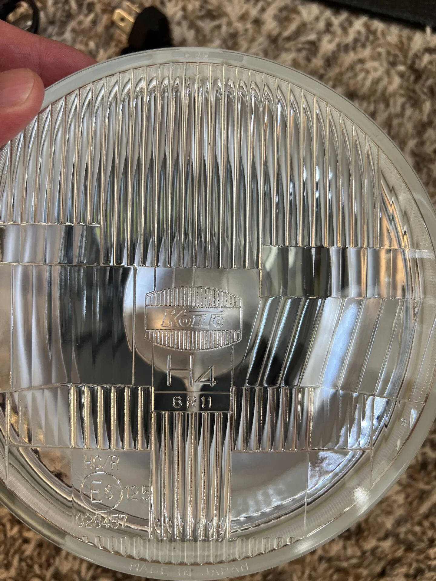

I inherited a set of Koito 8000k with the wiring harness. Not sure I am going to install them. Worth $100 + shipping?
Koito 8000k?
I’m confused, are those halogen or LED? You said the light temperature is 8000K so that seems to indicate the blinding white style LEDs, but the instructions say halogen…
@CruiserTrash - you are right. I am not sure. I was under the impression that they were the LED, the way they were referred to when the seller said he would include them… but now I don’t know. I will try to figure it out and report back.
Those are sold with Sylvania halogen bulbs. The housings are not meant for LEDs and won’t provide a good beam pattern unless you use halogen bulbs. I really like the Osram Nightbreaker Lasers.
