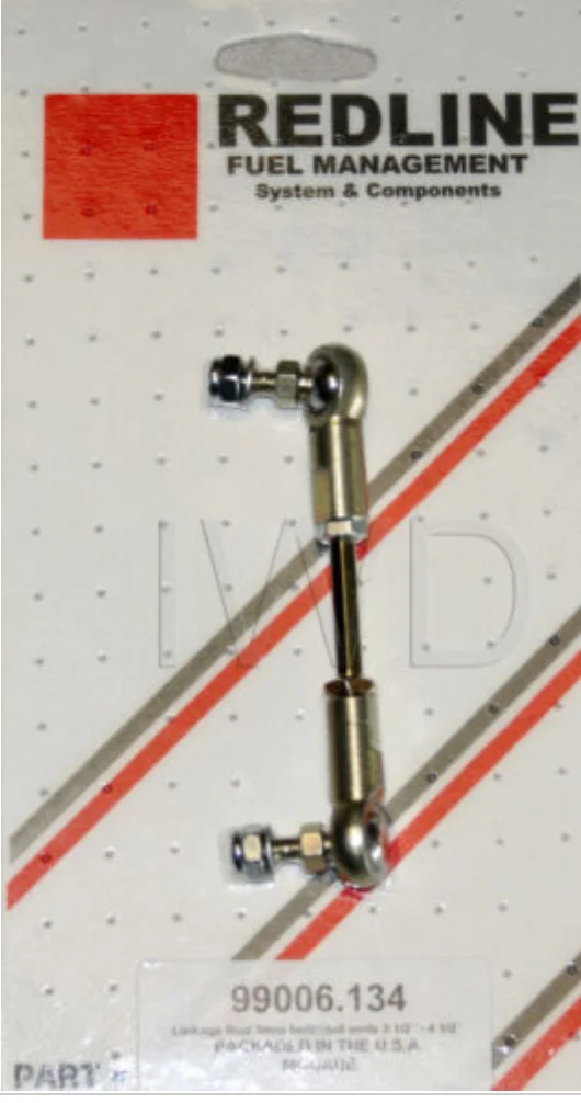

There are a few threads about this, some folks call out the TJM part - (Technical Bulletin TB068) - TJM’s part number 658LINK34E. However I think there are very few if any to be had in US. Anyhow, looking at the part it really is just an adaption of adjustable rod assembly used in for several automobile applications, e.g., thottle body, etc.
I purchased the following Weber Redline Universal carb rod for $26.. with a 2" lift on 33s i closed it down to the minimum 3.5", ~ 90mm. Worked like a charm and if i ever want to go higher i have another 1.25" to play with ;)

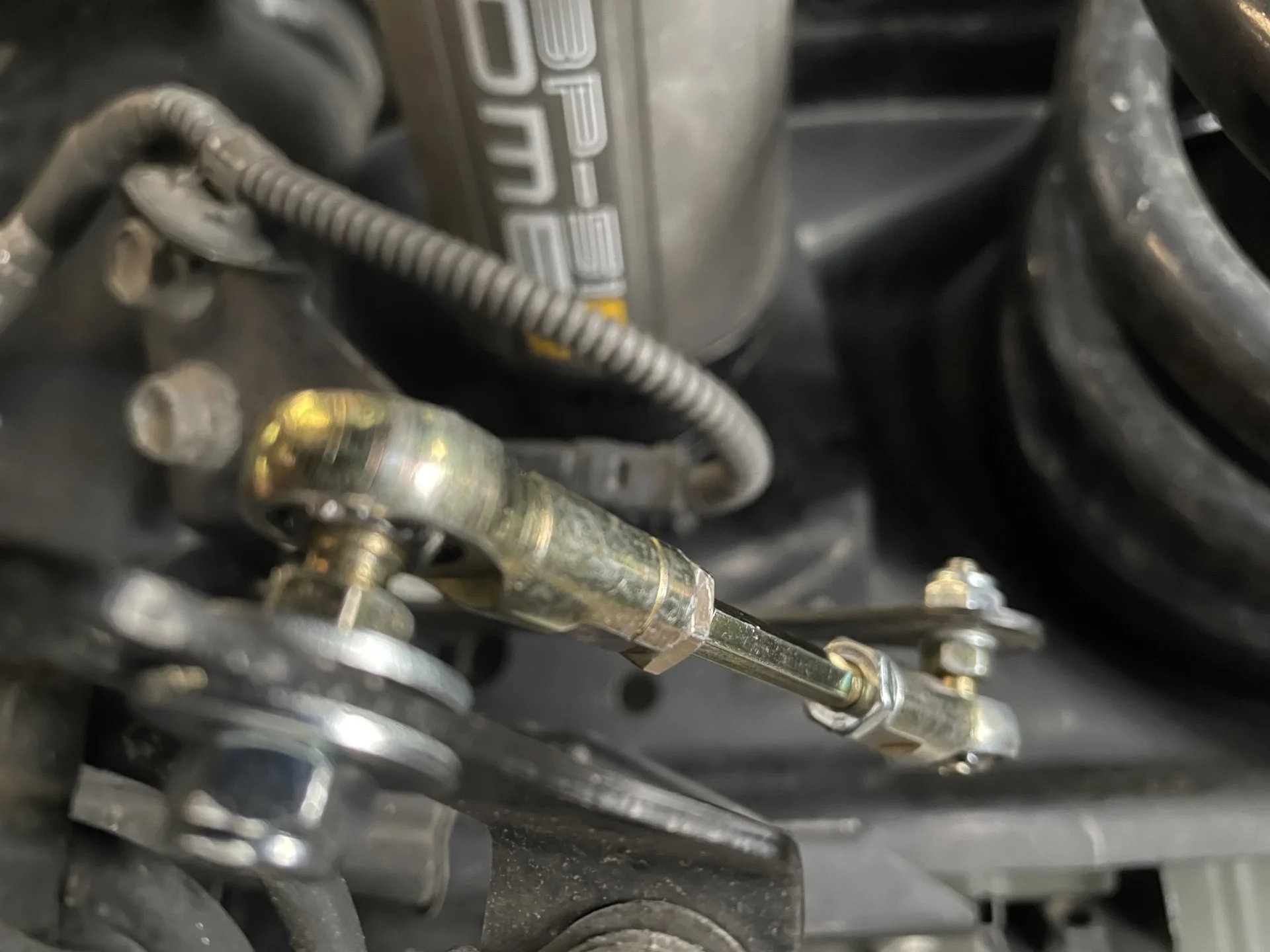

Finished product:
Finished product:
Great tech!
One on each side? Easy job?
There is only one sensor next to the rear shock on the driver side. Very easy job. Just need 10mm open end wrench to secure inter nut and 10mm socket wrens on outside. Took me lest than 15 minutes.

Took fridge out for winter. Not sure what else changed. Started getting flashed constantly. Adjusted OEM bracket in rear which helped but still got occasional flashed.
Replaced OEM lower extension with that carb adjuster rod and no more flashes.

I have a 2018 LC with a net 1-1/2 inch lift and 33 inch tires; I just checked my headlights and then ordered one of the Weber Carb Linkages (3-1/2 to 4-1/2 linkage length) on e-bay. Thanks to @McC13LC for all the great info.
I measured the stock OEM Linkage length to be 2-1/2 inches and with my setup the center of the headlight is at 42-1/2 inches. With the OEM linkage set to max headlight height, the top of the beam against the wall (about 12 feet away) was at 43-3/8 (no wonder I was getting flashed so much). Setting the OEM linkage to min headlight height (1/2 inch slot adjustment) lowered the beam 1-1/4 inches to 42-1/8. So it seems it is about a 2 to 1 height to slot adjustment. According to that headlight adjustment article, at 25 feet from the wall you want it to be about 3 inches lower than a level headlight beam, so with that adjustable carb linkage, I should be able to dial it in to the right level.
