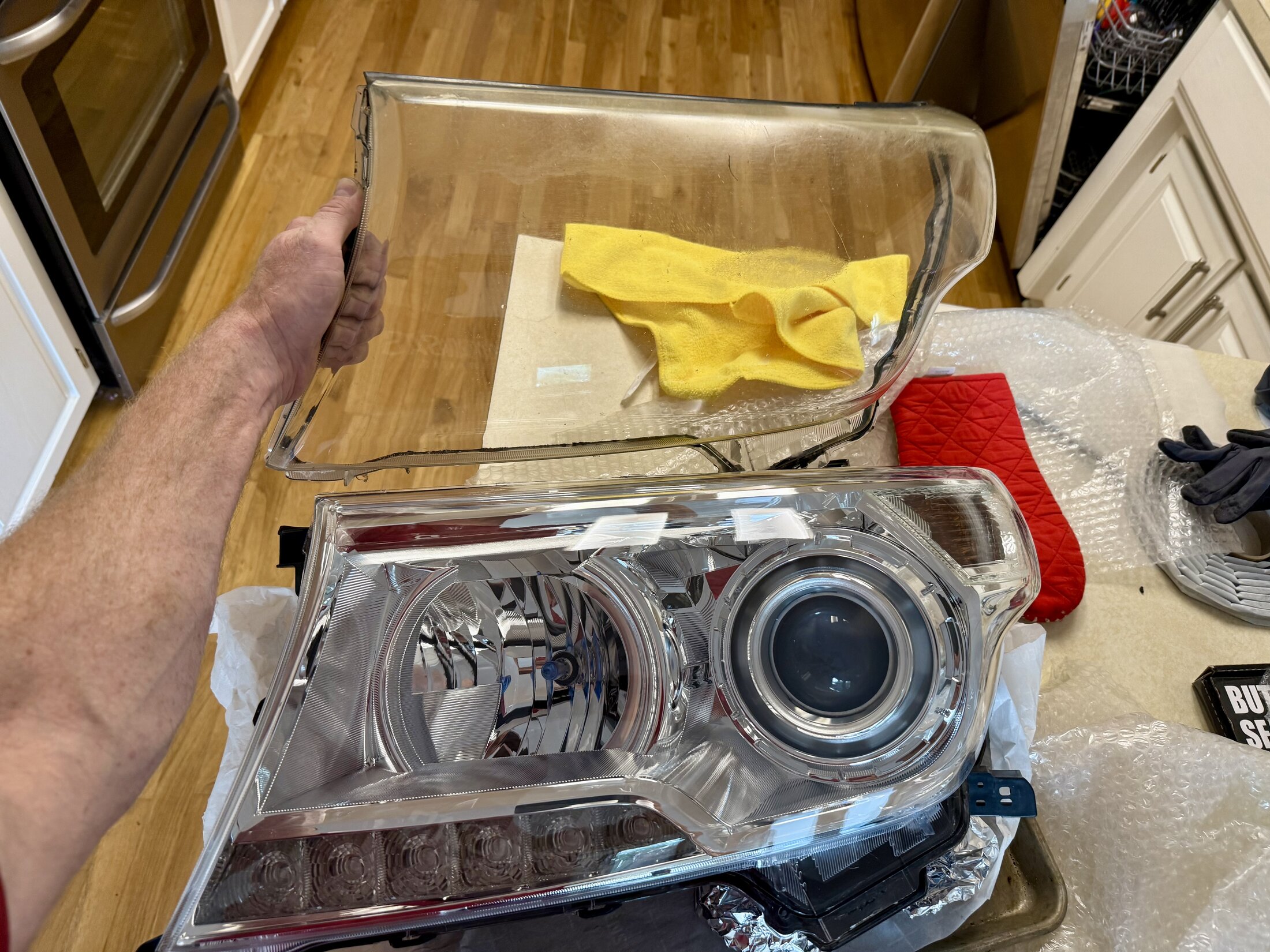

Does anyone know the best way to remove an old protective film (similar to a clear bra) from headlights? I suspect that is what is on mine. Would like to remove + cleanup and then coat with some sort of protective sealant/coating that is not a plastic film.
There's only two ways to really restore oxidized headlights and prevent it from coming back for years: 1) sand down and clearcoat with automotive clearcoat, not some single stage in a can. 2) sand down and polish to perfect and then have ppf applied. Simple as that.
@AZLX570 Steam is the best option to avoid it leaving all the glue/adhesive behind.

Even better, instead of PPF use headlight version than not only protects against the UV and sand abrasion it also protects against rocks impact (it is a LOT thicker than PPF). Mind you the PPF will yellow and age in time (many years) but you can just replace it when it gets damaged.
Removing PPF... use a heat gun at the correct temp - you want to soften the glue, but not too much that it leaves a lot of residue on the lens. For large area (like the hood) some people use a towel soaked in hot water. This gives you an idea of max temperature. Use a high-quality plastic scrapper with a new blade - to clarify, this a plastic blade. You use the blade to start the work from the easily accessible end (usually from the outside of the lens/car). Then make sure you pull/stretch and lift the PPF. You do not want to do the usual peel motion! That will leave a lot of glue on the lens. Watch YouTube videos how to do it right.
Any leftover residue can be cleaned up with iso alcohol, or one of the specialized products. If you failed to follow the best practices described, get ready to have a fight with the glue.
The worst PPF to remove is the very old that started cracking. You will use the scrapper a lot as the PPF is breaking when pulling. Make sure you use a lot of lubrication with the scrapper!
So heat gun for sure and not steam? I would get nervous with a heat gun knowing how expensive my 2013 headlight replacements are.
Yeah, sounds sketchy to me to take a heat gun to something held together with adhesive to prevent moisture
I got my 2013 headlights brand new OEM for about $650 each via a sale. Not cheap, but not outrageous either
Hint: heat gun has a temperature adjustment dial, use it wisely. Basically, you start low temp and increase the temp as needed for separation with minimum glue residue left on lens.
I already mention that your max temp is the water boiling - steam.
You can use steam if you like. But with steam you should keep in mind that once the steam cools it condenses, and the evaporation of condens requires energy, so it will act as a coolant. This is why the guys use a towel instead of steam, as it holds a lot more hot water than just steam - mass is important for heat exchanging.
Heat guns are used in a lot more sensitive jobs than your headlights that are baked merciless in the desert sun. As with any tool, proper use is needed.
