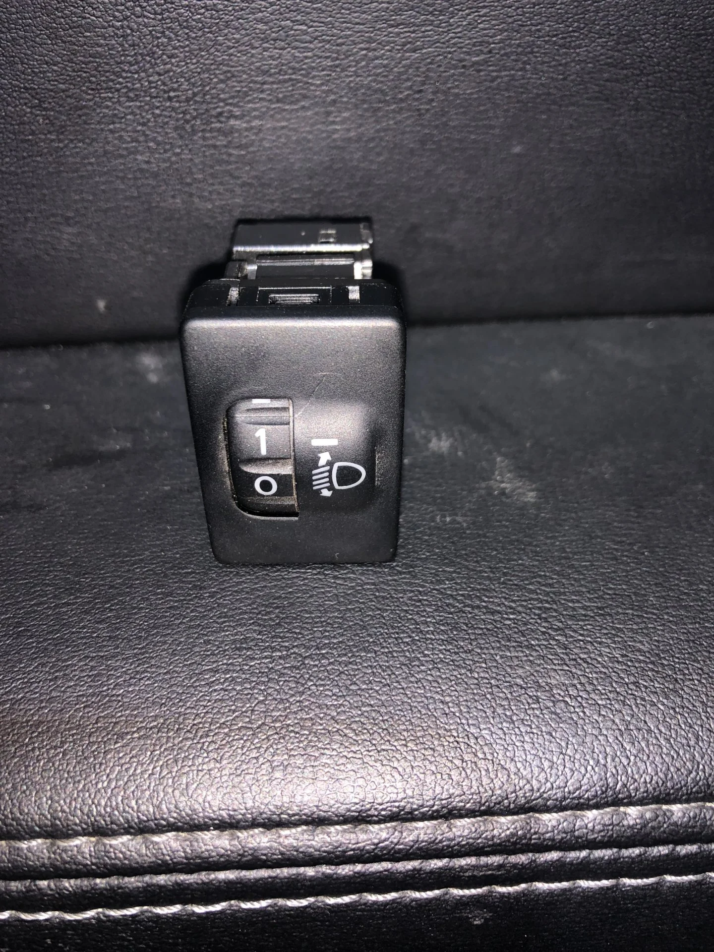

which series, what year for the headlight adjustment knob?
I believe it is all 2008-2015 us market landcruisers. 16+ cruisers got the auto-adjust rod. (Edit: incorrect. Apparently 13-15 only.)
In theory the LX shouldn’t need it with the suspension adjusting to maintain the same front/rear ride height.
It is on the switch panel below and to the left of the steering wheel (or at least was on my '13 LC).
The switch looks like this:
@bloc thanks. BUT where is this simple hand turn knob at, i've looked about, so must be missing it...
Left side near the steering wheel heater and such. It’s a little up-down dial with numbers up to 5 as I remember. For my setup it’s usually about #2, but for open freeway I bump it down to 1.5 for a little extra range.
negative. not there on the 11.
Well crap. Maybe it only came in with the HIDs in 2013-15. Seems like it should be there since 08-11 will sag in the rear with load just the same. Perhaps it’s the halogens not having as sharp a beam cutoff

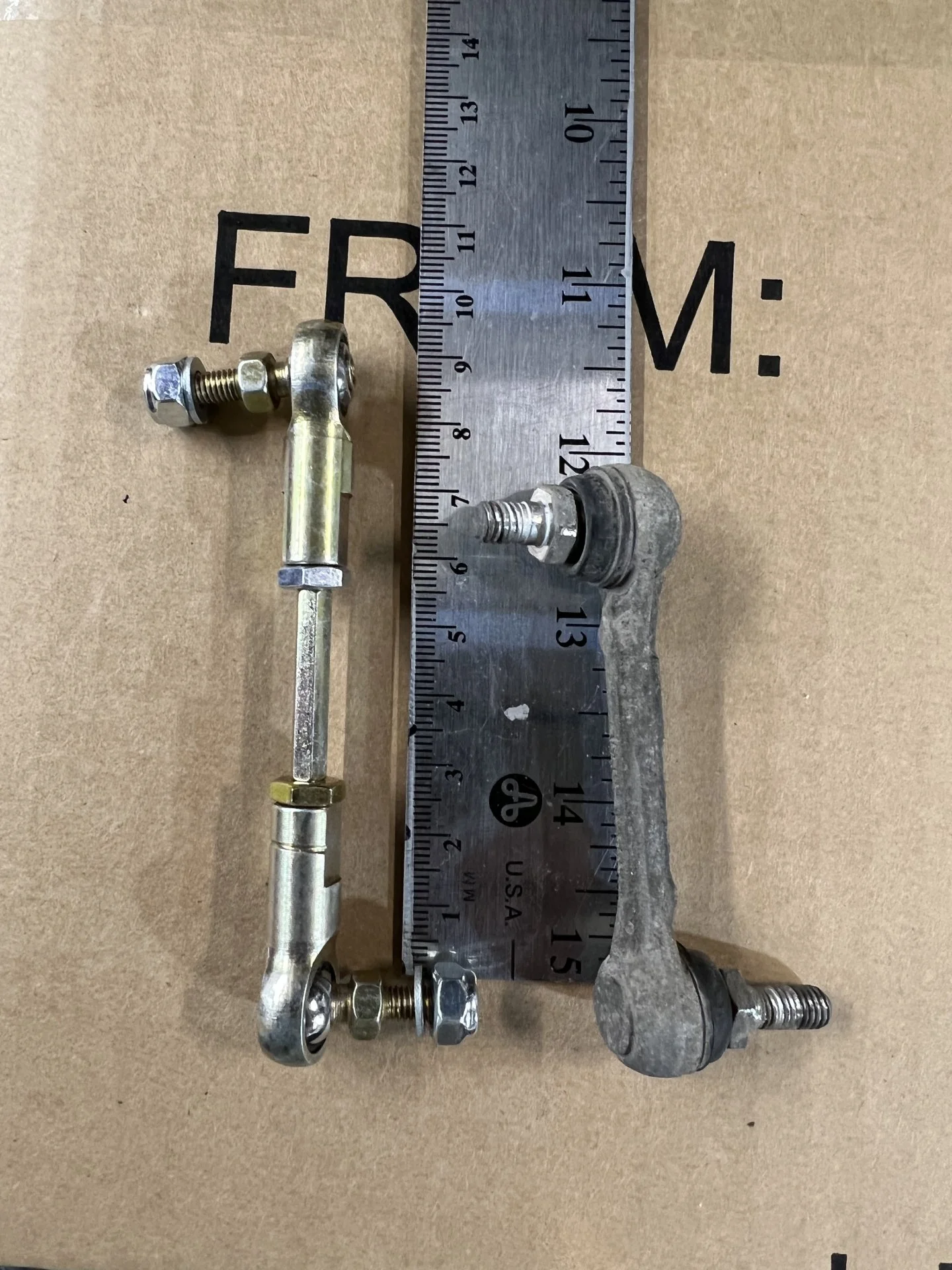

Last e-mail exchange I had with TJM they said the parts were on a container ship set to land on US soil at the end of March. I got tired of waiting and felt bad blinding everyone driving at night so I ordered the Weber Redline part that @McC13LC mentioned above. My front is sitting slightly higher than planned right now so my rod required quite a bit of extending. I have it probably 80% of the way to full extension, though once I get a bumper on the front I'll probably need to pull it off and shorten it a bit. Feels nice not being an a-hole to everyone on the road again, thanks for the part number!
Nice work 👍
