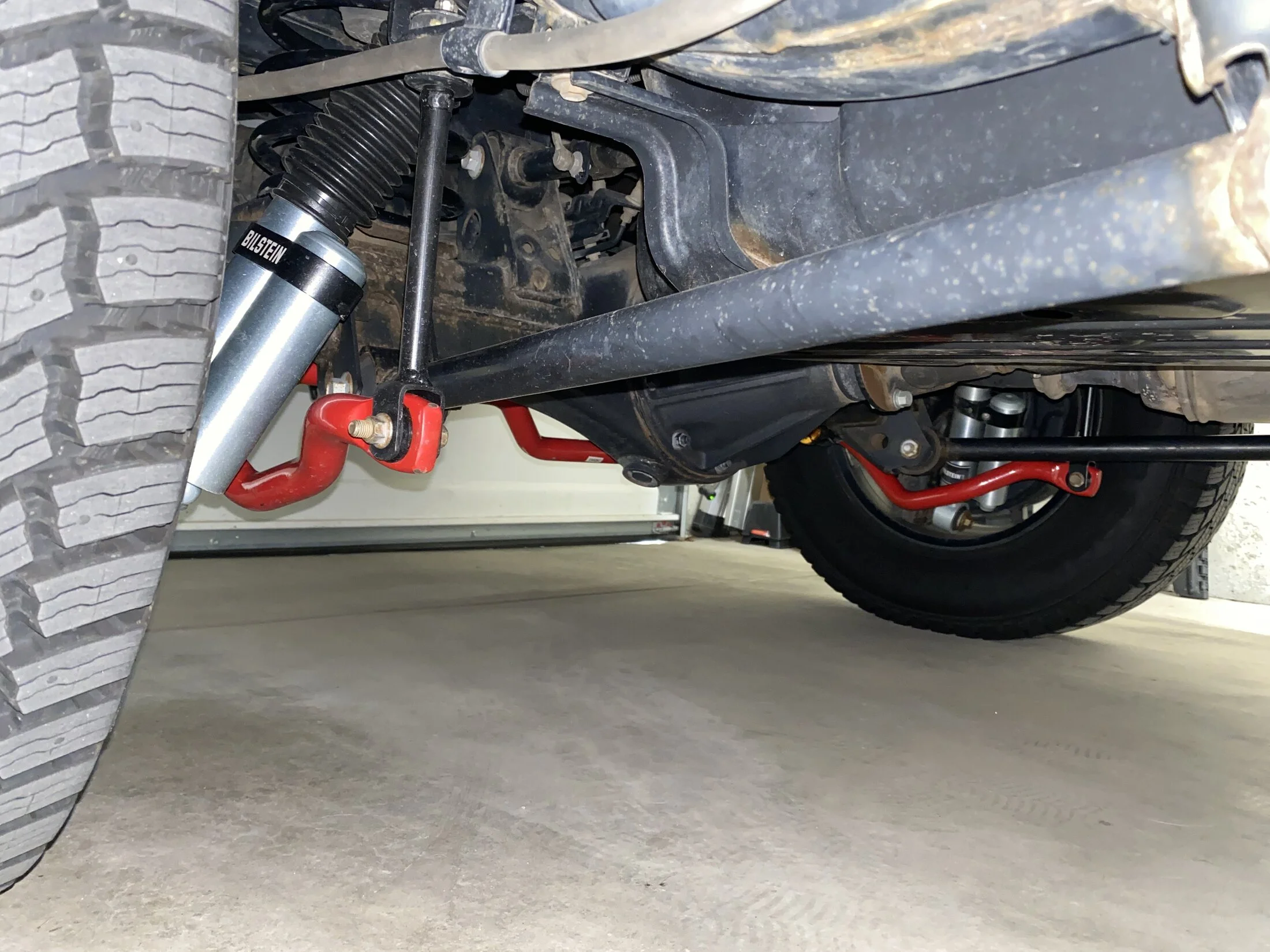

I should also specify though that I am running fairly extended end links for the rear sway bar so it clears my bilstein shock reservoirs. It's a notable bump up from the stock LX bar for sure, but likely not nearly as stiff as it would or could be with stock length links.
Whoakes the extended links
I welded up my own, but I've heard of others using the superpro extended rear links for a 100 series. Those would not have been long enough to clear in my situation but should be plenty for people not running the bilstein 5160 rear shocks. My links are a bit too long to be ideal. Still trying to work out a solution, but it does fine for now. You can just barely see where the bar contacts the reservoir in this pic (only under heavy articulation). Shocks with the reservoir in a different location don't need the extension.
