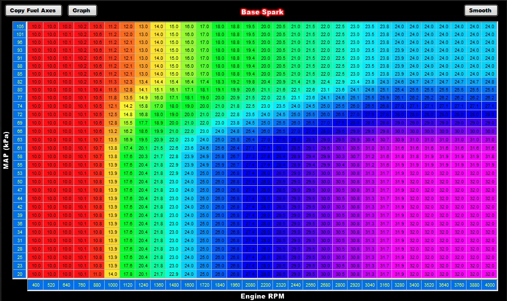

I've always been curious to gather some data and see what self-tuning leaves on the table, or what I might be leaving on the table for timing as I just mimic'd OEM dizzy curves. So...I've got a timeslot booked on the local chassis dyno for an afternoon of twiddling. Currently it runs well, especially around "normal" part throttle driving. Above that, it seems a bit "flat", so I suspect I'm either fat-rich or possibly pulling too much timing...but time will tell. Any thoughts or input ahead of time might help get the most from the session, and I'm also happy to share the config file after.

For those with the Holley/Hyperspark, I'd be curious how your maps compare. Or for those who have tuned the mechanical/vacuum-advance distributors, how much did you push the curve in the higher RPMs?

Looking forward to seeing what you find out. Interesting to see the 15.5 target afr. I have mine set to 14.5 cruise, 14 idle and 12.5 or 13 WOT.

In this case, with a Holly FI, a Dyno session should really be about tuning fuel curves throughout the pull. As many carb vs FI "debates" have pointed out the FI learning is really only a few facors with some percentage or ratio overlays. A decent tuner will be able to identify any lean or rich numbers throughout the RPM range and "tune' them out. Hopefully you get a custom tune, installed and saved to a file for when it forgets for whatever reason. You should probably have the saved "self tune" file plus an improved dyno tuner file.
I've never done it but I did fall down the rabbit hole of research regarding tuning Sniper/Terminator X systems. From a tuners perspective the auto learning is the start and could always benifit from some tweaks. Heck just being able to look at the tables on your laptop and understanding you could have 1 or 2 different tune files is huge compared to taking the "robot carburater" (Sniper) out of box and dropping on.

Definitely curious to see what we find for part throttle (main driving) vs closer to WOT (moreso for odd occasions like climbing a hill).
I do have a pretty good history of saved tunes since starting out, so this just adds to the pile.
