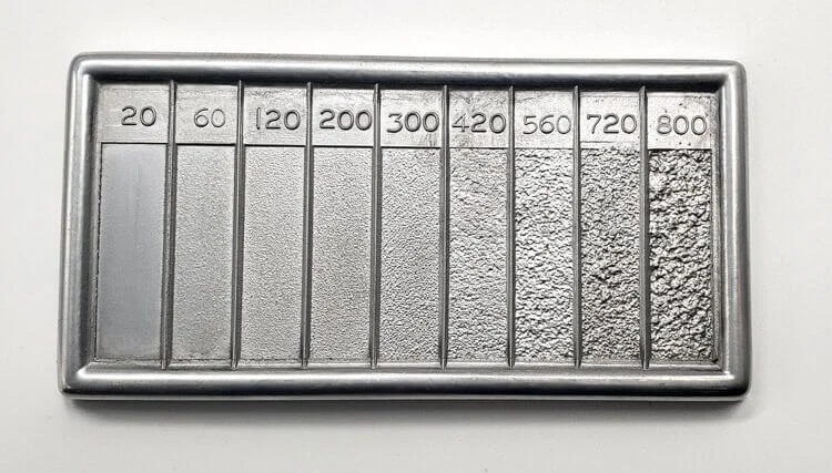

Most metal (MLS) head gaskets will require a certain Ra value (Roughness Average) for both the block and head in order to seal properly. Often times 30-40 Ra or less.
There was a crosshatch pattern to it, but i would say my block was closer to 200-300 before they manually honed it. I didn't see it afterward.
