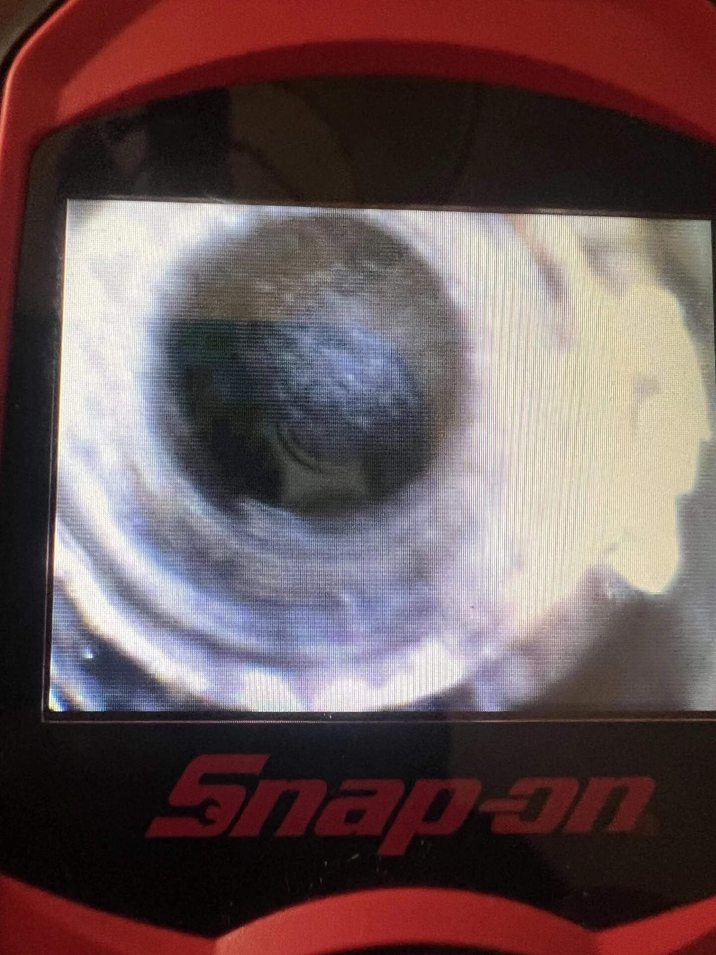

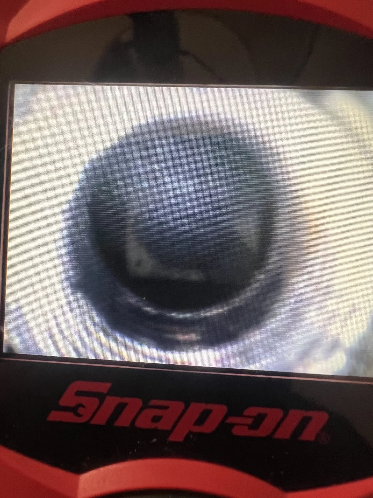

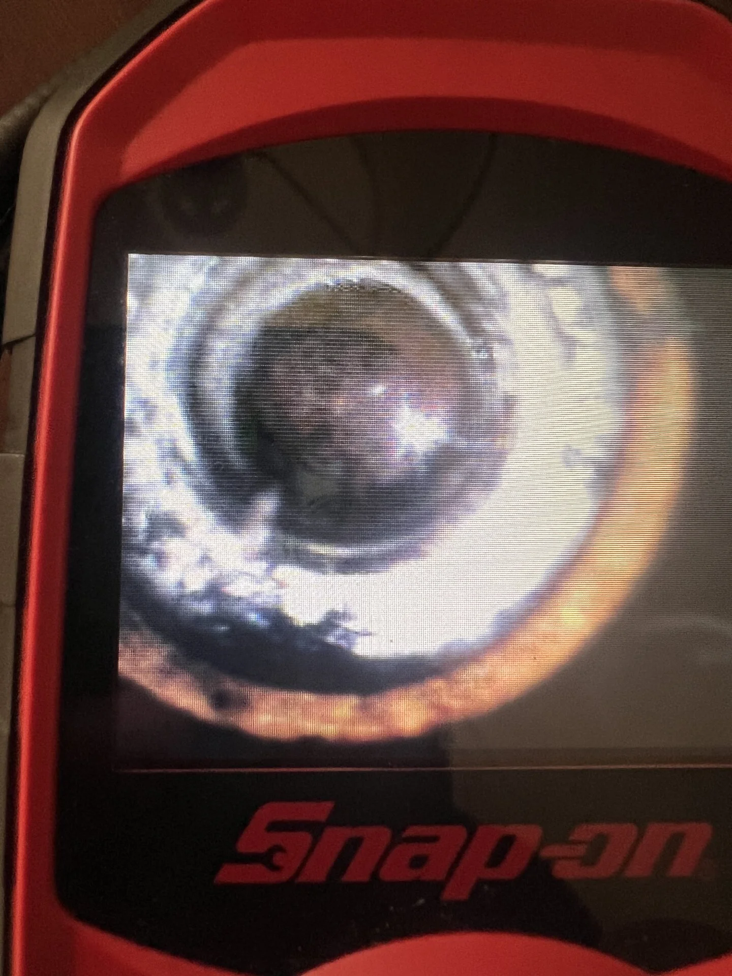

Started with a cyl 6 misfire. Then started smoking when cold but stopping after gets to operating temp. Got a borescope in and found this first is cylinder 4, then 5, then 6. Looks to be coolant sitting in 6 😅

Combustion gas leak test turned yellow didn’t get a pic though
So that's a positive test for gasses? I forget the colors.
My concern would be #5 based on compression readings.
Yeah positive gas test. The minimum pressure in the FSM is 124 but that’s what I thought just looks don’t match the readings
