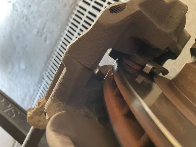

The bigger rotors appear to fit the backing plates already installed. Does this look right? 1991 HDJ81 JDM. Thanks guys!
Those are 93 through 97 rotors? I got 97 rotors and my plates were to small

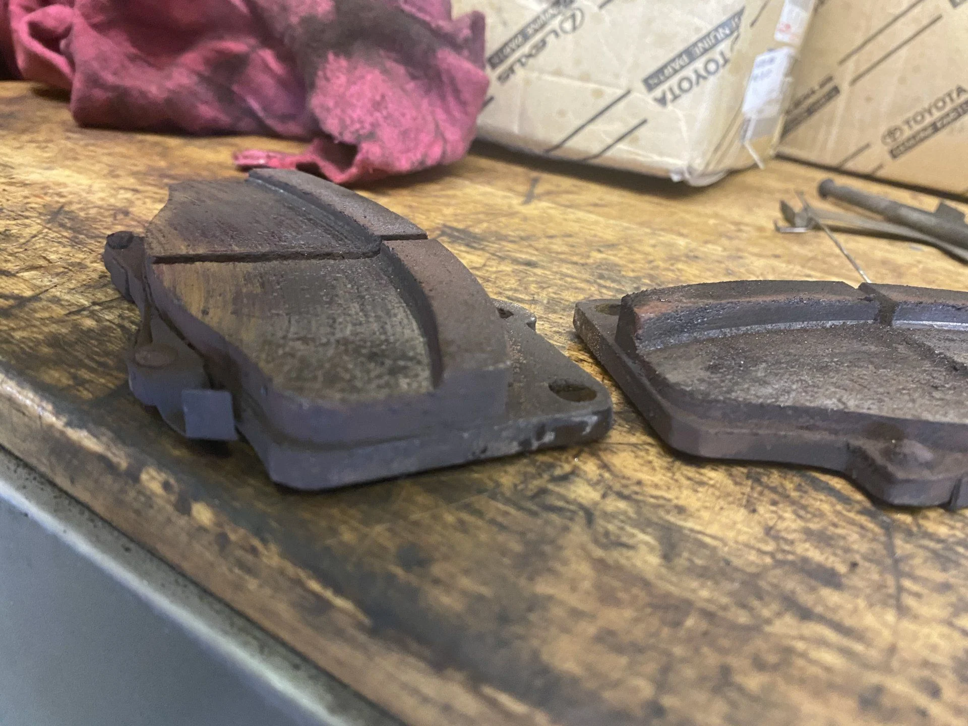

Sooo....this truck keeps surprising me. Looks like the truck had the bigger brakes, probably modded by the PO in Japan. The last shop I took it to put on small rotors and maybe the bigger pads? It’s a s*** show and caused a caliper to fail. Glad I’m starting fresh with new calipers and rotors and looks like I already have the bigger backing plates....

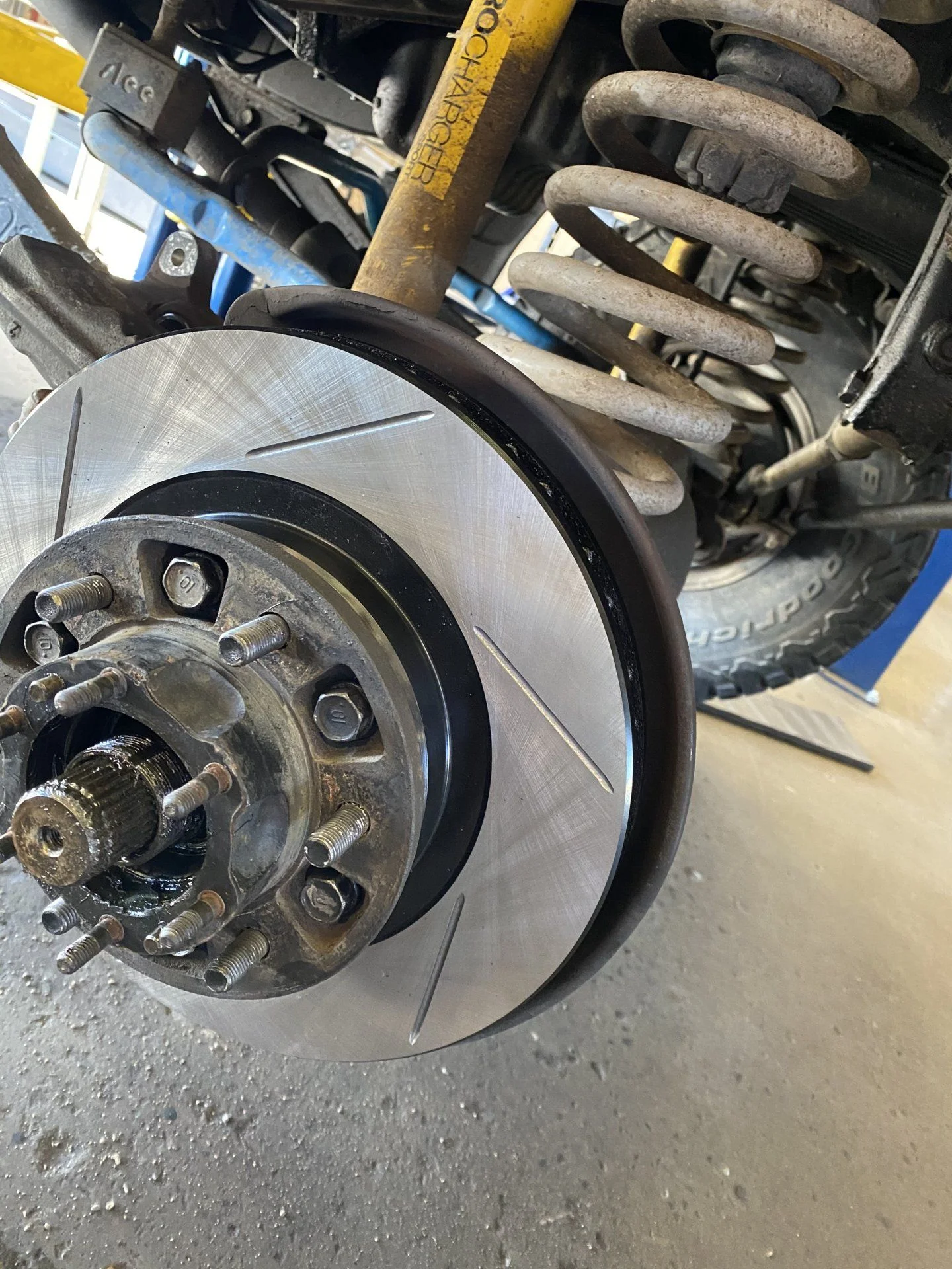

Hey @Dave 2000 , thanks for the info. Just swapped over to the bigger brakes.
Stopping is better. But pedal feel is weird. The first time I press the pedal it goes down and then afterwards it doesnt. So I'm thinking I have air in the system.
I also upgraded the outer halves of the birfields to the 30 spline and got the deeper Axle Hubs.
The shields I didnt cut but bent over to see if it would work.
I'm using with 15s but they have -20mm off set. They barely clear. 😬
I have matching spare, and wheels so not sure I want to change. So might go with spacers.
