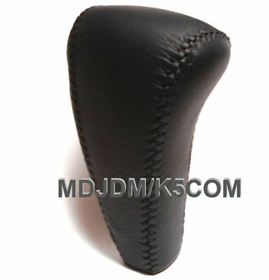

Yes, sent off a steering wheel, shifter knob, and emergency brake lever boot to Dallas Custom Steering Wheel in Texas, they did a good job, but I forget what everything cost. The steering wheel by itself was around $400 shipped, had an thin layer of fabric installed between the rubber and the new leather which cost maybe $50 more, it made the wheel a tiny bit fatter.
Italian Leather, Ostrich press imprint.
.5mm braided thread W/ baseball stich

Forgot to mention, I had a shifter knob and emergency brake handle boot all recovered in Oak colored leather, same as steering wheel.
