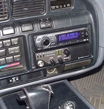

Redye. You can pick up a rattle can of black leather/vinyl dye at Autozone for $4. If the leather is messed up you can sand or even repair it if its torn before you spray.
Here is a pic after I dyed my shifters about 5 months ago (they still look the same):
