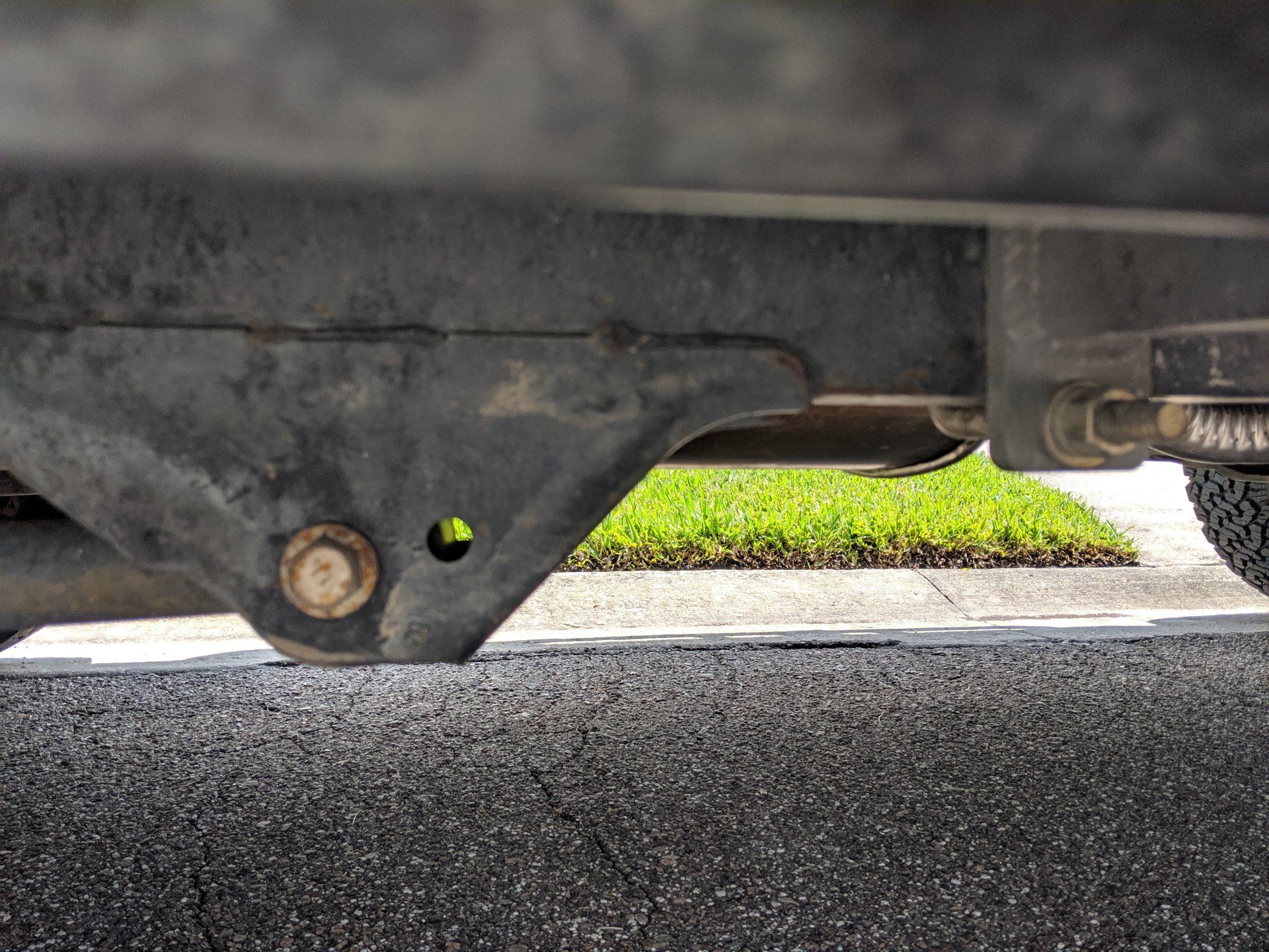

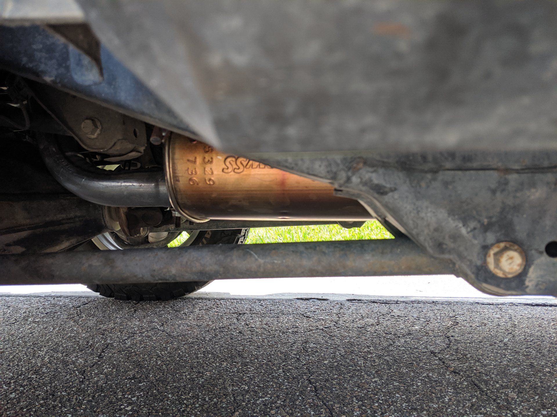

Yes, but I would say it is less than two inches.
And my travel trailer is on the hitch right now, so that pic is with the rear suspension compressed a little.
Yeah but the muffler moves with the vehicle so...
2 inches still too low
Yeah, muffler not related to axle movement. Just wanted to give a reference for the position of the LCA.
Got it. Those are gone for me anyway
