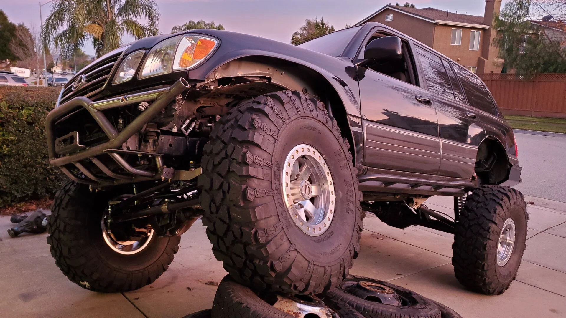

Quarter elliptical. Kinda cool actually.
That is cool. So the leaf takes the place of a coil spring or coilover in a typical 4-link it looks like? Seems like it would be a lot cheaper and easier to build with whatever you have lying around. Hard to get the ride height right I’d imagine though.
Yep correct

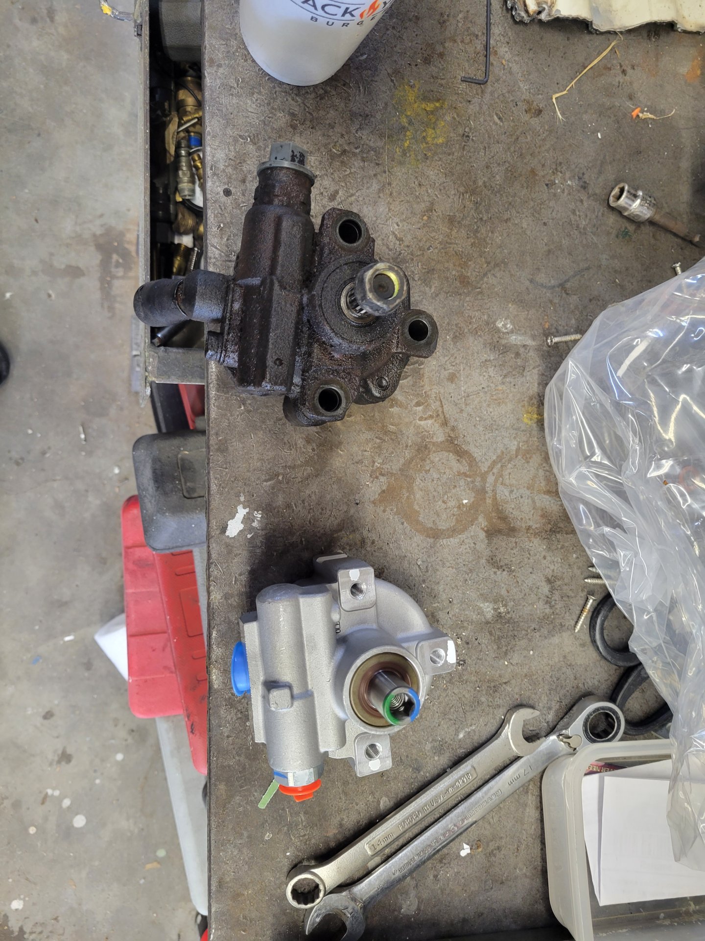

I am hoping you can clarify one little piece of info, 2018 3500HD ? Diesel? Or gas power steering pump? Picked up a 3500 6.0 gasser pump and pressure is on incorrect side. Other pieces are on the way to convert. Thank u in advance.
@nukegoat Per post
Post in thread 'Hammersaurus Lex - The LX470 gets tons' Builds - Hammersaurus Lex - The LX470 gets tons - https://forum.ih8mud.com/threads/hammersaurus-lex-the-lx470-gets-tons.1132419/post-12835676
Diesel. Pro tip - go on rock Auto and look at the pictures of the pumps for both 6.0 or 6.6 and you'd see the difference
Over anxious purchaser. Devil is in the details. Thank you.
