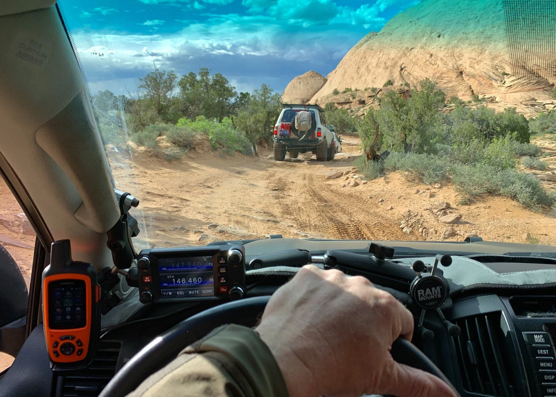

3rd Toyota to install it into....I have the 2020 HE and the problem is (always) determining where the control head will go. I have the Yaesu 400 Welcome to Yaesu.com
It's a great unit and the control head allows a dual band site picture. The actual radio itself; I have found a good location for in the rear where the factory jack is stored.

I used a passenger side proclip mount.

Short RAM Mount, too (don’t recall the model).
Ball mount for head from HUDDEXPO

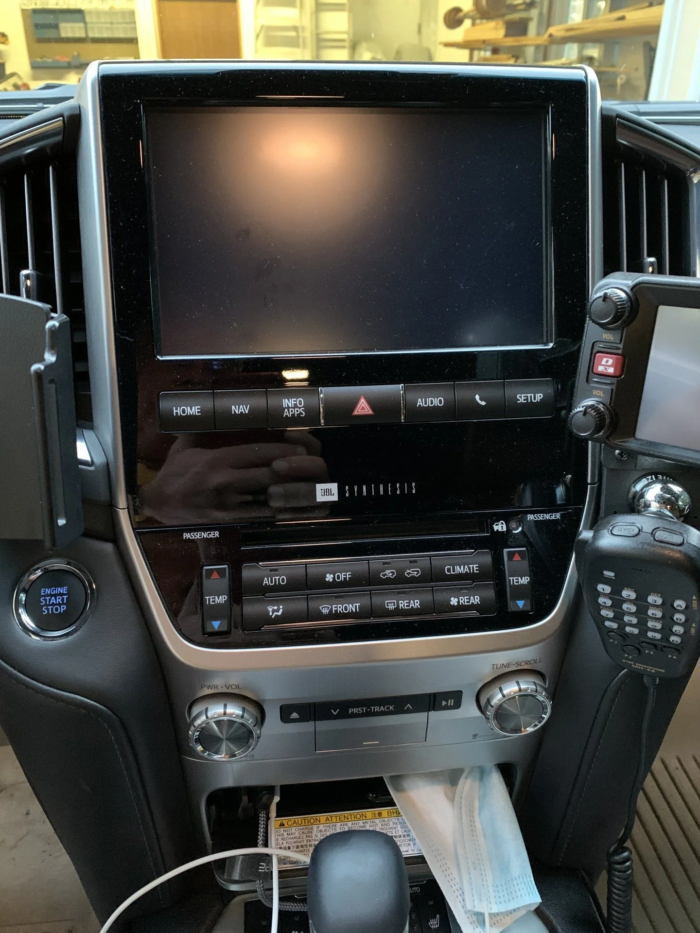

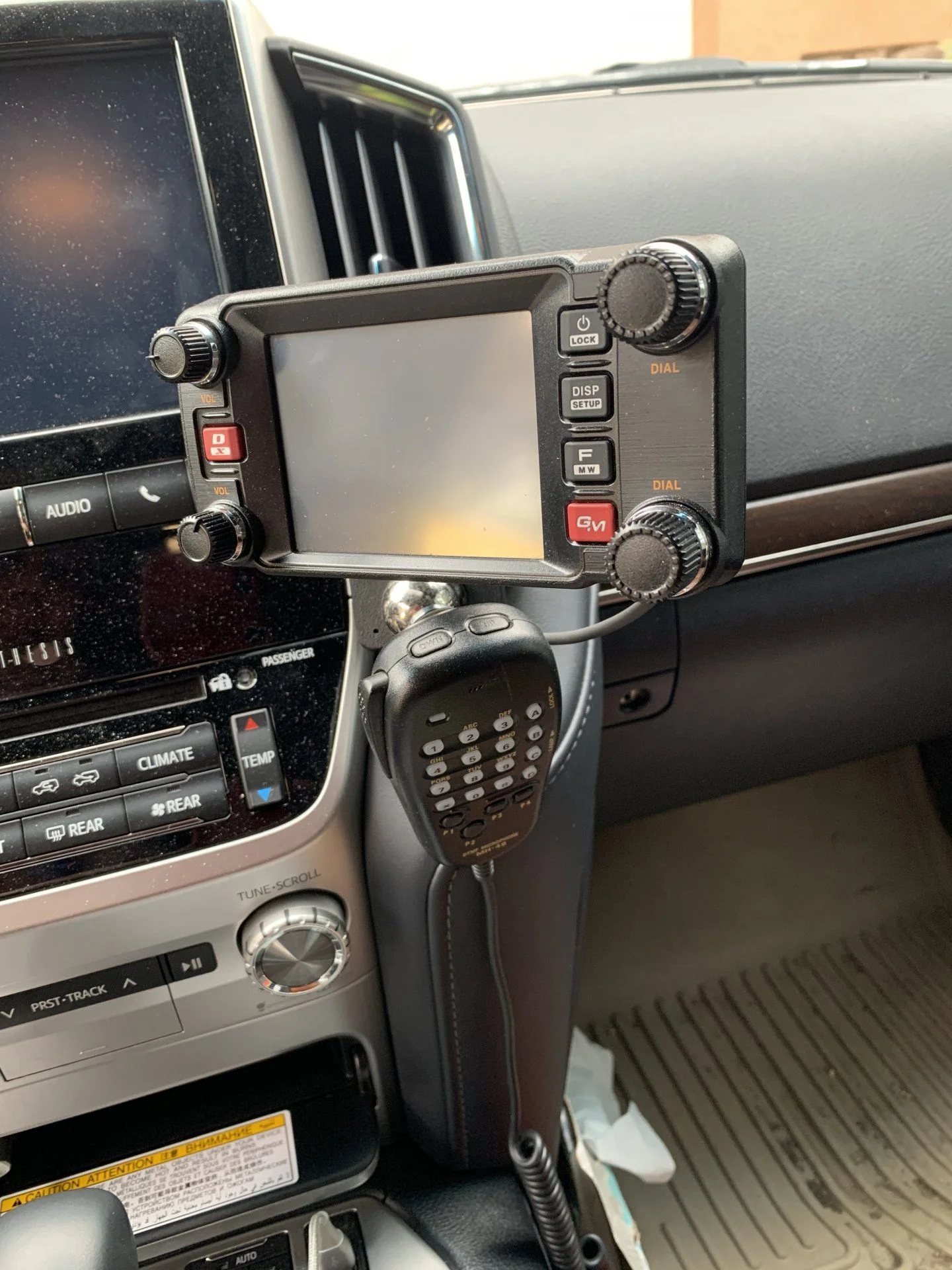

Personally, I like mounting the faceplate where it neither obstructs my view nor intrudes into passenger space.
This spot works really well (same Yaesu) and avoids both issues:
Personally, I like mounting the faceplate where is neither obstructs my view nor intrudes into passenger space.
This spot works really well and avoids both issues:
How is this connected to your A pillar? The rest of the mounting is the 1 inch ball ram mount stuff, correct?
