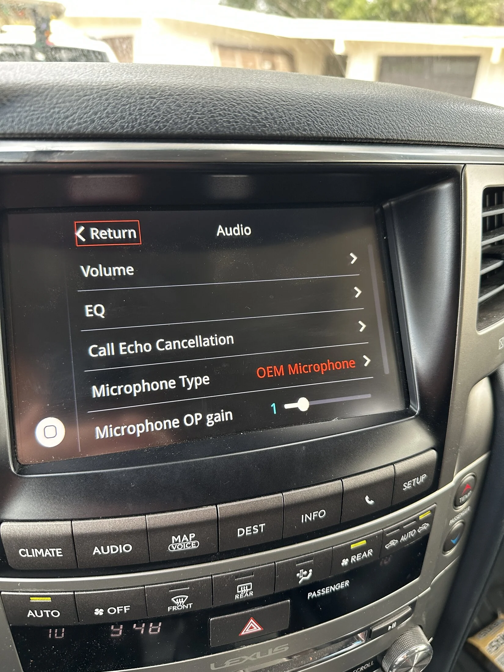

Sounds like the factory system has built-in filtering to remove whatever is causing the echo and when the OE mic is piped directly to the Hamilton that attenuation layer is missing. That's why I'm wondering if you have the Hamilton use it's discrete microphone that it might remedy the quality issue.

I think you're spot on
Digging through the underlying OS of the unit I did find an audio section and there seems to be a "Call Echo Cancellation" section
I was able to get the CarPlay working again...after a bunch of resets I rebooted my phone and that seemed to get the CarPlay back on track
Looking over the Hamilton site there's no manuals for the underlying "Car Home" system, so I don't really know what all the settings are
I guess it'll be trial and error

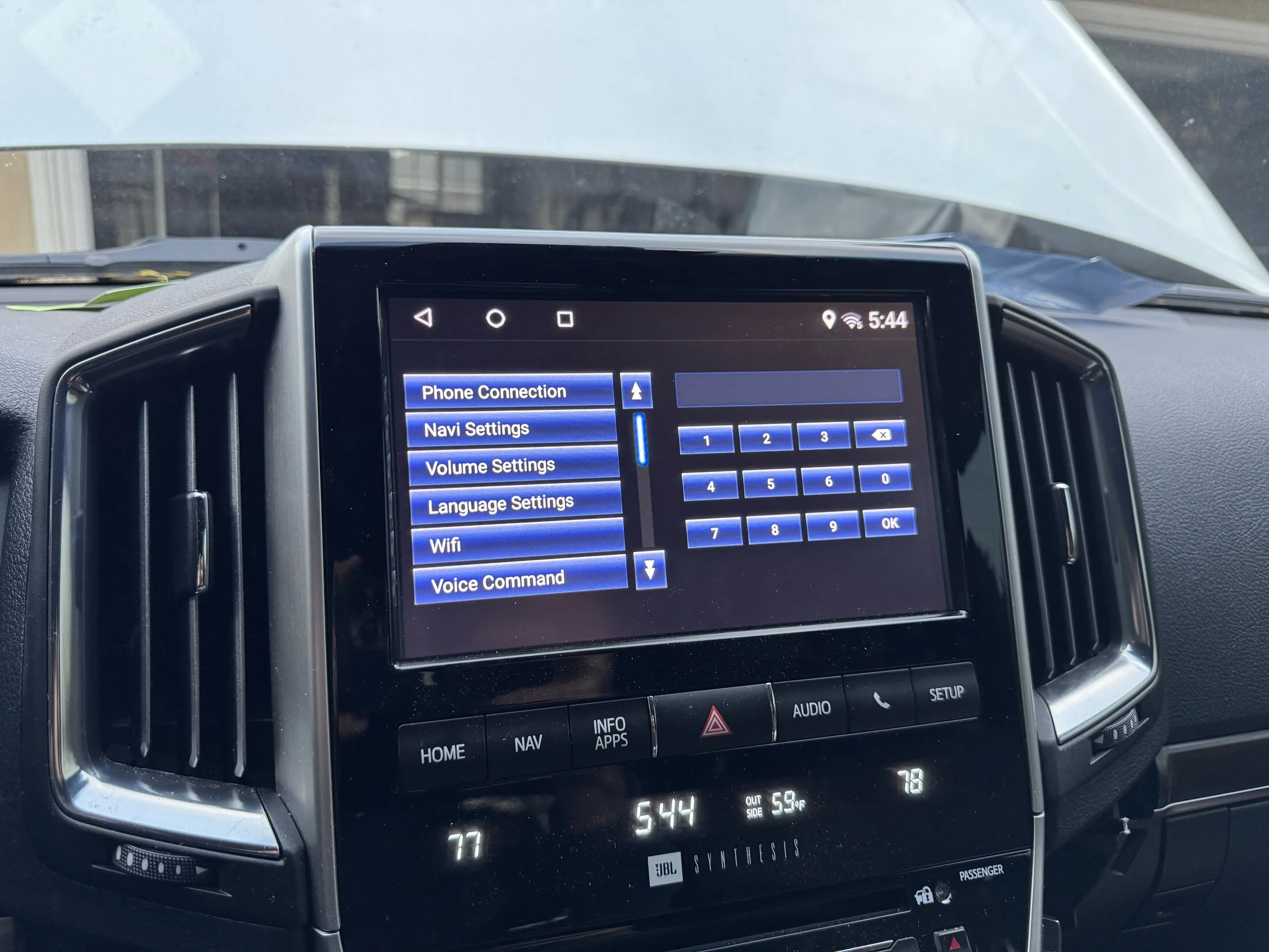

I just installed mine but it looks like they gave me a different box with a different ui. Everything seems to work great but I'm also running into the echo problem where people on the other side will hear themselves.
Anyone else figure out a solution for the other interface? Here's what mine looks like and I don't see a "echo cancellation"
Support got back to me and we got to a quick solution.
Instead of using the Hamilton unit Bluetooth connection, we used the oem Bluetooth. Everything else works great after that. If you have this unit and are having trouble, here's how to fix:
The noise cancellation on my unit was under Settings > Audio
It seems like you have two settings to choose from.
I wish they would provide the link to the OEM manual or something that digs into these settings.

It seems as if your unit has a different UI\OS I'm guessing because you have an updated 200 series (2016+)
They provided me the same "fix" and even though it was better, it wasn't better than the original connection.
Running the noise cancelation did fix it for me though or at least got it to 99%.
