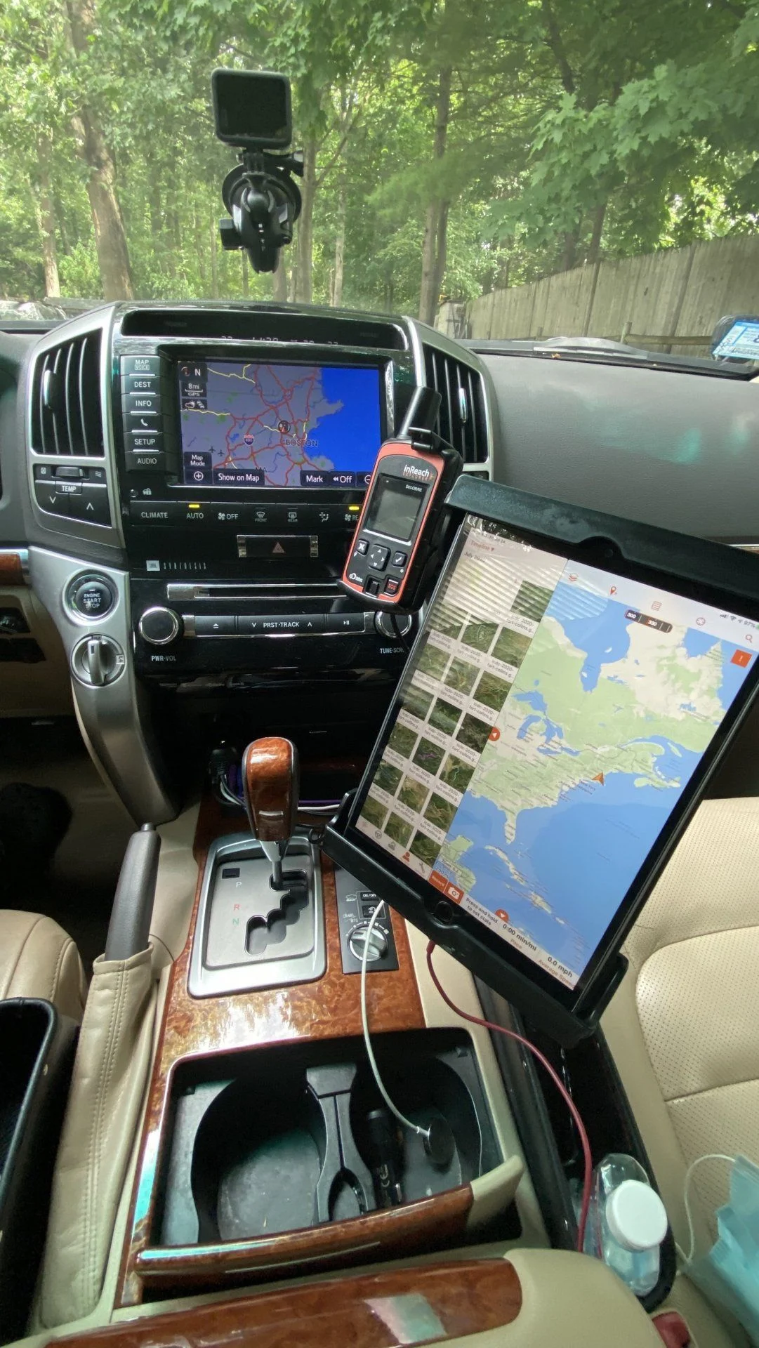

What are some mounting solutions for a 2013 Land Cruiser to be able to mount my iPhone, Mini iPad (offline maps) and InReach (GPS/ SOS)? Do you mount them all side-by-side? Different mounting spots? Thx!
I use a combo of the X-Naut, some ram mounts and a delorme cradle. I’m likely going to switch to an inReach mini soon.

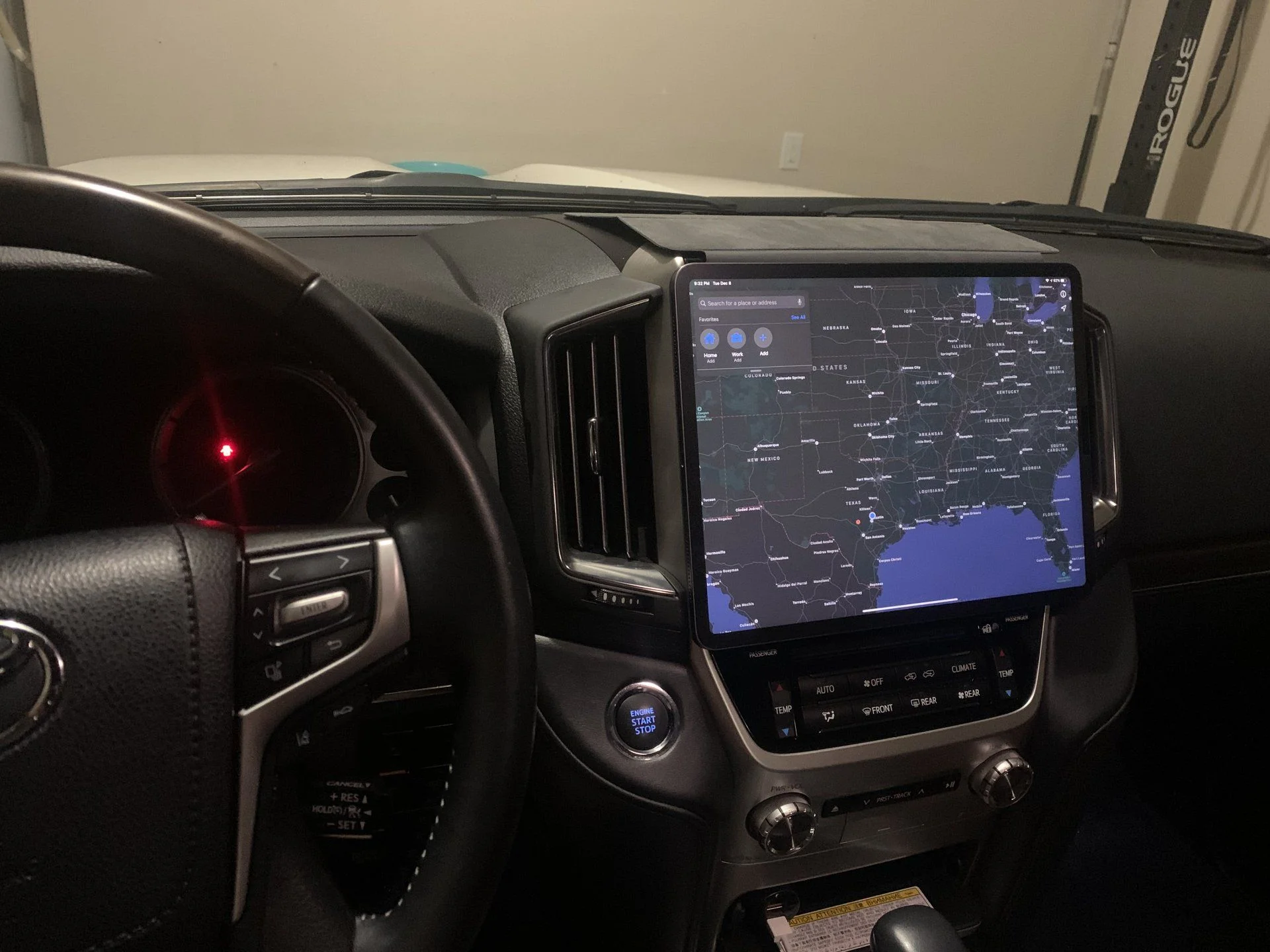

I have been unsing an iPad Pro with the smart case which easily attaches magnetically to the speaker grill. I bought a magnetic lightning adapter and routed a cable for power...

So you don't need to access the original nav?
I flip the iPad over when I need to see the backup cam or adjust AC, the magnetic cable reattaches automatically...
mart Cover for iPad (7th generation) and iPad Air (3rd generation) - Black
Ha! I have this case, but never tried sticking it onto the speaker grill like that. Thanks!
So simple and genius! I was struggling with how to do a nifty iPad mount. Looks like you’re on LTE which makes sense. Basically like you have CarPlay?! So the Smart Cover magnet is strong enough to prevent the iPad from moving or sliding?

And yes the magnets on the smart case are good enough especially because the OEM screen in on an incline so the ipad rests right on it

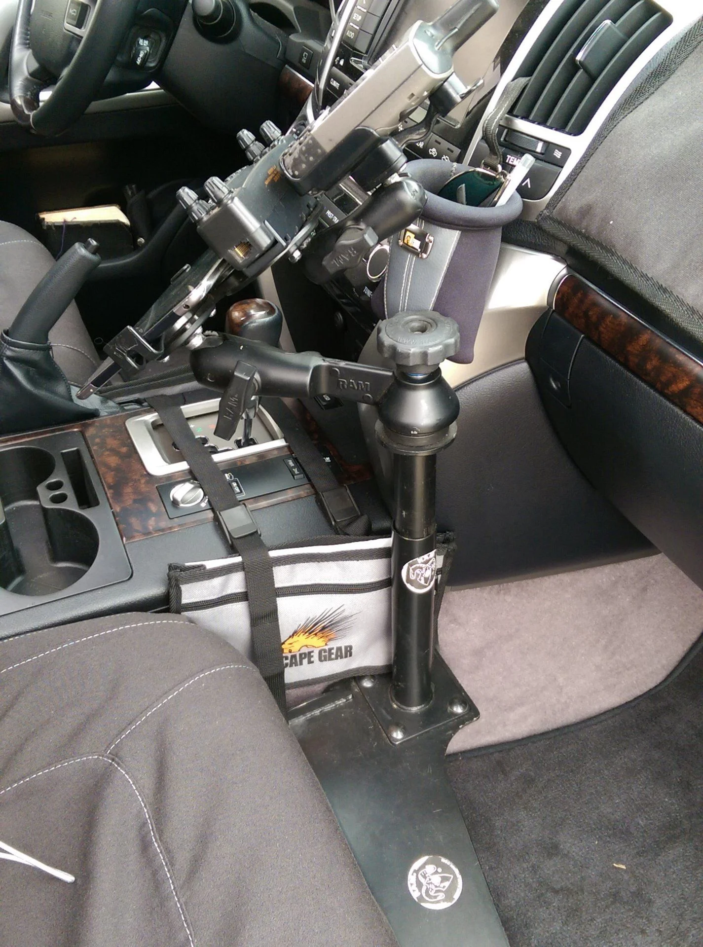

Is that the ram mount that wedges next to the seat?
Nope. This is the flex arm type which mount on the passenger seat mounting bolt. It will wobble a bit, not as steady as @sdnative ram mount solution.

Ah. Yeah, stability is near the top of my list of priorities. I hate the idea of large accessories like that moving around a bunch with every bump.
Paging @Markuson for his setup which is quite slick.

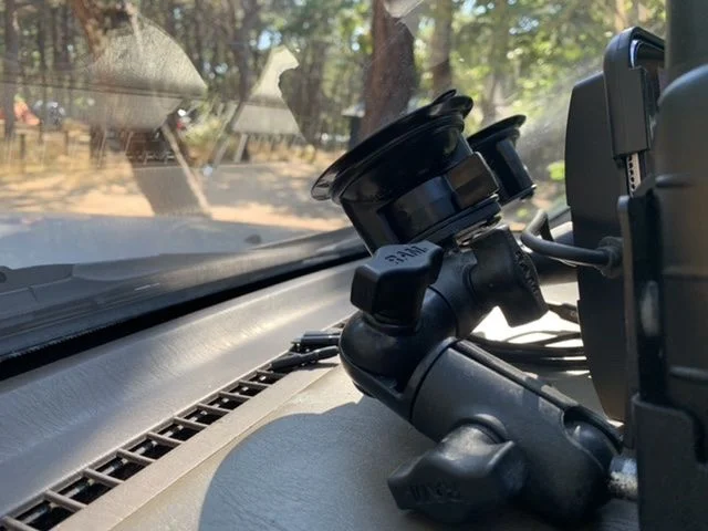

Here’s how I mount several items, all without sticking on or drilling into anything. You could substitute my HAM control screen with a phone or other item, etc. All RAM mount balls.
Utilizes bolt threads on handle:
Best part is it doesn’t obstruct driver view...and can be mounted or removed while in or out of the vehicle.
Also puts each item within finger reach while still holding onto/stabilized by steering wheel. On bumpy trails, this can help a ton for quick adjustments.
